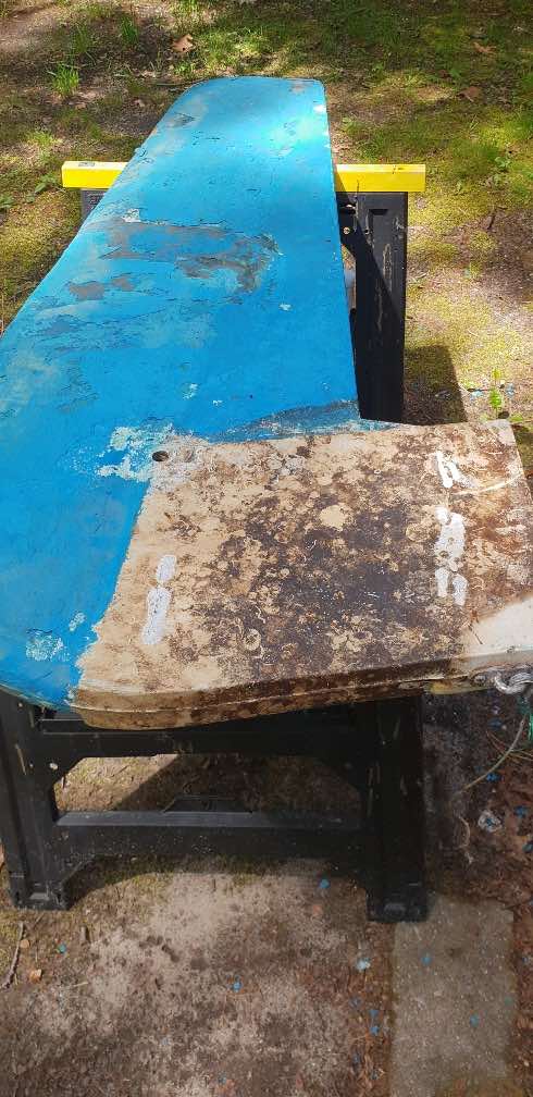

Should I coat my recessed swing keel trunk areas with 3M 5200 or similar to make it easier to clean the barnacles? I recently had to drop my swing keel because it had a barnacle problem, and ultimately, the uphaul cable broke. Anyway, the recessed area in the keel trunk area, it doesn't get bottom paint and the barnacles build up. I noticed while cleaning the barnacles, that where some 3M 5200 had inadvertently gotten onto the keel, the barnacles came off very easily with the pressure washer. (See photo.) So I am wondering, should I just coat this whole area with 5200 so i can just clean it out nicely each fall by sticking a pressure hose up there? And is there something like a liquid texture paint-on 5200 that might be better for this?

Since you already have the keel out, you have great access to lay a couple good layers of bottom paint on the keel and keel trunk.

First some information. 3 M 5200 is a permanent adhesive which is not considered to deter barnacles. To put it on a clean surface will interfere with the movement of the swing keel. Secondly, anti fouling paint is designed to deter barnacles but it has to be fresh as the type of paint we do not know nor the history of the boat as the last hunter 22 was built in 1984 (excluding the different newer 22 which replaced the 216 and is a different boat. Your swing keel was made by Mars Metal and is cast iron. Further most anti fouling paints or anti fouling properties will no longer work if allowed to be out of the water greater than 60 days.
It sounds a repair was made using 5200 sealant excessively without allowing it to cure which takes 7 days unless it was a newer kind that drys faster with the keel being reinstalled with uncurred sealant. The keel was painted installed which is why the top of the keel being unpainted. It sounds also the anti fouling properties had dried out being out of the water for over 60 days.
Generally, the keel housing or area where the swing keel is in when in the up position is generally above the water line We don’t have a photo of that housing. Therefore it generally is never painted. As a former dealer I use to paint the upper 4 inches inside that housing to prevent barnacles from growing inside the housing
While the keel is out, I suggest removing the old paint to bare metal unless barrier coats are in place. Any voids, go to bare metal and paint first with a metal primer containing zinc chromate and fill voids with epoxy two part sanding smooth. Apply barrier coats. Apply anti fouling paint. There are a couple of softer anti fouling paints that will retain their anti fouling properties if out of the water for any length of time. Then repair cable and reattach swing keel.
One other thing I note a line on the upper top of keel of bottom paint in the housing unaffected. Not sure of that

As Crazy Dave advised, the upper area of the centerboard trunk is unpainted. I found out the hard way while replacing my CB uphaul line. While I had the CB bracket removed, I thought it would be a good time to repaint my CB trunk with ablative bottom paint. In this process, I even painted the upper, previously unpainted area. Then, I painted 4 coats on the painted areas of the trunk. When I was ready to reinstall the CB bracket, it would no longer fit into the trunk because of the already tight clearance. It even jammed at the area previously painted. I had to sand off all of the paint in the areas where the CB bracket was mounted, and about half of the paint in the 3 to six inches below that.
So, from my experience, I would advise against putting anything that is more than the thickness of a couple of coats of bottom paint below the CB bracket. Also, 3M 5200 is the devil’s glue! It could possibly even pull gel coat off if it ever needs to be removed after application. Use only products designed to control barnacle growth!

I have the same boat. I very much agree with "BrianW"...stay away from the "devil's glue" (3M 5200), as he states, and only a couple of mils ablative coating is needed to typically protect your hull. (I sail in Long Island Sound...)
Also, is your swing keel really as Crazy Dave states ("...Your swing keel was made by Mars Metal and is cast iron.") ?
I have the same year as you do (H22, 1981). My swing keel (as bought and as replaced) is fiberglassed foam and only weighs in at about 80 lbs... Whiskey Tango??

Crazy Dave says.. "...a line on the upper top of keel of bottom paint in the housing unaffected. Not sure of that." Well that is your up-down haul cable connection / eye to trunk / housing pulleys.

Also the reference to the line on the upper portion of the keel in the paint, I was looking below it I could tell where that portion of the keel was in the water with it possibly kept up all the way in the trunk housing with the up haul cable while in a slip. Not good.
When in a slip keep the swing keel in the down position making sure the cable is relaxed as well as sailing. In addition when trailering, keep the keel lowered on the keel tray. Other than age, I saw the above as to two major reasons for cable failure.

Thanks, guys. The keel is foam, about 80 pounds, I can carry it. "the line" I think Dave is referring to, is the area where the 5200 was accidentally smeared last time I did the cable, that is why I was wondering why not 5200 the whole surface. (There's actually two lines, one about parallel to the pivot hole, one parallel to the bottom of the cable attachment. But yeah, fine, I will use ablative paint now that someone mentioned shoving a rag up there with a ruler or whatever, yes, it can work. The problem is my yard is not doing that for me... I am a little pissed. (SeaTR let's go PM on that, you probably know them.) So I guess, need to do that myself every spring. Also, if there's different grades of cable, please clue me in on specs, and where to buy, Lighthouse Marine in Aquabogue? West Marine, Riverhead? Also, yes, I always keep my keel up in the slip. No one ever told me to store it in the down position. Sorry. Now I know....
