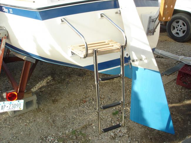

I was surfing ebay during the winter and purchased a teak swim platform with a ss collapsible three rung ladder for cheap. I have always wanted to add a swim ladder to my Oday 22. After installing two 5" inspection ports in the cockpit portion of the transom, I was able to through bolt my modified platform with ease. I used Azak (similar to star board) to shape the off set contour washers and mounted with boatlife for a leak proof installation. I can now say good bye to my corroded aluminum gunwale ladder.
