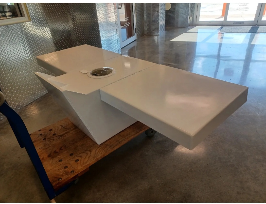

Has anyone ever seen or heard of a swim platform with an outboard mounted to it? I know its common on powerboats and was wondering if it's possible for sailboats? I want to put a swim platform/ladder on and feel like it would maximize space to have the outboard mounted to that rather than to a standard outboard bracket. (Example pictured below). Boat is an albin 82MS. Very flat stern all the way down to the water line.

You would need a way to lift your OB. Otherwise, I'd worry that your OB would get swamped on a regular basis.

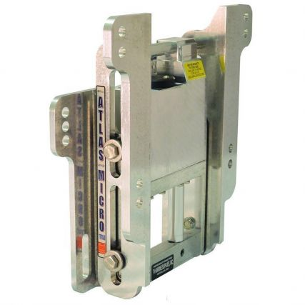

What if you got a more traditional swim platform and installed a hydrolic motor mount that raised and lowered vertically... and made a cut away in your platform for the OB lower unit....something like this...

The transom of the sailboat was not designed to support the weight of a swim platform and an out suspended from the platform. To make this work, it would necessary to significantly increase the strength of the transom and tie the transom into the hull structure with some knees.
Once this is done the new transom, swim platform, and out board will have added hundreds of pounds of weight the boat wasn't designed to support. And then you have the already noted issues with the outboard being a place that is hard reach and control as well as the issues of flooding from a following sea.

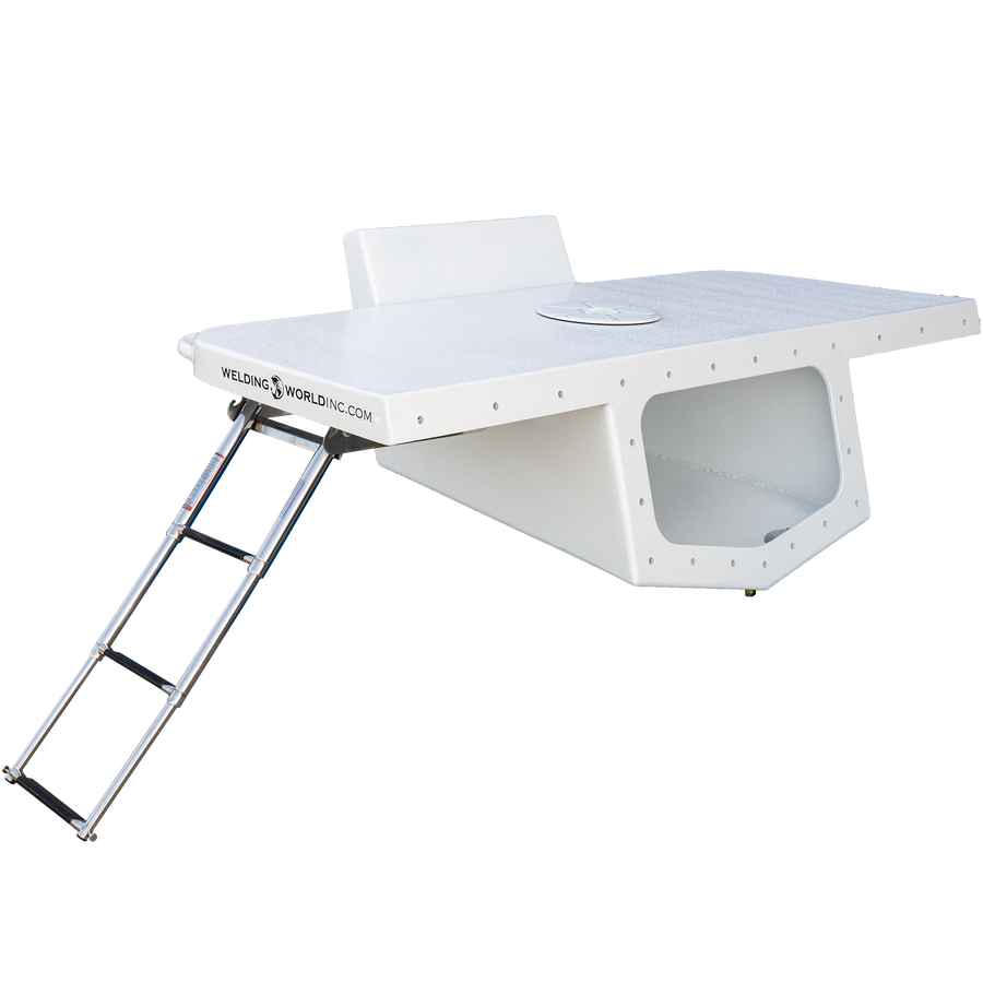

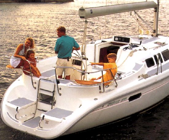

I'm not even understanding how that thing is mounted or the orientation. It seems that the ladder is coming off the side? Is the face with the holes the face that gets mounted to the transom? It's a weird assembly in my eyes.
8,099
I think the side with all the holes is mounted to the transom. There is an access hole so I guess one could get at the fasteners. The side with the upward riser is where the outboard clamps onto. The ladder is lateral or athwartship, sort of speak. I think. Not entirely certain. That swim ladder must articulate, or slide into the mounts because you can't sail with it dangling - ask how I know.
The example photo would seem to be for slapping onto the transom of the typical flat-transomed powerboat, perhaps one with inboard engines. A trolling motor might be able to be clamped onto the upright section at the aft end. If there's a motor there, mounting a ladder to the side might be a smart move.

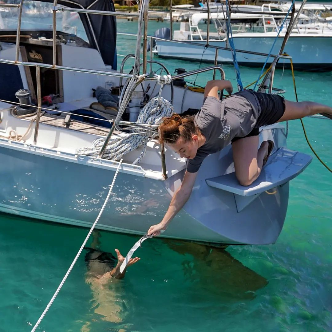

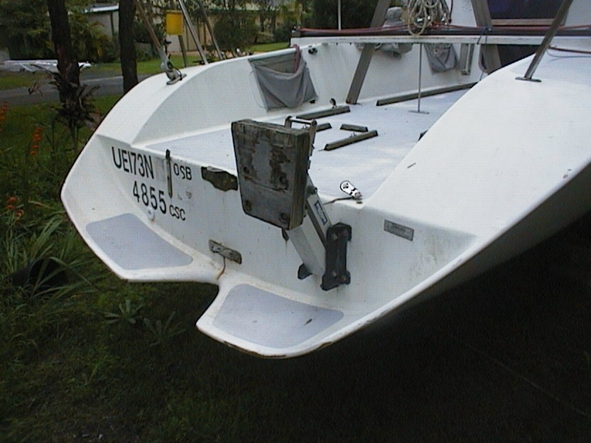

Here is one person's attempt.
Jan 25, 2007
369
Cal Cal 33-2 cape cod
I'm conflicted about the refit.
1) I like swim platforms, I wish I had one., like the sugar scoops of a few years ago & now many newer designed dual helmed sailboats have them. They make life easy for boarding/dinghy's/swimming. However....
2) The boat wasn't designed to have one. The platform will stick out, isn't integrated like a modern boat where it disappears while sailing. I'm not sure about mounting anything on them. I've read Mary Shelly's book.
3) Good luck. Tough decision. Make sure to post photos if you install one.
*** The first photo shows what looks like a stable platform, next photos are the homemade version from sailing GBU channel...it supports her full weight, not sure how much she weighs,..so I included 2 photos. The last photo is the fully integrated platform on Bene 34.1....hope this helps.

i appreciate everyone's input. i would love to have a sugar scoop but alas she came without one. So the main reason i wanted a platform similar to my first post is it would be a good place to board (boat is center cockpit with high freeboard), gives me a nice attachment point for my 9hp electric motor (epropulsion), the hollow box at the bottom of the platform is a flotation box which will help offset the weight of the platform and motor slightly (you can also get the platform without this for less weight) and will help lift the stern in a following sea with the extra flotation (although very slightly im sure). I am aware i will need to beef up the transom and the surrounding areas.
As for being able to get the motor out of the water the motor itself has a tilting mechanism that can get it out of the water. Or i can also take it off and place it on a bracket i have up on the railing if i really need it off the platform altogether. It's not to heavy and can quickly be removed and moved.... especially with a platform ;). However, i will probably keep it in the water if i am traveling as the spinning prop will recharge the battery. Im not to worried about the extra drag and reduced speed as im in no rush.

Regeneration is the holy grail of electric power for sailboats. So far success has been elusive even for the major players. The only company that has had some modicum of success is Oceanvolt, however those are not outboard engines. Even Oceanvolt systems have limited efficiency, it is not until the boat is sailing at better than 5 knots that any reasonable amount of power can be generated. An outboard won't generate much power at all, certainly not enough to offset the huge loss of sailing efficiency.
I understand the desire to have easier access from the water and from a dinghy. There are simpler and cheaper solutions. Something like this one from Garlick would work along with a standard OB bracket. Much less weight, fewer issues with reinforcing the transom, and no issues with following seas. Take the extra money and invest in more and more efficient solar to recharge the OB.

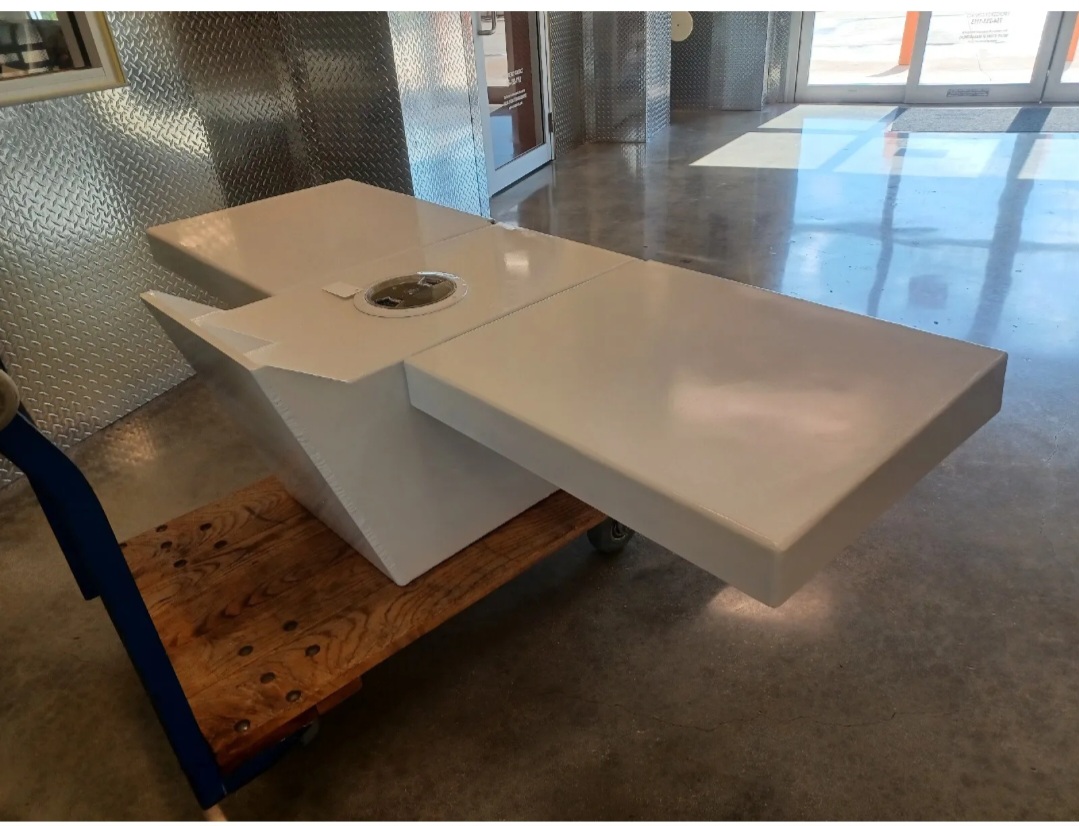

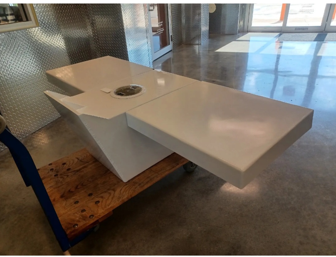

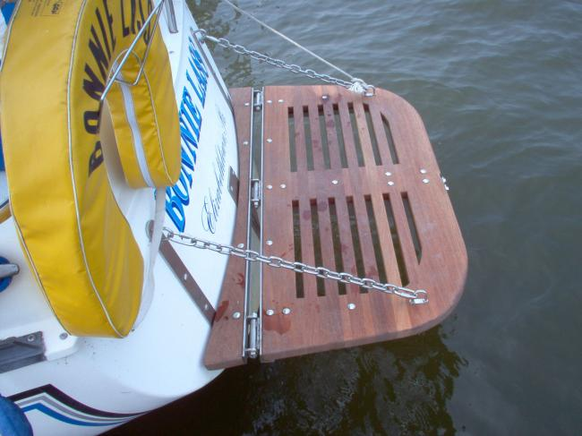

Okay last post about this swim platform question. I've found a platform with detachable sides (pictured below). This would negate the following sea argument? Just pop them off when you knows large seas are coming. Still have the added weight though.
I'm just thinking out loud here and definitely appreciate everyone's inputs.
If you want a big swim platform on a boat that wasn't designed for it and a small electric OB to propel it, it is your boat and your money. However, the consensus opinion here, among people that have a lot of experience with boats, including an engineer or two, and some who are well respected in the marine recreation industry, is this is a bad idea.
Have you ever been in the ocean sailing in 3-4 foot seas? Just popping them off will not be an easy task. The wings or you will be in the drink.
The Albin 82MS was designed with a 35 hp Volvo diesel and has a dry weight of about 7.5K lbs. a small electric outboard is not going to move that boat very well, a larger one will add to the weight issue and require a rather large battery bank. Not to mention substantial costs.
If you continue with this plan, I'm afraid another marina will be stuck with another abandoned boat no one wants.
