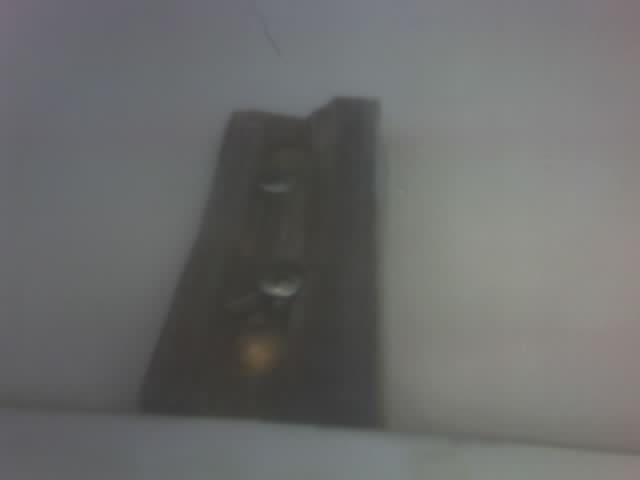

We have a 1985 Hunter 25.5. One of the swim ladder's mounting blocks is broken. It appears that the bolt heads were embedded in wood, and then the two halves of the block were compressed together. Any ideas on how we can either fix this, or replace it? The kids are getting bigger, and it's getting harder and harder to pull them up :).

Hi Robert, Thsi has happened to me on my H23; a block broke on my swim ladder. My solution was to remove the old ladder entirely and replace it with a new ladder from West Marine. They have several offerings and one should fit your H25.5. The ladder will cost between $100.00 and $150.00. You'll have to remove all the bolts/screws, fill in the old holes with either epoxy or Marine-tex, drill new holes and mount. If there is no backing board (i.e. marine plywood on the interior of the transom where the ladder was/is mounted) then I would strongly suggest glassing in a 1/2 - 3/4" thick backing board. Good luck! /Chuck S/V Windsongs '85 H23
