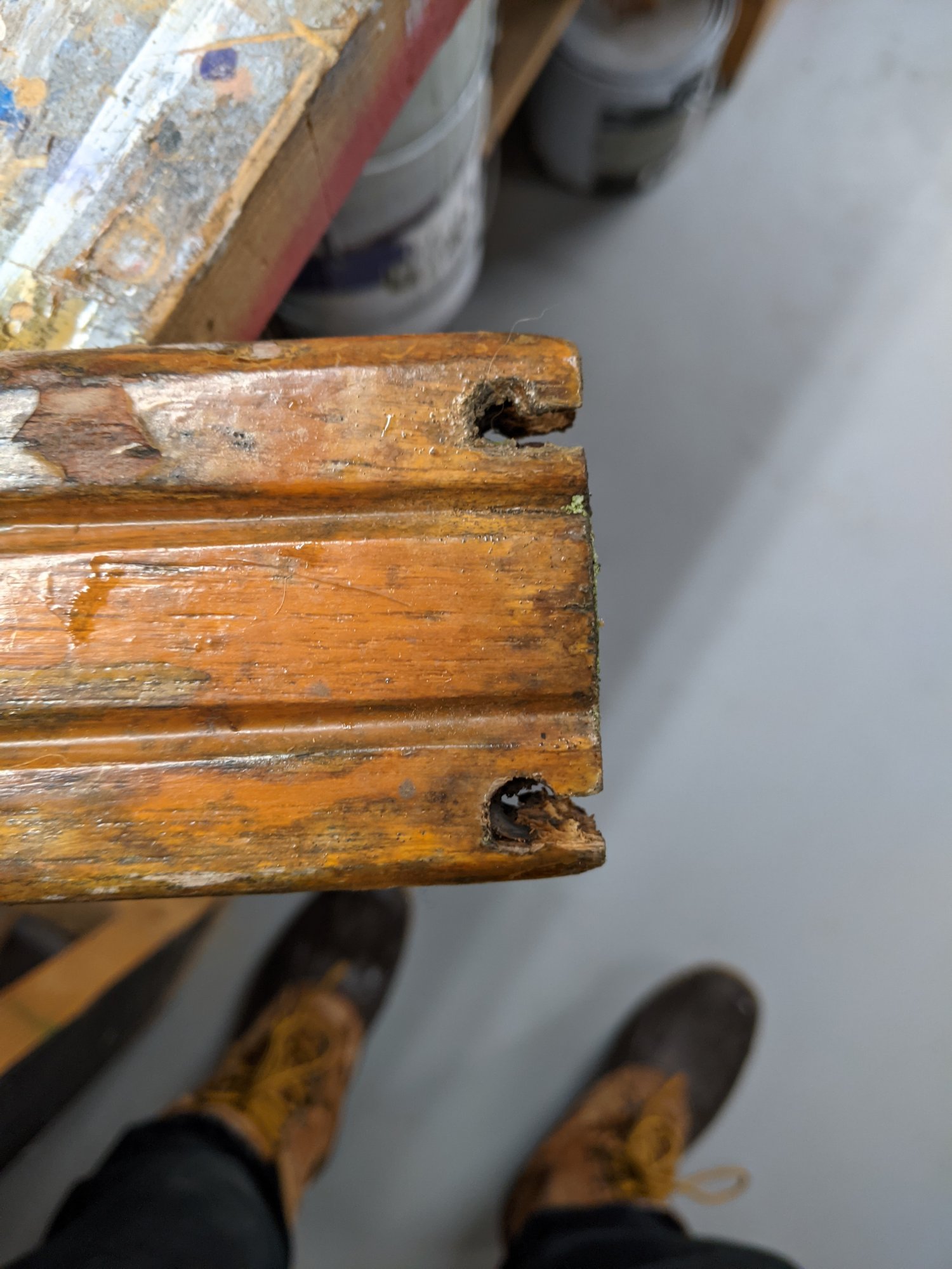

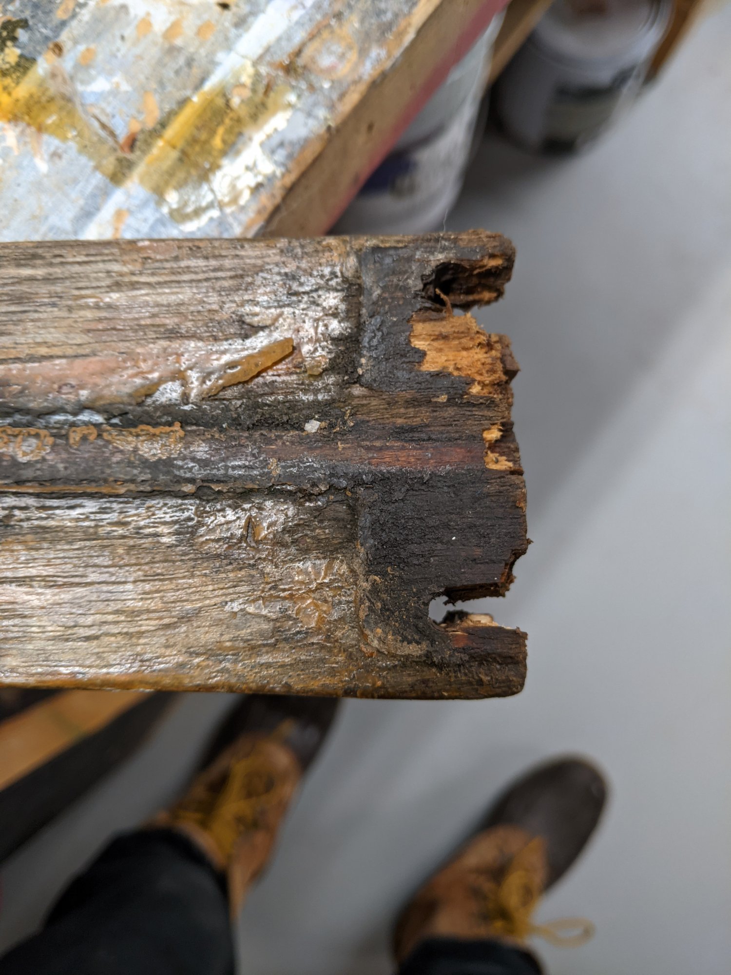

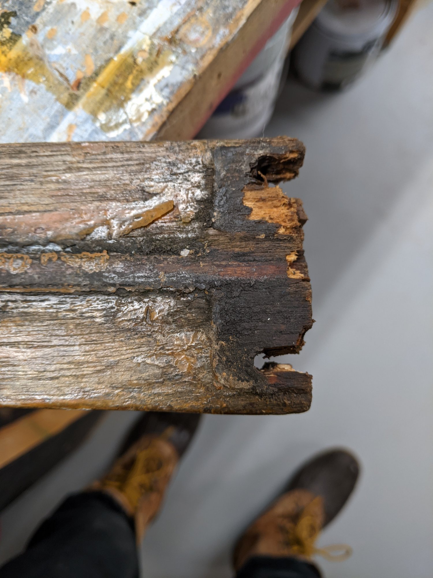

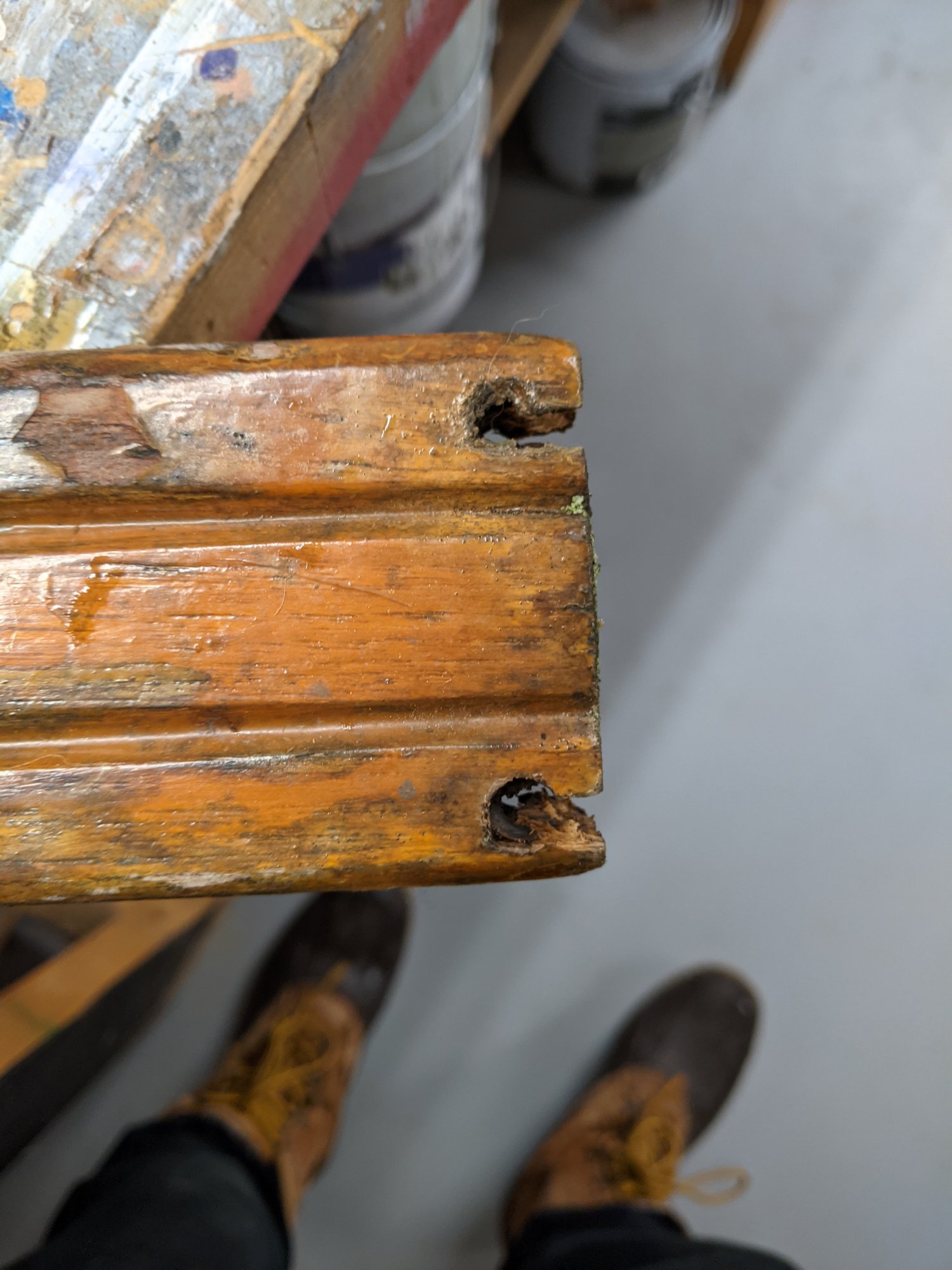

Hello sailors,
I'm refinishing the steps on my swim ladder and I found some rot on one of them where the screws secure it to the ladder itself. The wood is teak and the integrity of the rest of the step is very good so I want to try and repair rather than replace it. Any ideas on what to use to fix it? Thanks

It looks like a rope ladder with teak steps? Though it may be strong enough, epoxy filler is going to look weird. Can you cut off the ends of the steps and re-drill holes? The ladder would be a few inches narrower but would look better. Test out a narrower tread with a 2x6 first, to make sure it works for you.

The one side looks beyond repair. If this a rope ladder then I would not trust an epoxy repair as it will essentially be a big chuck of thickened epoxy butt jointed to the wood. The shear forces might not survive being stepped on.
