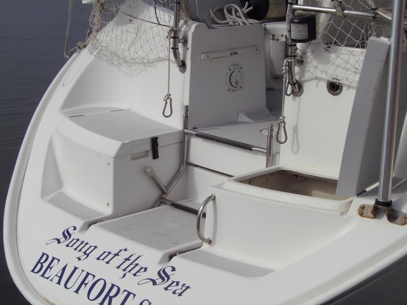

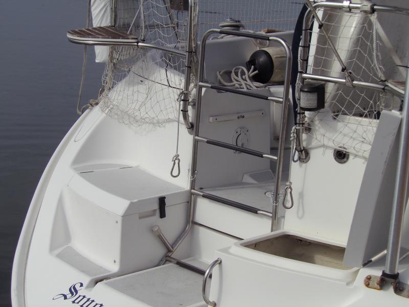

I finally got around to "engineering" my solution to keep the Admiral happy. I wanted to keep the original ladder but had to figure out a way to make it a two piece ladder. After some discussion with my welder we came up with this idea and it seems to work very well. He first cut the ladder so that no step would protrude above the deck. Then he welded a solid stainless steel rod inside of the ladder tubing and fitted it together before drilling a hole that would allow the the two pieces to be fitted together and pinned. It seems to work very well and is easy to rig up when we get underway. Here's the picture (I'll have to put the detail picture in the next post)

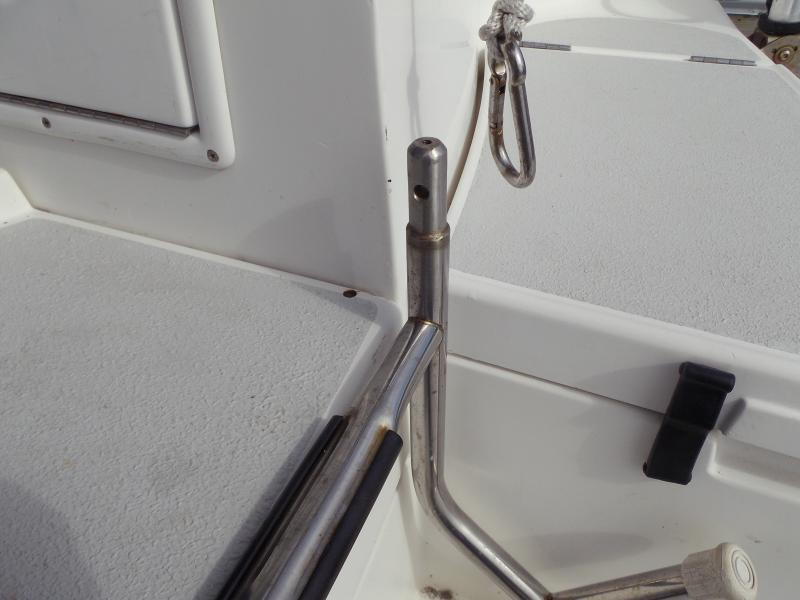

Here is the detail picture of the welded rod that was put in with the hole.

Smokey i really like what you did to that ladder a very good innovation.....

I like what you did Smokey. How did you remove the swim ladder so your welder could work on it?
Oct 26, 2010
2,161
Hunter 40.5 Beaufort, SC
The swim ladder is attached to the boat with two bolts on each side in the channel where the ladder fits on the swim platform. (it swings around the the hinge) You can access the nuts from inside the swim ladder lazarettes. It may be bedded in but hopefully not with something like the devil's glue (5200). I rebedded it with butyl rubber tape.
