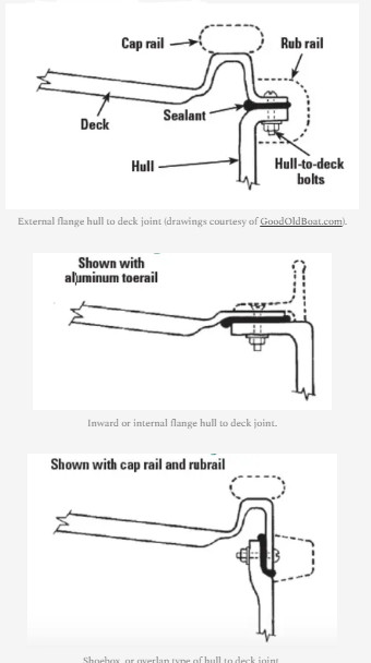

Hi, had the same problem on the same model boat only in the stern. I kept a towel down by the rudder post years ago and it would be wet after heavy sailing with some water in the bilge. Pulled the chrome strip and the molding off the hull joint at the stern about 8 feet in either direction. Resealed with 5200. Took care of most of the problem. Probably water coming in along the joint somewhere else. A lot of screws to remove. Have some spares and a easy out.

I've communicated with someone at the Hunter parts store and they confirmed that the hull-to-deck joint on our 2007 H41AC is like the first example in the attached image. He said that the screws whose heads are visible in the stainless strip on the outer part of the rub rail protrude into the joint between the deck and hull flanges. Now, my task is to find where the water is getting inside somewhere along the hull-to-deck joint.
