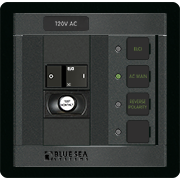

For the breaker I would recommend a ELCI breaker panel within 10' of your power plug ( recommend smart plug). If you plan on generator or other 110 power input the ELCI can be combined with a input selector switch. At same time look at galvanic isolator if not already fitted to your ground circuit.

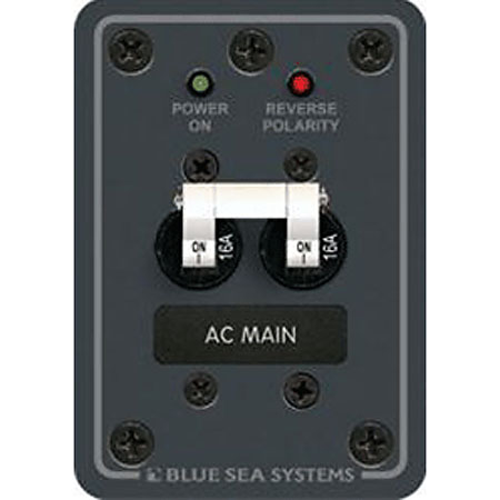

Mount one of these BSS AC breakers in a box in the lazarette next to your shore power plug.
This WAS/IS code, the run might be actually just under 10 feet. But in any case a good idea.

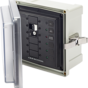

Unless you already have a ELCI - I would not recommend the one Jackdaw shows. These are now part of the standards -- use the enclosed one if installing in lazaret or other exposed location (Blues 3116 & 1502)

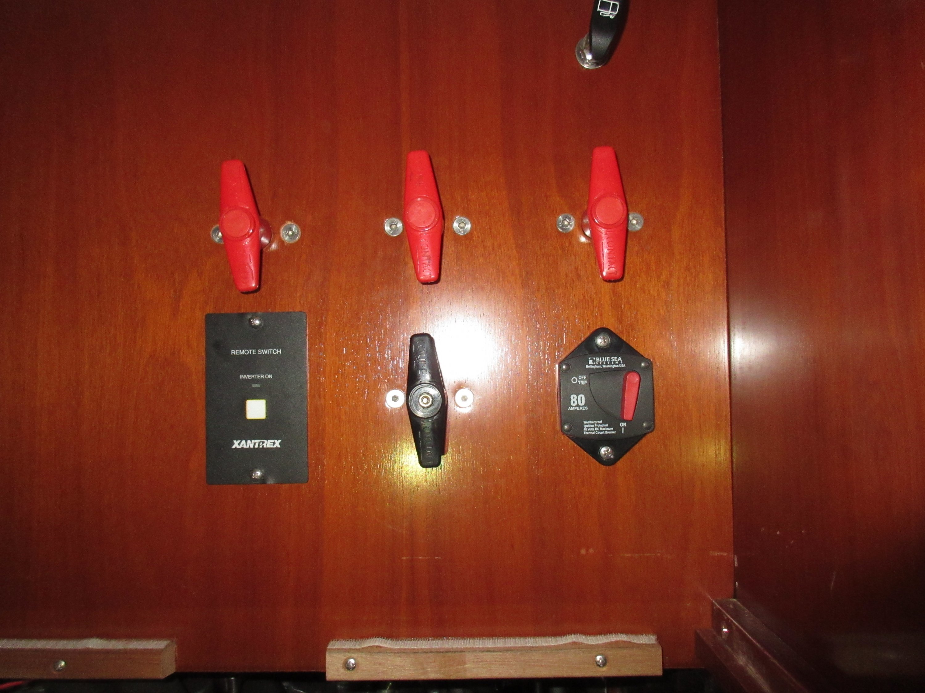

I'm not sure how the boat is set up yet. She does have 3 D's in the port lazarette and a group 27 in front of her engine. There are three red switches and one black. I was going to rewire the three D's as one house and the start as the reserve. Again, I'm not sure how she is wired or how the whole thing works it's all French to me :biggrin:. I'll spend this season learning her. Sounds like the third D is for the inverter, is that what your saying?

That's the standard Bene/Jeaneau kind of battery switches, red ones break the positive connection for each bank, and the black breaks the negative for all banks. I thought they were labeled, perhaps very small on the handles themselves, having 3 red would indicate 3 banks. Just started trying to figure out a friends Jeanneau, so far we've learned that if you leave motor battery off you can't start off the house bank, this seems to eliminate the redundancy feature of 2 banks, so we're doing some head scratching. I guess we'll have to resort to checking the wiring plan this weekend so we can at least figure out what it was "as built" prior to any PO improvements.
:plus::plus::plus:
OEM mounted like this saved our Main 120VAC Panel from an apparent nearby lightning strike "back surge" (many boats on shore power affected). The breaker would NOT reset.
Perhaps they were installed on the 10' rule, but easy to change.
Mine have a weather protectors over the switches, in the lazarette.

Two different issues are being discussed re. breakers, weather protected (your choice depending on location), and ELCI vs regular breaker. You should have ELCI somewhere, already installed at the electrical panel or the new breaker near the inlet. ELCI breakers have a test button, and cut off if load vs neutral differs by 30ma. or more.
