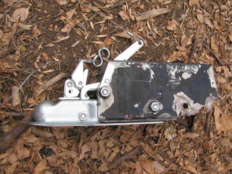

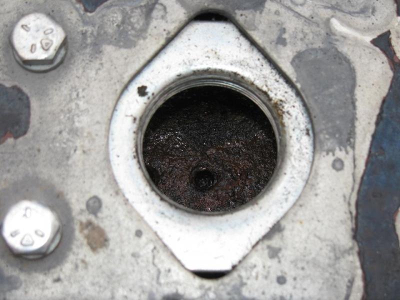

Hi Walt,
I have my Atwood 6k coupler off the trailer and in pieces right now. I bought this boat and trailer the end of October, so I'm just getting started. The surge break system is toast because of neglect (rust) and those dang bearing buddies. I ordered and installed new backing plates and replaced all four sets of bearings and seals. Got 4 nice dustcaps too. :D I tried to save the coupler, but no luck, so I am getting ready to order one online. Mine has the lockout that looks like the one shown in your link. Mine is the black painted model, rather than the zinc one shown. I can't really give advice about the other models, but I'm sure they will all do the job.
If pictures of what the coupler's innards look like would help you in any way, I will be happy to take and post some.

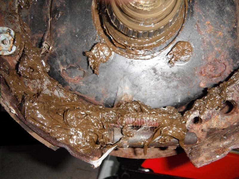

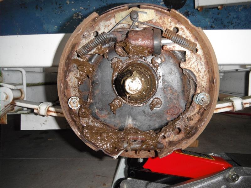

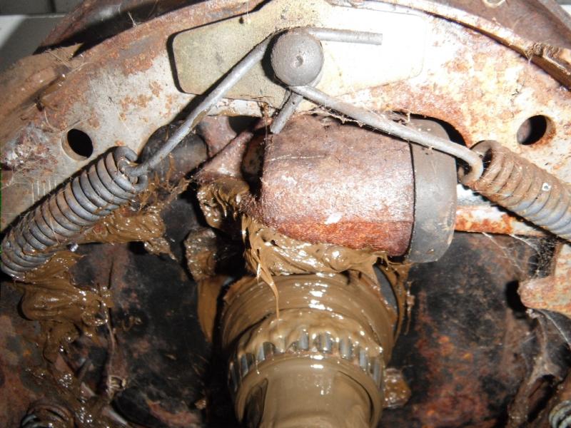

Hi heymagic will you enlighten about damage caused by the bearing buddies-"The surge break system is toast because of neglect (rust) and those dang bearing buddies."
Sep 30, 2009
66
Oday 23 Up Nort'n WI
Well the brake system IS toast, but it is mainly because the fluid in the coupler was never checked or changed. Rust took over in the whole system. Brake fluid is made to absorb water, and after a number of years, changing it is a good idea.
Bearing buddies. Lot's of folks like them. I'm talking here about the kind that replace the grease cap, and supply grease through the front only. I don't like them.
I never want my trailer to hurt anyone. If I haven't inspected my wheel bearings, brakes, and checked the play in the wheels, I don't know for sure what's going on in the hub. So my personal preference is no bearing buddies.
The boat and trailer I just purchased has 4 wheels and 4 bearing buddies. The PO said he just had the wheel bearings inspected and lubed for $89. See pics below.
To all of you that like 'em fine. I'll keep repacking mine each fall.
Just my two cents, and that was before inflation,

The bbs you describe obviously weren't serviced properly if at all. I was a dealer for 13 years and they always worked fine for my customers. Not much in this world works if you do not take care of it. And I sold a lot of Magic Tilt trailers new and used.
Sumner
Jan 31, 2009
5,254
I have bearing buddies on the boat trailer, but not on our other trailers. I guess I'll see how I like them. I think that no matter what you are using a person has to pull the hub apart and still check the bearings from time to time.
The center fill look good, but still the grease is going to go the easiest route and if one side plugs up then it is all going the other way. Same with the bearing buddies. They just need to all be serviced.
Your picture...
...of the drum brakes is exactly why I wouldn't have them on a trailer that is going in the water. Just too many parts to rust up and not work. I have electric brakes on a car hauler trailer, but surge...
http://purplesagetradingpost.com/sumner/macgregor2/trailer-mods-8.html
...disc on the boat trailer and love them at this point anyway,
Sum

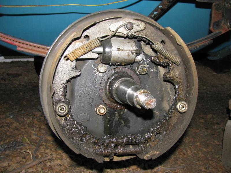

I ended up ordering the Tie Down 66 for drum brakes. Why... no really good reason but I sometimes have to load/unload the trailer with the truck at a different angle than the boat so stayed with the ball interface I’m more familiar with. The Tie down also has an aluminum master cylinder which I wanted to try out. I’ve attached some pictures of the Titan coupler that I just took off (had to be grinded off - but this also means no holes so I can put back on whatever I want). I think the Titan also worked fine but one picture shows the reservoir of the cast iron master cylinder. This one is only two or three years old and looks rusty- but has also spent most of its life with no brake fluid (I have a leak.. another thing to fix).
Also attached is my 21 year old drum brake hub before any cleaning - also used with the bearing buddy. It’s been about three years since I have had this apart - maybe close to 4.5K miles (too long :redface:). I replaced the hub cylinders (also aluminum) also the last time I had this apart.
