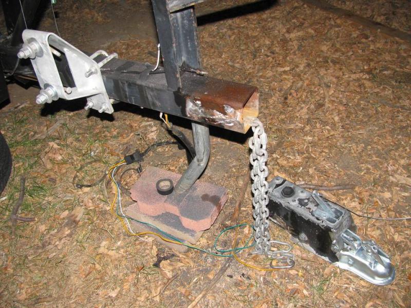

I’m hoping Sumner will read this.. but I’m working on my trailer brakes again, plan to leave them as hydraulic drum but am going to replace most of the hydraulic lines and also the coupler. I’m very interested in the Tie down model 66 http://www.trailerpartsdepot.com/itemdesc.asp?ic=47210&eq=&Tp= and it turns out to be close to what Sumner used (I think he has disk brakes, I am keeping the stock drums). FYI, in the attached picture, you can see that I’ve ground off the welded on actuator that was on the boat when I bought it. The weld was a pain but it also means I don’t have any holes in the trailer frame so I’m not limited to mounting the same type of coupler..
Anyhow, what I’m wondering is: The Tie down has a pin that will lock out the surge action of the coupler. I’m wondering if this pin is robust enough to say lock the coupler out if I had to drive 100 miles in snowy road conditions? I.e., its intention is for occasionally backing up the trailer but I also want to be able to use it for driving in snowy/icy road conditions.

I would call Tie Down and see if that will work with the drum brakes. On a car the brake reservoir and some other items are different for the disc brakes in the front and drums in the rear if that is what is what the car has.
Drums have springs that pull the pads off and disc don't, so the residual valves that control the fluid in the system are different and they don't use the same amount of fluid on the plunger stroke. Just check first. I see the other one you posted is for 'drum brakes'.
If the coupler assembly won't work in the future with disc brakes I'd try and bite the bullet and just switch now. For less than $500, closer to $400 you would have the new coupler, all the hydralic lines and the new hubs with disc rotors. All of the above work great and will not rust up like the drums.
On the lockout, there is just a hole that you put a pin in. Any pin and I'm not home, but you could probably put in a bolt with a nut on one side if you can reach up in there. I think you can, but I can't look today, maybe tomorrow or tonight. You could drive forever that way.

That pin that is dangling on a wire is supposed to be inserted into the hole in the ball part of the coupling. You can see the hole on both sides that is situated right behind the ball when the coupler is resting over the ball. That is where you put that pin when you are going down the road. This is on the new Tie Down coupler/actuator that you are buying.
