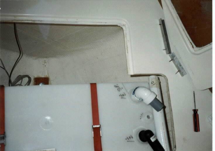

Here is what I did.
The Related Link to the Photo Forum is one possibility. As pointed out in the text with the pictures a larger tank will fit. But I had to retain access to the thru-hulls. Also in the Hunter Photo Forum see "Getting Ready for a New Holding Tank". I actually prefer Morrie's way of opening up the area. I wish I had done mine that way. Also see "completed holding tank" in the same Photo Forum. Another approach.

Debra, that odd-shaped bottom is going to make it very difficult to position the outlet pipe. Remember that it is a standpipe, it goes in at the top and down close to the bottom. But where is the lowest and flattest point of that tank. At the very least it has to be near the middle which means you will have the hose running across the top of the tank. I agree it will fit but that shape is going to make it very difficult to secure. I really think you want to glass in the supports and screw down a shelf like I did. As you can see in my Photo Forum article(first post here) that was fairly simple and is bulletproof. B115 is only three gallons larger than my tank. And it allows a lot of remaining storage in that locker. We can discuss offline if you wish at: h37skipper@aol.com
