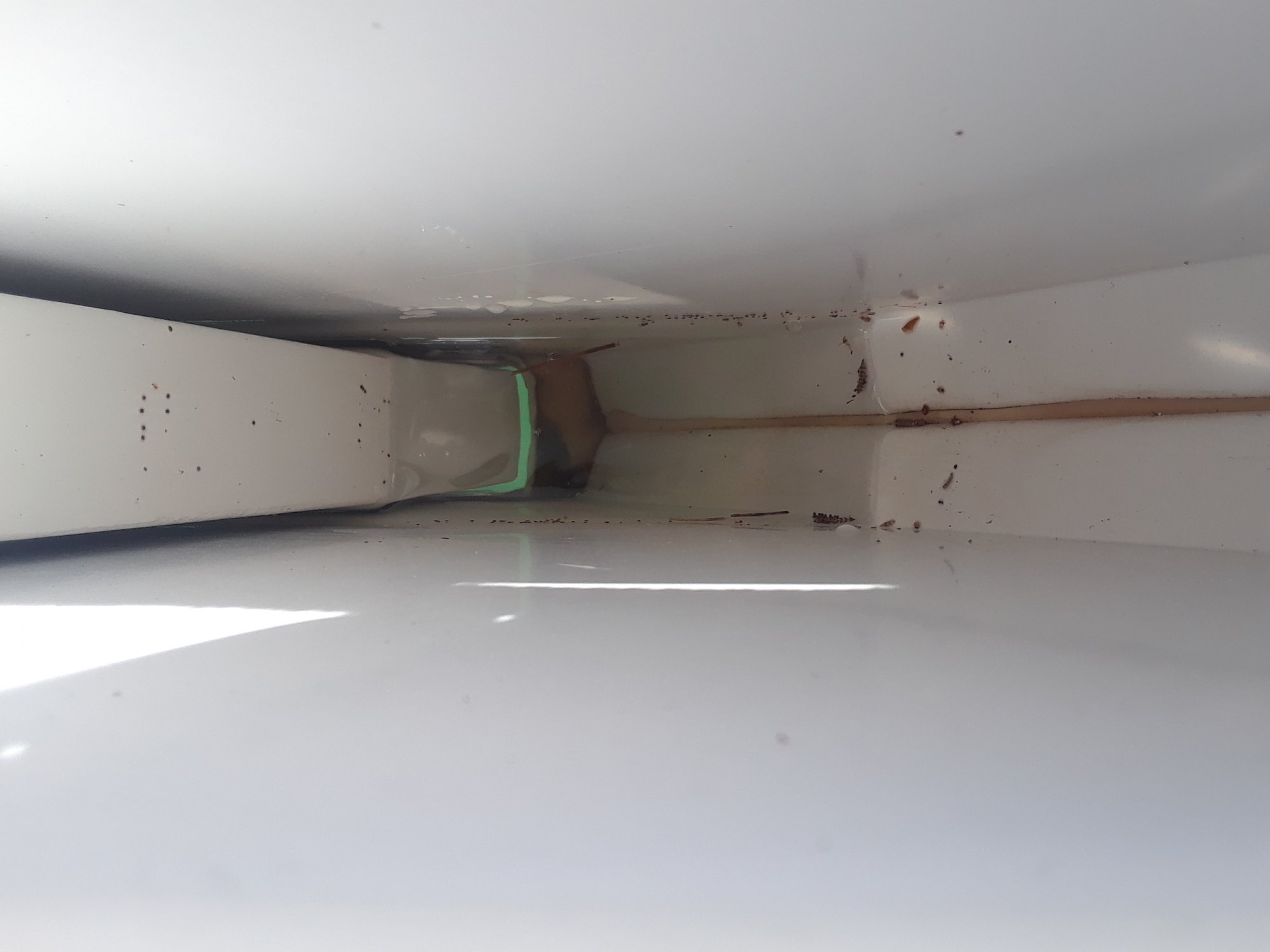

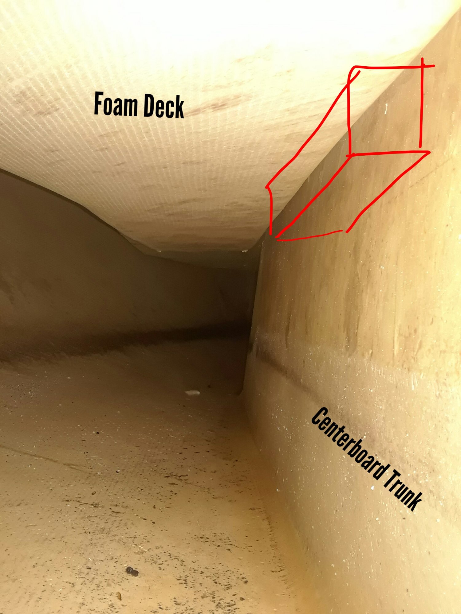

Your photo has me thinking I should try to snake my borescope in and around the trunk in search or evidence (or lack thereof).
Sep 24, 2018
3,512
Catalina 30 MKIII Chicago
The boroscope is a good idea. You could probably use an automotive jack to lift the boat up off the trailer a tiny bit. I'm guessing you would only need to raise it an inch to slip a piece of wood under your keel to maintain a gap for the scope
I have hoisted a similar sized boat in the air for centerboard repair. There are a lot of things that can go wrong. If I were to do it again I would pay the marina $100-200 to forklift it onto a cradle. It's not worth the risk or the stress

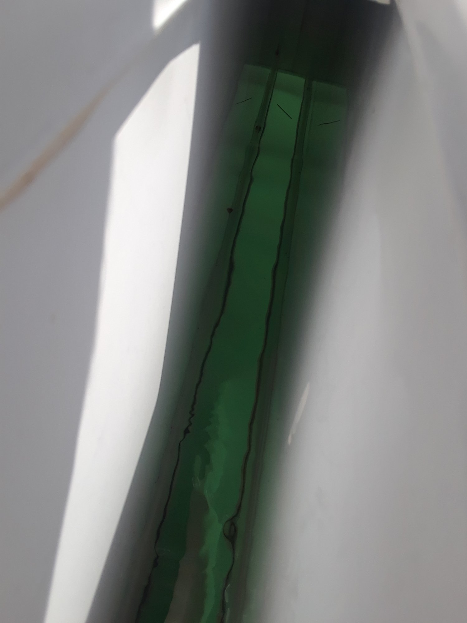

The boroscope exam was revealing. From the side I could view it does not look like there is any leakage along the trunk, just at the front, fore of the tabernacle mount. I will drop it anyway to remove and re-seal the mount, and insert any needed filler in the screw holes to make sure everything is tight.
Yeah, the hoisting thing is not worth the trouble or risk in this case. I will address what I can with my current resources.

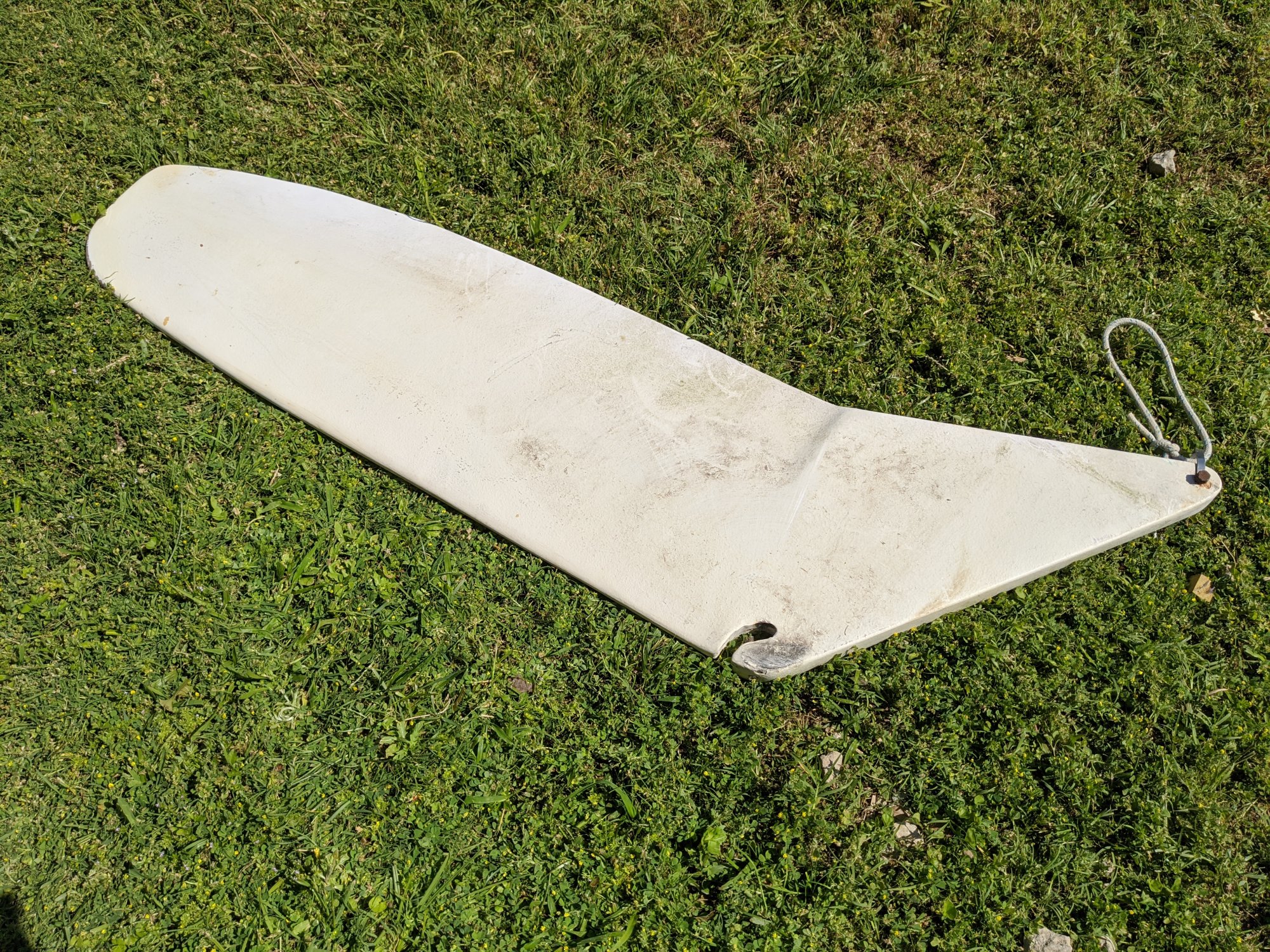

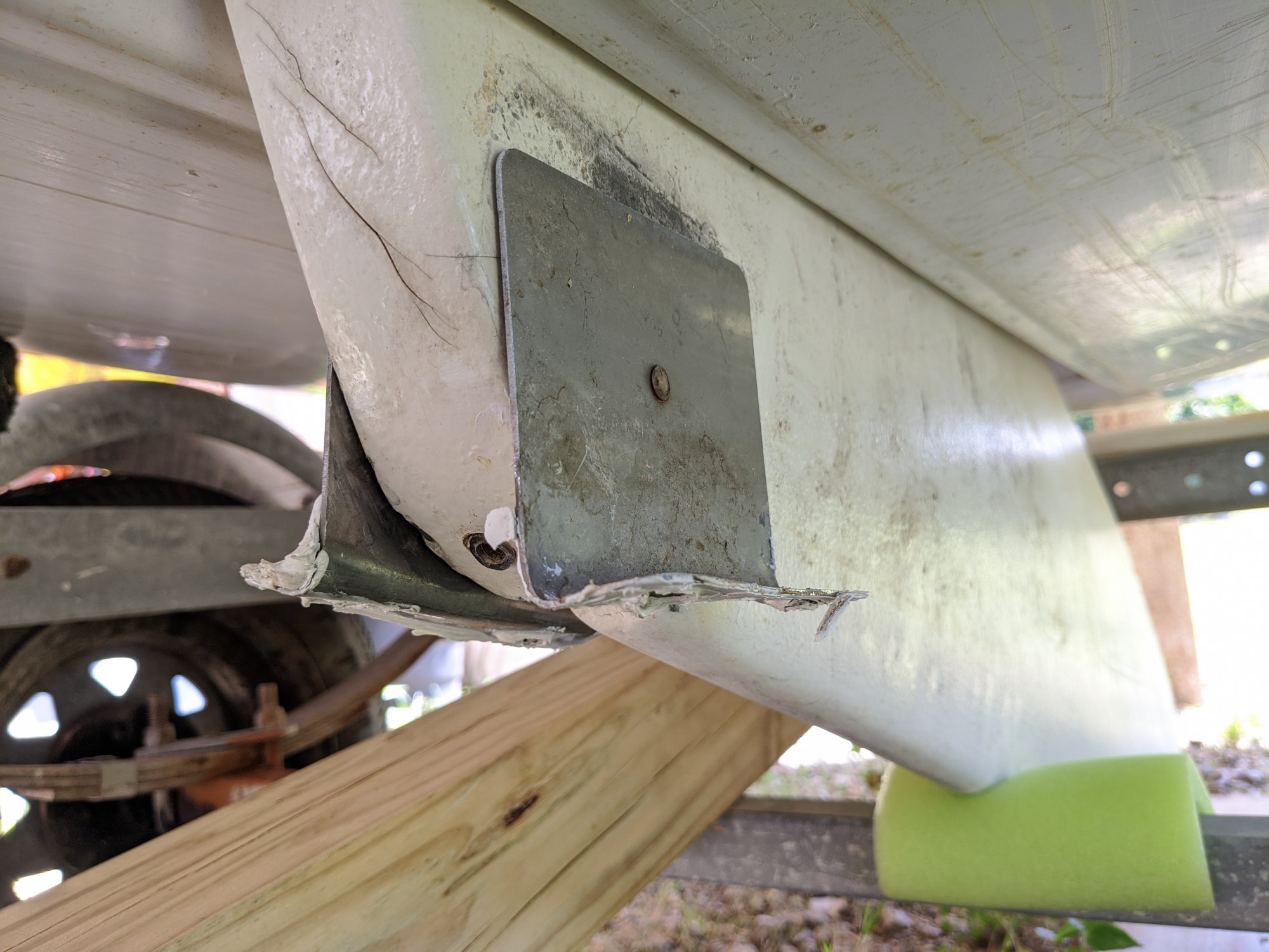

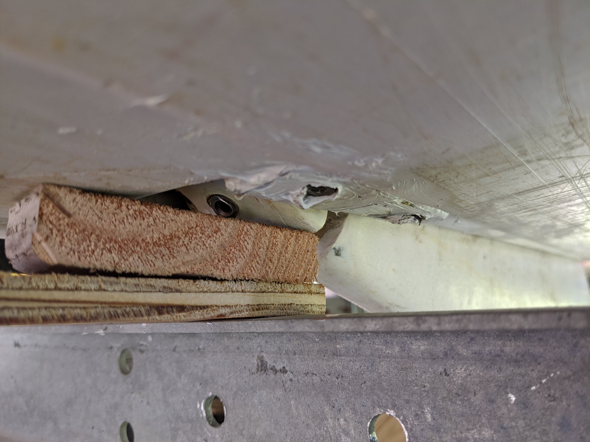

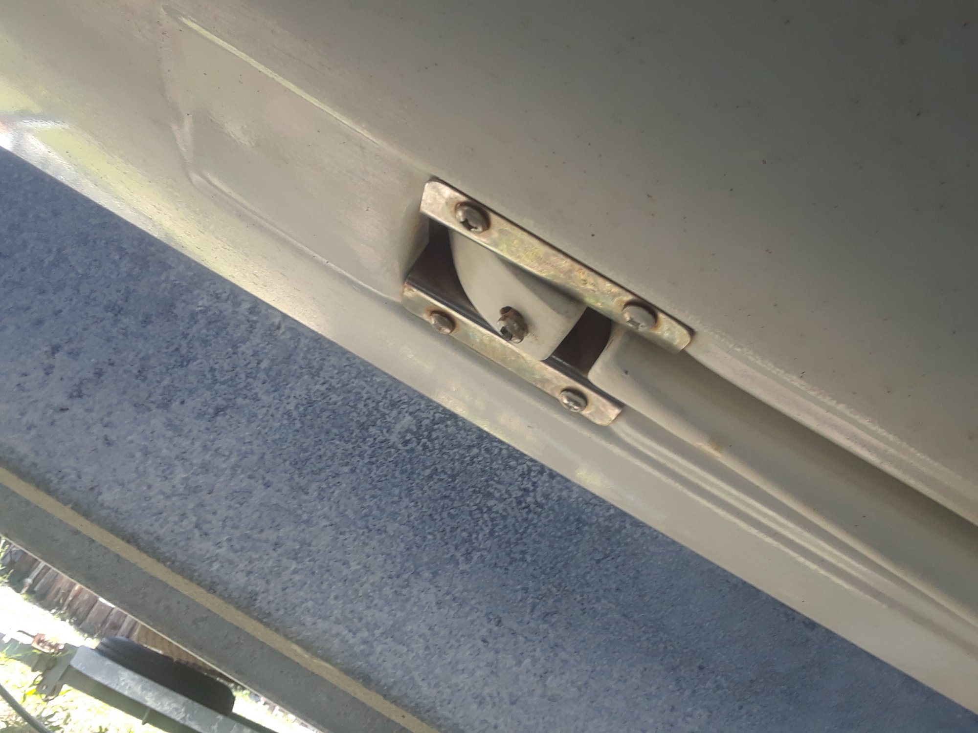

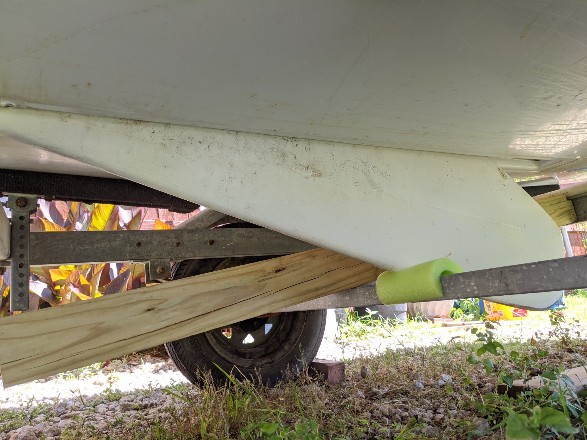

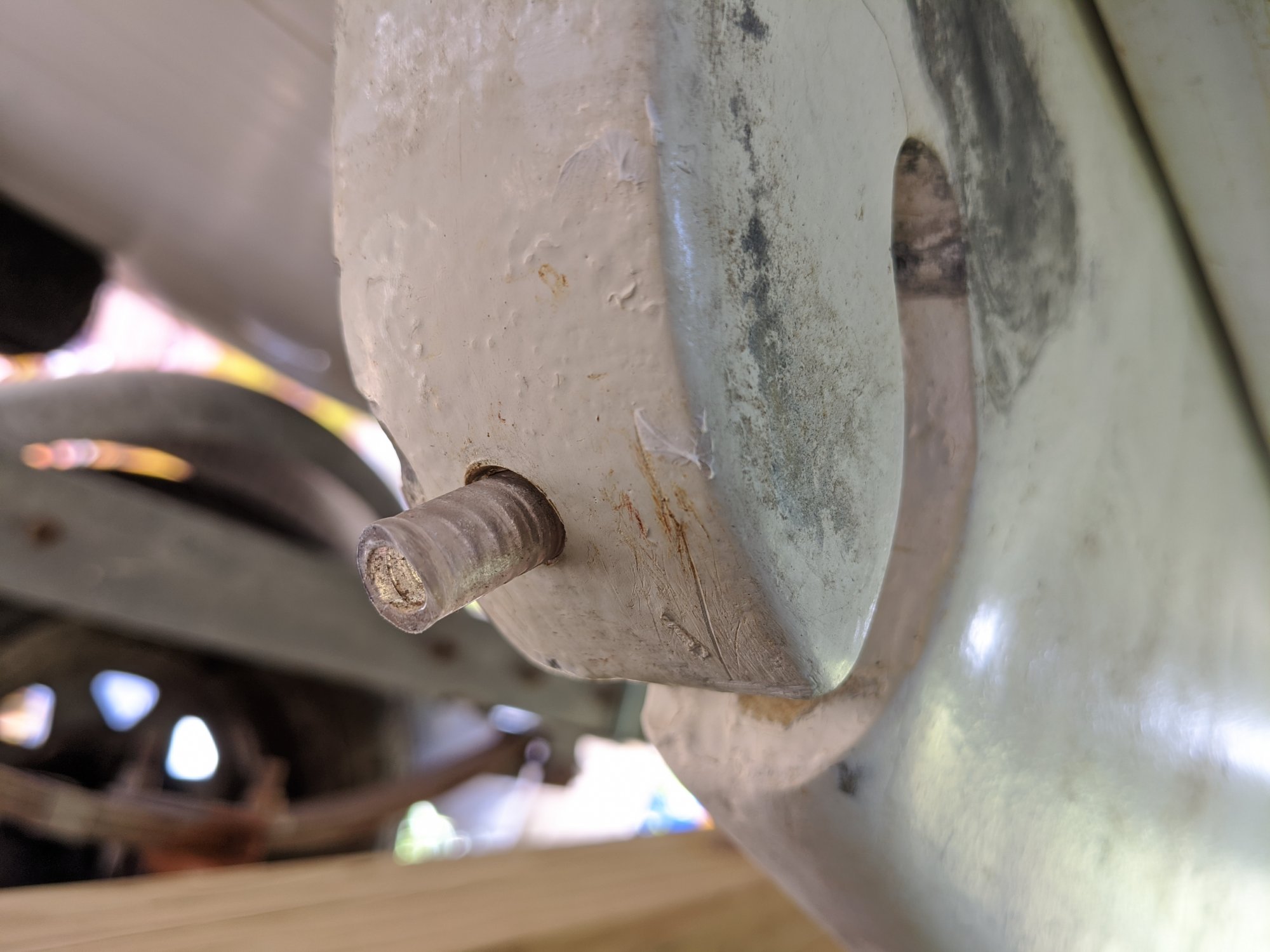

Success! Thanks to everyone for helping me think this through!
Turns out the key to removal of the centerboard on the 170 without having to hoist it or put it in the water is removing the four screws holding the mounting plate to the underside of the boat. Once that is done, the large retaining screw can be removed from the centerboard (actually, I removed it before removing the mount screws) and the centerboard can be removed by lifting it up through the trunk.
I started by lowering the centerboard so that it rested on the axle of the trailer (first photo). The second photo shows the fore end of the centerboard being supported by shims placed between it and the trailer crossmember. This allowed me to undo the four screws holding the centerboard mount in place without having it come down on top of me.
The third photo shows the mount and centerboard once freed. From there, the mount can be slid out of the mounting slot on the centerboard (photo four). I tied a rope to the bale at the top fore end of the centerboard and with a good deal of effort managed to lift it free and set it off to the side (photo five).
I sealed everything that looked like it might possibly allow water in with silicon sealant then re-installed the centerboard and mount, being sure to put sealant between the mounting plate and the hull, in the screw holes, and on top of the screw heads.
An important addendum to this is to take note of what BobbyFunn said earlier: "There might also be a plastic or nylon spacer around the lag screw. Remove both." If what he was referring to was the plastic sleeve seen protruding from the retaining screw hole on the centerboard in photo four below, then it's possible I might have been able to lift remove the centerboard without removing the mount. Turns out that sleeve is long enough to block the slot in the centerboard that slides over the pin in the mount, and very well might be what thwarted my earlier efforts to pull up the centerboard through the trunk. It had to be pulled out to the position shown in order to remove the mount.
Now to see if what I did has had any effect. Stay tuned.
