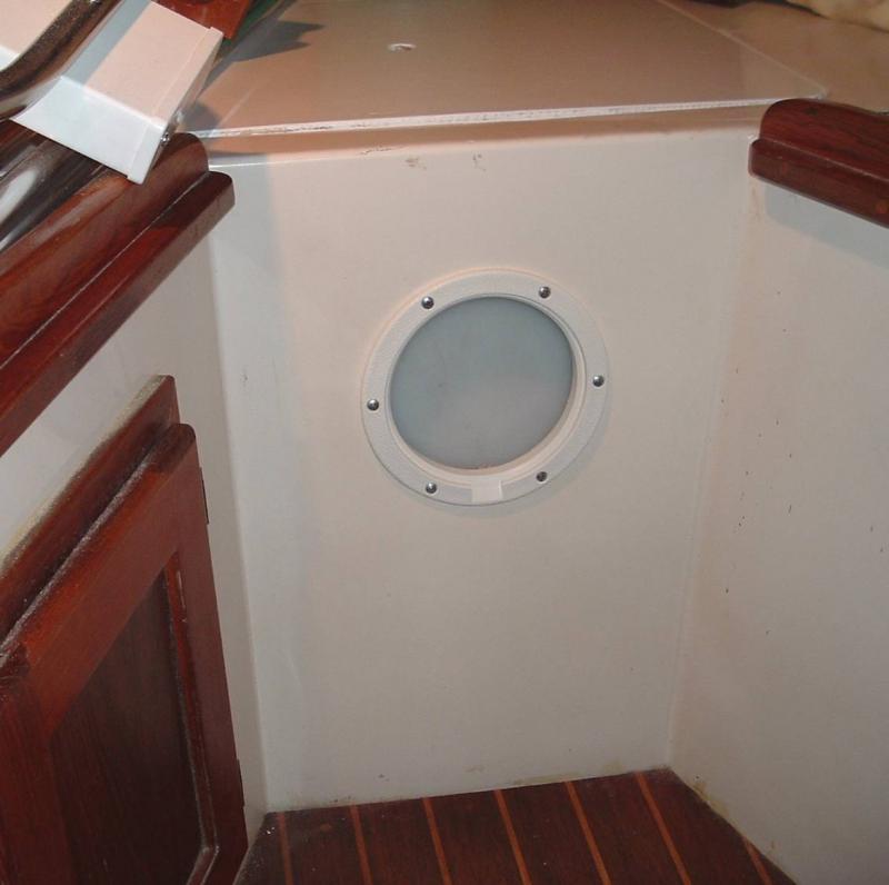

I glassed side braces on the hull and glassed/screwed a support on the v-berth bulkhead. That gave me three supports for a one inch shelf. My 22 gal. Ronco tank is very thick so I wasn't too worried. I secured it there with two of those ratchet tie downs. I think they are rated for 3000 pounds. You can see some of it here: http://hunter.sailboatowners.com/in...&cat_id=38&aid=7012&page=article&mn=37-cutter
P.S. here is my tank gauge(pic). ;)
1,483
I did what Ed did, but I put a half inch plywood shelf on the 3 supports, tank on the shelf.
