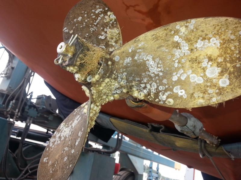

Suggestions on How to Keep Barnacles off Prop
tim61
Sep 17, 2013
2
Catalina 30 MKI West Bath, ME
Trying to avoid this next season? I have been told you can first epoxy the prop and then put anti-fouling paint on. Not sure the brand or the best ways to prepare before painting? Any suggestions?
