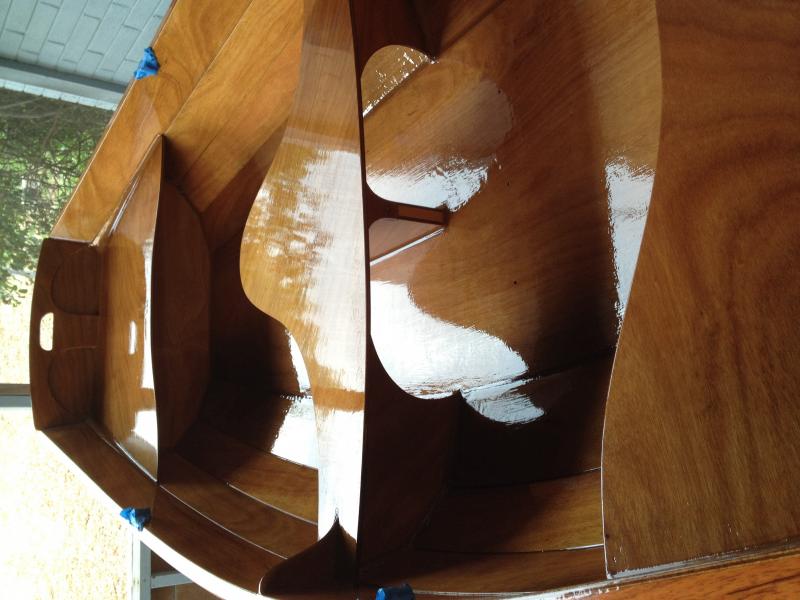

Varnish
Interlux Schooner is my varnish of choice these days. It's thicker than most other varnishes I've used in the past.

that's a beautiful boat.
I've always wanted to build one of the small sailing dingy's no real reason or purpose for myself just think it would be fun to build.

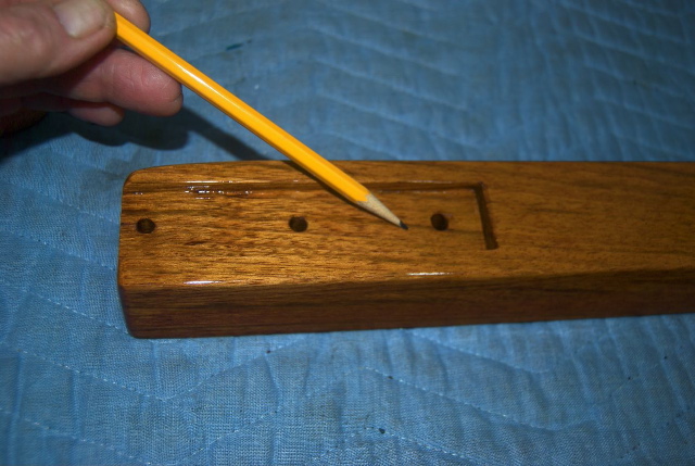

Got my new rudder handle made and ready to varnish ordered the varnish and today finished up my screen door for the companion hatch.

Thanks, that's four coats of the Schooner.

well I didn't go fancy with lamination but I have a barn full of black walnut that is all 3" thick so I cut and carved my handle. If I don't like it I'm out nothing besides some time.
Went off the beaten path on mine measured out where I hold it every time I go out and never hold my old one toward the end so I shortened my new one by approx. 12" giving me a decent amount of extra space in the cockpit.
Gonna give it a shot this summer and see how it goes. I'll like it or not if I do I've got enough walnut to make about 200 more if things go bad :)
I'll maybe post a pic or two when I get it done but it's to cold now to varnish have to wait for some warmer weather.

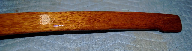

If you drop anything on, 30 coast of varnish - or 3 - you've penetrated the barrier and have "lost" any real sealing in that one spot.
The depth of shine with 30 coats is undeniably superior to 3 alone but not 10 times better ;)

There's a reason the pro's do ten coats. The build coats for the obvious reasons of shine and depth, but any more will probably just compound the effort getting it all back off if you need to strip it. But the idea with ten is you lose a coat during a year from elements, and then ideally two more coats will go when you sand it to freshen up the varnish yearly at three coats to get it back to the ten number. (Oh yeah, you get to do this every year).
At the end of your maintenance coats, fill a small two ounce bottle or so with the varnish, and a Q-Tip and small piece of 220 sandpaper rubberbanded to the jar. When you have those dings, spot fix it THEN. There's a hole in the pool, and it needs to be fixed now!. If water gets under it, it's all coming back off. THEN, you have to use wet or dry sandpaper, because aluminum oxide paper will not work well sanding through tears.
