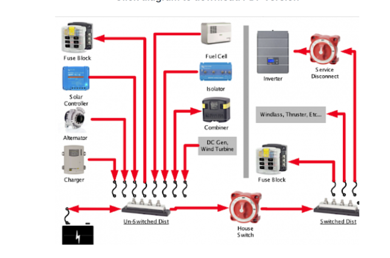

As mentioned above, Ideally, you want the MPPT as close as possible to your batteries or your hot battery bus... On most boats, the most practical location is close to the battery switches. If you don't have a hot battery bus (unswitched DC bus for MPPT solar, inverter/charger, etc...), now's the time...
System efficiency is paramount for solar, thus the necessity to be close to the batteries with the MPPT (to properly sense battery voltage).
