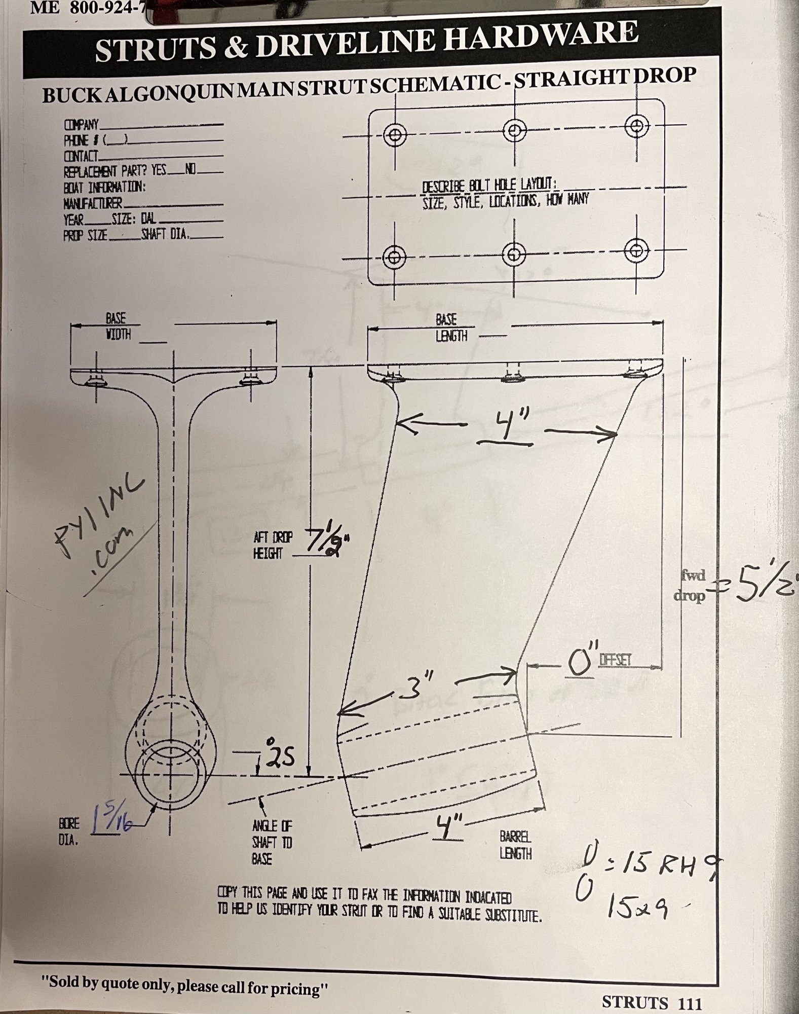

HI all. The propeller strut on my O'day 31 loosened six years ago and after an extensive repair, now it has loosened again. The yard says that the strut on the 31 uses a slot and pin arrangement and they are not confident that a second repair won't end up loosening as well. They propose to install a traditional bolt on strut - from a 30' O'day. The Oday 30 is the same as the 31, except for a 1 foot swim platform. So now I am looking for this obscure part a strut for an O'day 30. I have already checked D&R, a no go. Any ideas? Maybe there is something similar out there?
