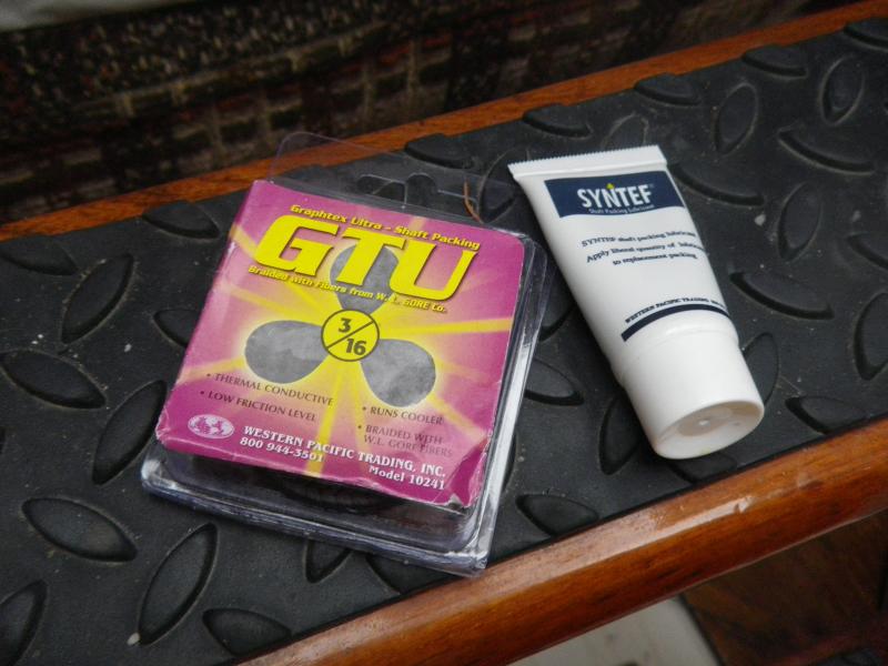

I used 1/4 inch
Shaft Packing - Graphtex Ultra GTU

Correct. Most 1" shafts use 3/16" but some use 1/4".
