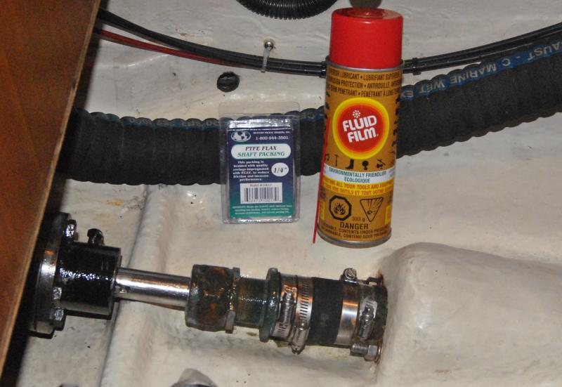

How do you use it? Where do you spray it? How good does it work? Etc?
http://www.fluid-film.com/products/
The product is an aerosol spray that is like penetrating oil when it first goes on. It penetrates everything. As the volatiles evaporate, it becomes a greasy, sticky, endless film that smells like a cross between a wet, long haired dog laying on a heater vent and a restaurant grease trap on a hot summer's day. Actually, it only smells when it first goes on. Odourless after it dries.
I spray the coupling and gland assembly with it to control corrosion. The shaft cleans up easily when it's time to re-pack. There's always a bit of salt residue around the gland even though I run it bone dry. Not a trace of corrosion on the coupling or any other metal that's been sprayed.
