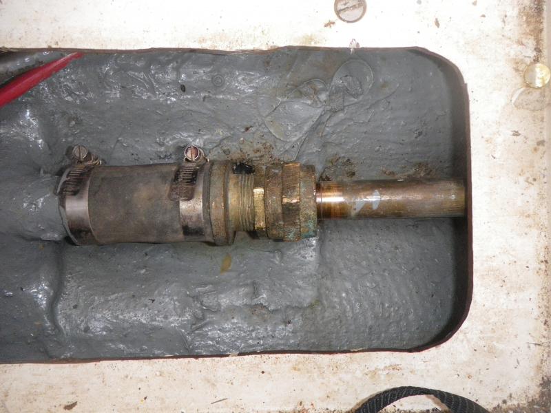

WELL I looked at the stuffing box, and yes, the nut is right under the sole where the sink and counter is. SO, I am putting it off for now. I have to see how bad it is really leaking. If anyone has a good suggestion as how to do this, it would be appreciated.

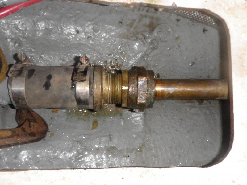

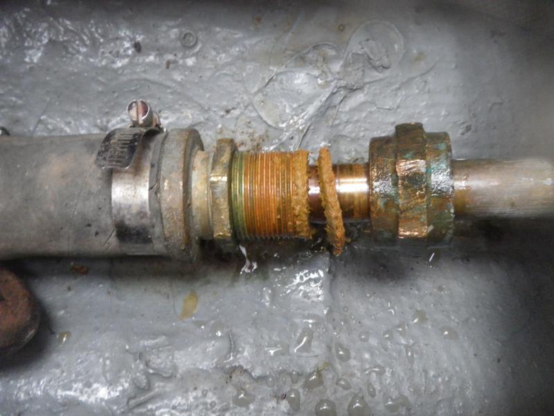

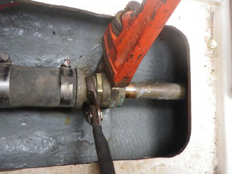

Bob,
mine was directly under the cabinet face I know what you mean :confused:impossible to get 2 wrenches on it. I was thinking of making an offset wrench someday. What I did was to take some PB Blaster and sprayed it into the cap and applied it to the nuts with an acid brush. Be careful and patient. Took about 4 applications soaking overnight and I was able to break the retaining nut using a small ball peen hammer and a center punch. You have to be patient not to destroy the nut if it doesn't move easy reapply PB. Once I had it free I used a stainless wire brush in my drill to clean the green tarnish from the nut and threads. Repacked it and tightened with a wrench that MaineSail suggested. The angle the wrench takes to engage doesn't do a great job in tightening it. It's not much tighter than hand tight. I've had no trouble with it after 2 seasons. I actually was worried I was not getting any water dripping yet the shaft has always been only slightly warm to the touch after many hours of motoring.

Bob, You have some good ideas on how to break the packing nut free. I tried to open it last fall to repack & it wouldn't budge. I had the same green corrosion on the surface. Doesn't look like mine's been opened up in eons. I may try your soaking in PB Blaster trick. Or I may just wait till the next haul out to deal with it. I was worried about stripping off the nut. My problem is that the seam continues to drip about once per every 3 -4 seconds even when the engine prop shaft isn't turning. Nothing my bilge pump can't handle, but it keeps my bilge wet. I would love to have a dry bilge, but may wait for a while to deal with it.

When I first bought my boat the packing nut was frozen hard. Took me three days, a can of PB Blaster and two big pipe wrenches to loose it.
Soaked it with PB blaster waited, tried. No joy. Waited a day, soaked with more PB Blaster, tried. No joy. Third day soaked it with PB Blaster, cursed and swore. Got it loose :)

Stu,

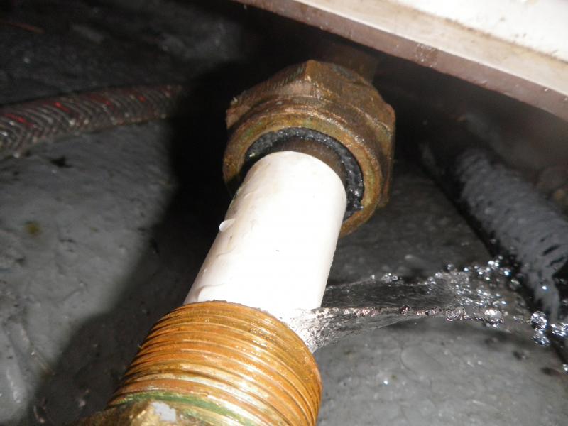

I launched BobCat on tuesday. Stuffing box was leaking more than normal. The mechanic easily got a small pipe wrench on the nuts. he accessed it from the access under the drawers in the galley. Loosened the big on and then the narrow one. moved the small one and then tightened the large one with the packing. Stopped the leak.
