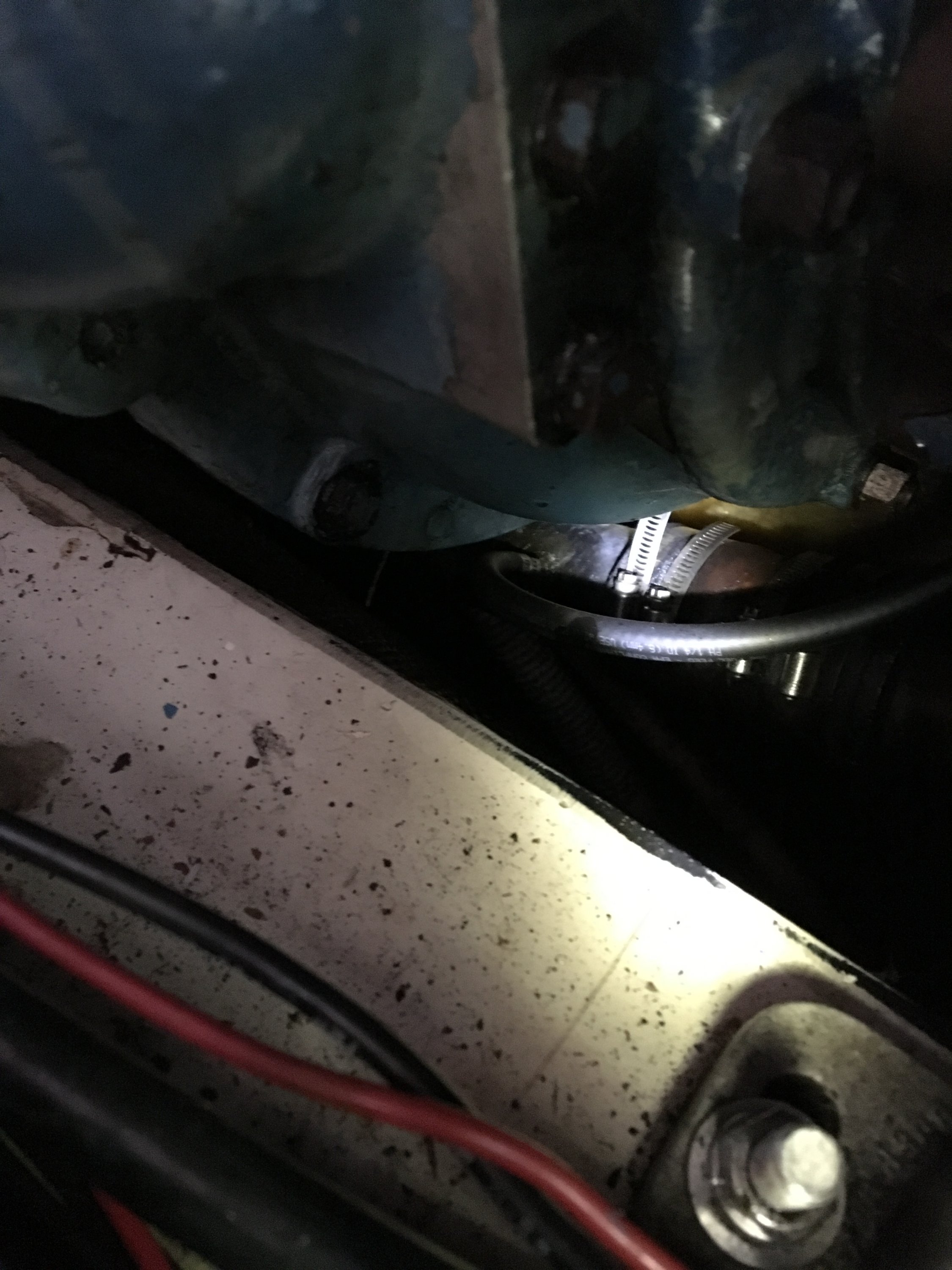

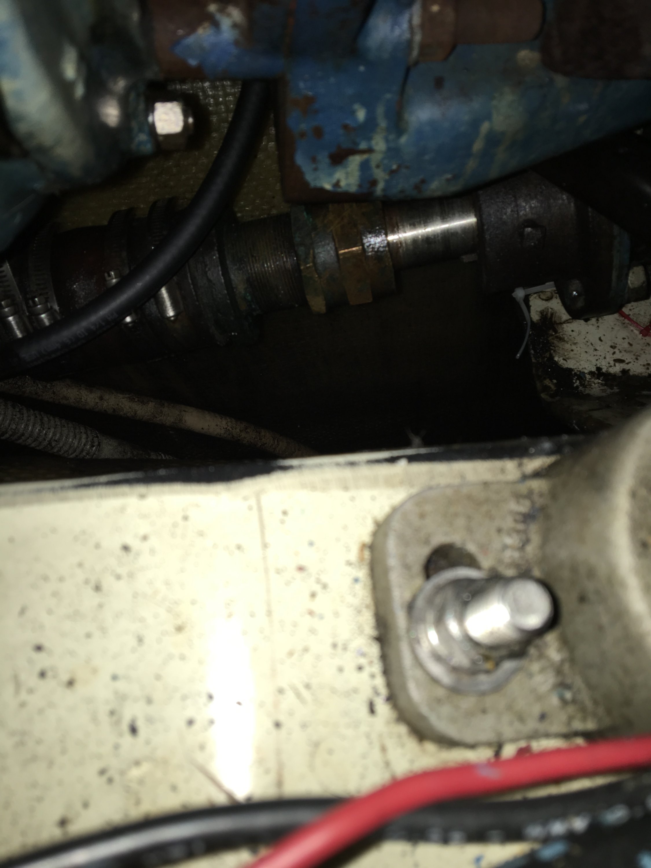

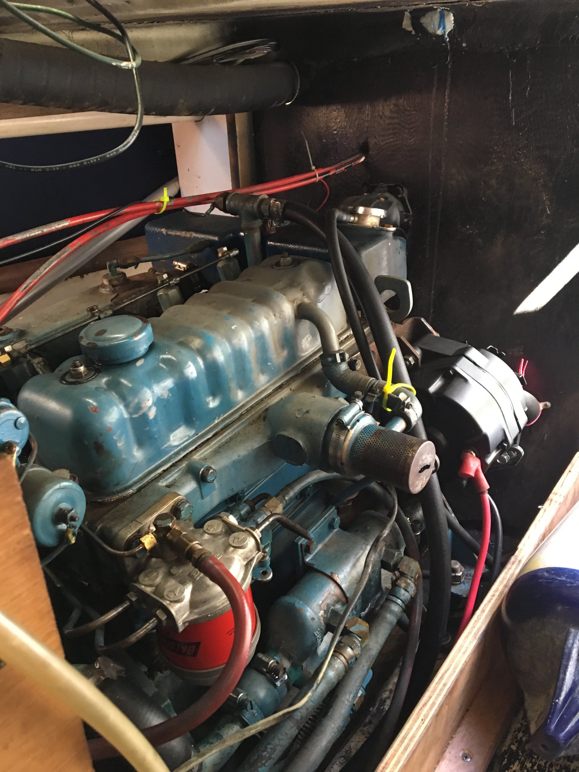

As it was explained to me...
Your stuffing box is down under that..
So tilt your head down, stick our legs in the air and reach out with your right hand while you balance with your left.
And do not let your tools fall out of your hand.. It is 4 feet down to the bottom of the bilge. You don't have arms long enough to reach and recover any tools. And we are not sure what else may be living down there.
I'll hold your feet so we can get you back out... :yikes:
Oct 29, 2005
2,362
Ok. Now what am I supposed to be looking at?? Hmmmm....are those two....1_1/2" spanners for the packing gland nut?
