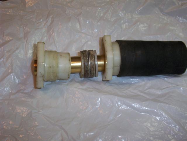

Hunter 28.5 Chesapeake Bay
A lot of Hunters (like my 1986 28.5) came with an OEM white Marelon stuffing box. While I think this material holds up relatively well, the problem I had with it was that it made replacing the packing material almost impossible. It had a washer in between to layers of packing material (see pic). I changed it out for a conventional bronze gland that I believe is stronger and much easier to replace the packing material.
