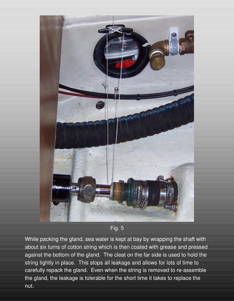

If you are going to replace all of the packing, this will take several hours or more. In order to keep the incoming water under control and your sox dry while digging out the old packing, try this :
Once you have the incoming water stopped at the shaft log, you have all day to do the job with no water ingress except for a small amount when pressing the new packing into place.
Practice just getting the string into place ON and OFF to start with.
This is how I do mine in the water as I'm not about to do it on the hard where I'm paying $40.00/day. I stick to the stuff that really can't be done in the water.

How this goes depends on the age of the packing and its composition. If it's old crap, all of it will require replacement. Relatively new, maybe be able to get away with adding a ring, if there's any room.

This is also how I do it and doing the job is really almost waterproof. The only 2 times you will get water in is first when you unscrew the packing gland before you have had a chance to wrap and tighten the cotton strings and put the grease. As mentioned after that is done you have all the time in the world to remove the old packing and install the new one. The 2nd time for water intake is when you remove the cotton string before you have screwed back the packing gland. Your bilge pump should easily take car of that but it's a good idea to make sure with testing before. Good luck
