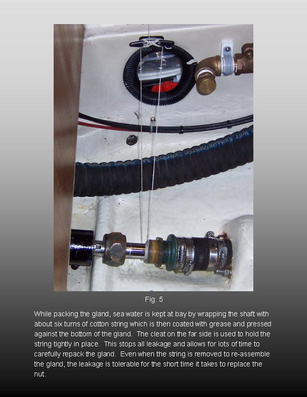

Thank you for all suggestions. There was a good amount of weed debris in water strainer also. Cleaned that out, should be fine as long as I stay away from the weeds. Lake Erie is tough. Stuffing material is 10 years old and boat was in water two weeks before I sailed, so it was not dry, probably just tightened the nut too much. I do not want to take out of water to re-pack, can I loosen to allow more drip and motor or will it ruin the shaft.

You should be able to repack the gland while in the water. Just think about all the steps before you start and have a working bilge pump. I can email you with how I do it if necessary.
........................... to do it in the water and not get too wet (actually, not at all).

Re-pack in water
Please send any information, thank you.
