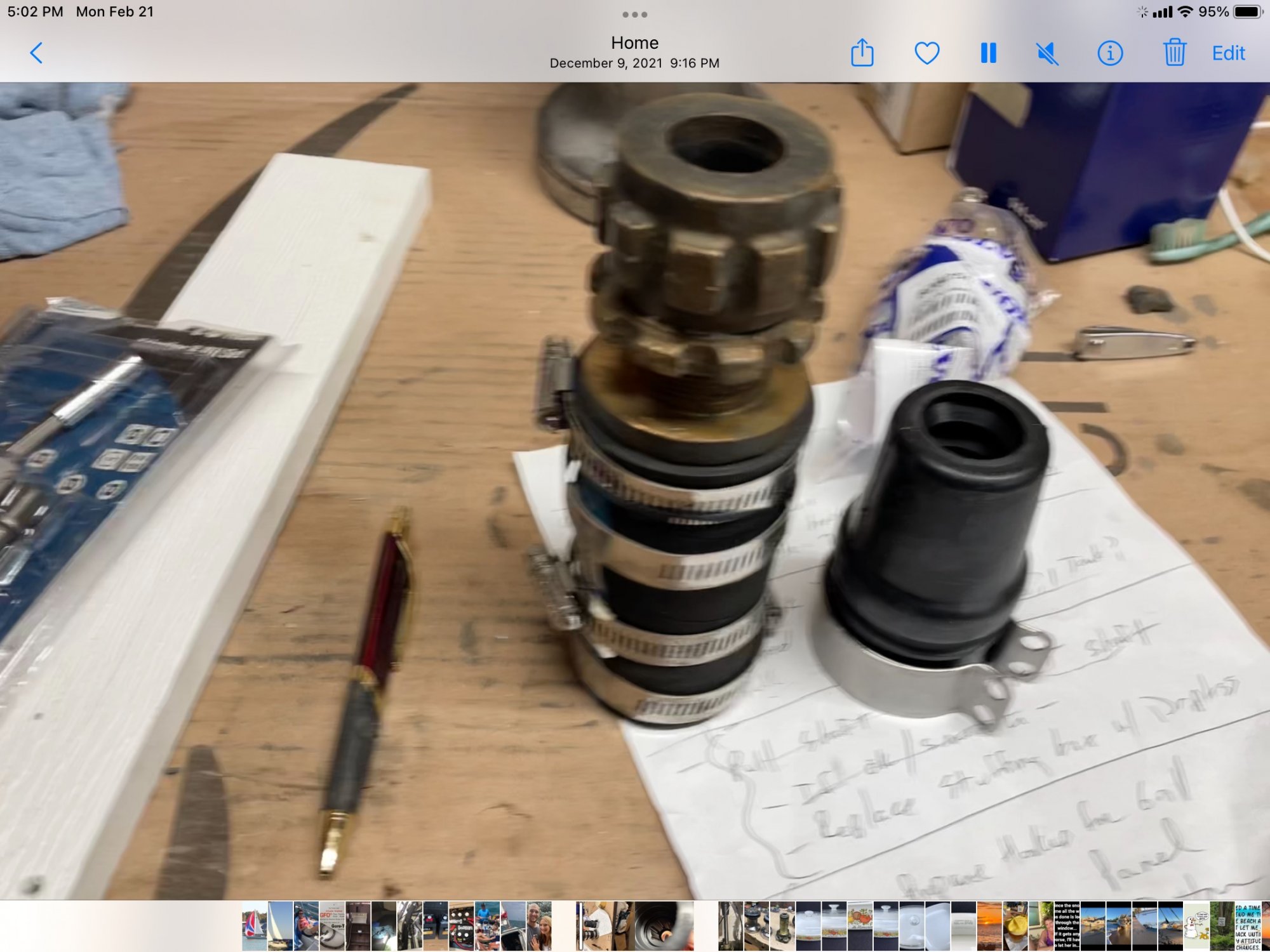

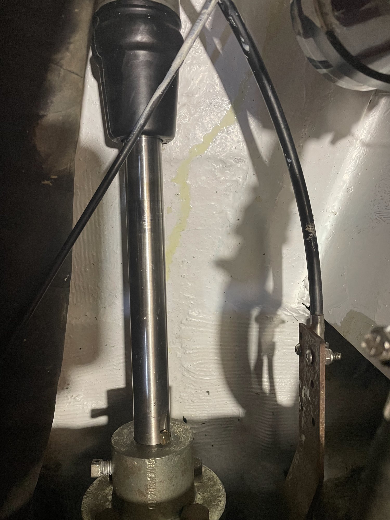

I added the Volvo dripless seal this spring before I launched.
Very simple design, rubber lip seal. No moving parts, my bilge is dry as a bone.
As was mentioned, you grease it every season, between the 2 lip seals. You “purge“ air out of the seal by giving it a little squeeze once in a while…certainly after launch, but also if you reverse hard and it can force air into the shaft log. On my boat, hard reverse will blow air bubbles up into shaft log, so give the seal a little squeeze when I open the water intake thru hull.
My runs cool…much cooler than old stuffing box.
It was also a lot shorter than my old stuffing box, and gave me space in the bilge area behind the engine.
