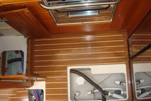

You are correct, it appears that's what was done at the factory, since my 2006 45 CC was the first model year for that boat. I would be interested if Hunter discovered the problem and have since corrected it in later models. The photo's that I took pretty much show just how hard it is wedged in there. Again thanks for your reply.

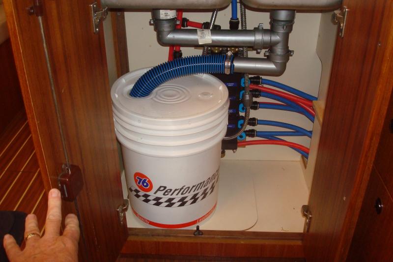

Temporary Fix
All,
Not wanting to miss a chance for a long weekend at Catalina with great weather, I came up with a temporary fix. (See photo).
In answer to the most recent posts, yes I contacted Hunter, and would rather not discuss that in this forum. But as you can tell by my asking all of you for help and some ideas...well you get the idea. Still not sure about the floring, as under the laminate is the fiberglass pan, which would also have to be cut. Oh well my problem is not imposible to fix, it's just dam hard, and frustrating. Thanks to all of you for your support and ideas.
