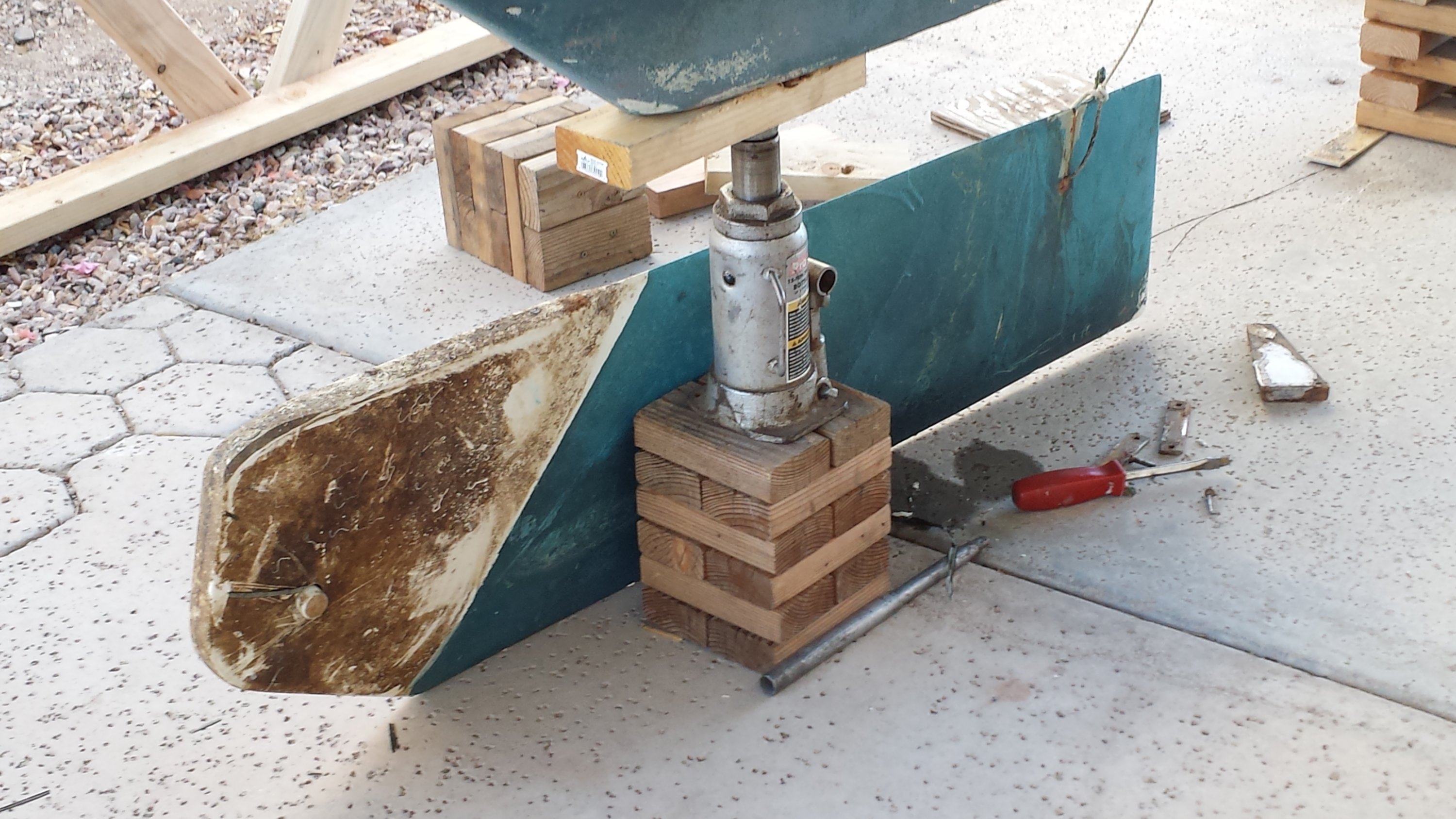

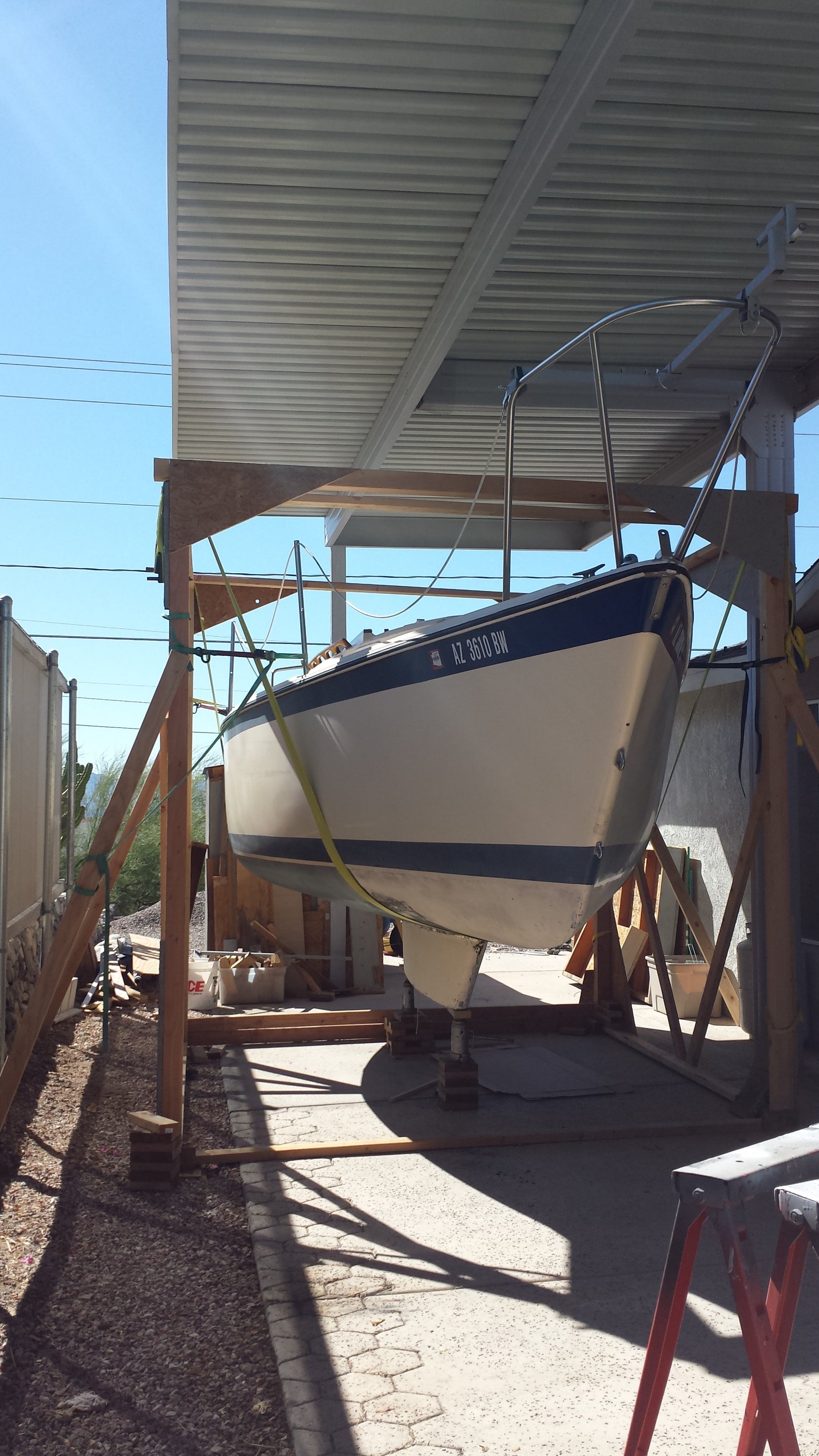

Apr 26, 2015
663
S2 26 Mid On Trailer
I have only been on a 25 one time for a beer 30 years ago so did not pay much attention to the centerboard line. If it is like the 23 there is a plastic trim/fairlead sticking in the top of the tube where the line exits. This is removable and allows enough room to slide a rod in beside the line. No conduit tube cutting required.
One issue I found that was causing the most problem for me was a groove that the original steel cable had cut into the fiberglass where the conduit enters the top of the centerboard well. My replacement line (5/16 Staset) would get hung in this groove and not function properly. I re-lined the conduit with a plastic tube when I epoxied the bottom and had the CB outView attachment 129555 20151007_110458.jpg
