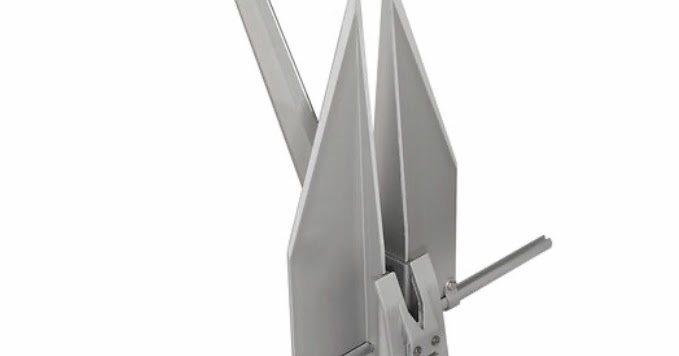

One possibility is the anchor design. That big flukes anchor likes to lodge on things in the water.
You talked about your process of dropping the anchor, Perhaps grabbing the chain and pulling it out from the anchor roller and onto the deck, then attaching the anchor might be a way to solve your issue of leaning out over the water with the anchor in hand.
Mantus makes a nice small anchor with good holding power and light of weight. I have been using there 35lb anchor with chain rode on my boat and this last week it held as we experienced 30 kt plus winds.
It sounds like your anchoring activities are short stops. A small anchor should be a good solution. You might even try a heave lead ball fishing weight if temporary hold is all you need. They tend to be easy to retrieve.
