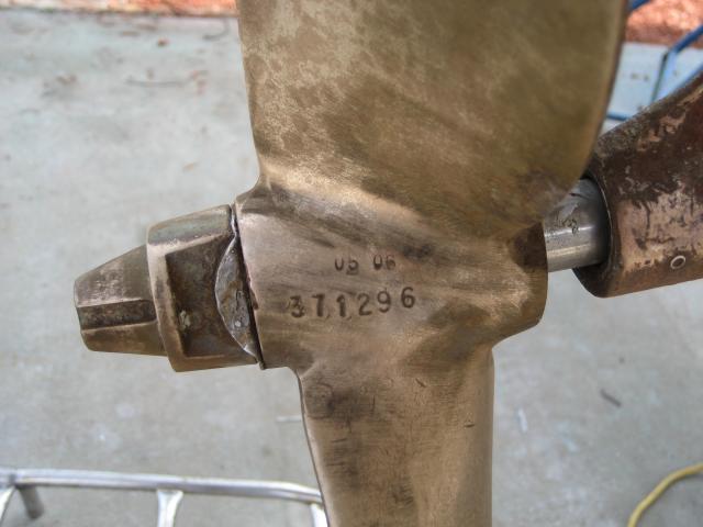

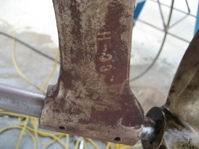

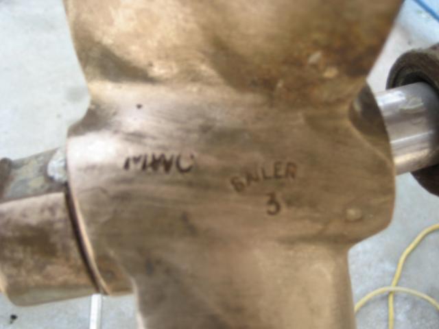

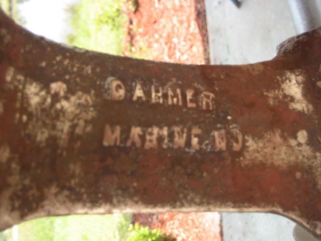

Here are pictures on my strut from my 1979 H37. Dahmer marine has it listed at the bottom of their strut page as the H33 strut. Hope this helps.

Tom;
The new strut you receieve from Dahmer, while it may look the same, will be far from identical. They are hand made from ancient molds. You MUST align the strut and shaft to the stern tube. Then you can align the engine to the shaft. If you want further information let me know. I can run you through the method I used.
