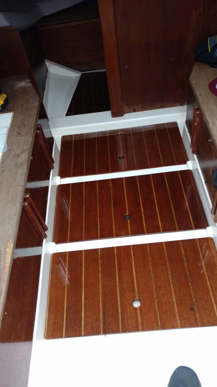

I was on the boat this evening. The boat is in the shop so no rain or other moisture. I dried out everything on Friday when I worked on the boat. Today there was some water in bilge area where the keel bolts are. Where could this come from?
Have you looked under the anchor locker for water. In the little cubby front of the v-berth. Maybe from there.

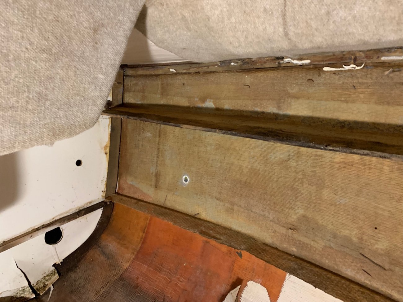

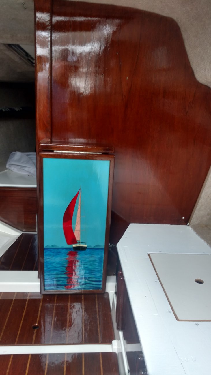

Couple more. Maybe this will help

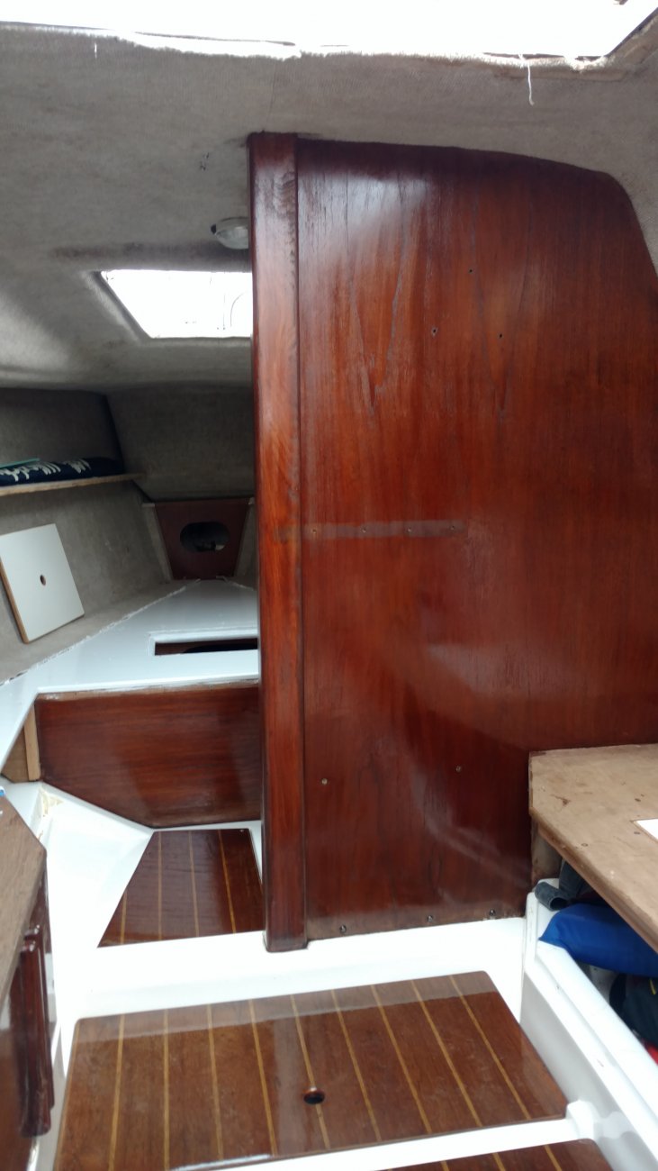

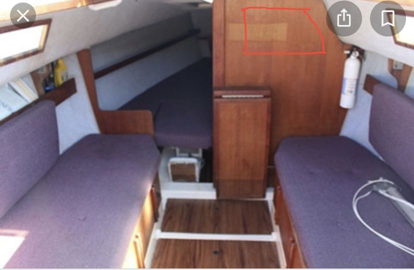

Hey Guys,
Im planning on opening up the V-berth wall to add air flow and light to the V-Berth.
Ill be cutting only half of it open (avoiding the mast post).
What do you think?
Thanks,
James
10,531
-na -NA Anywhere USA
@JBissi
that bulkhead is considered a structural piece to support the deck and mast step. I urge you not to cut anything out of it. As a former dealer, I was Hunter’s too dealer for that boat and in later years helped in the designs of many of thier trailerable sailboats.
