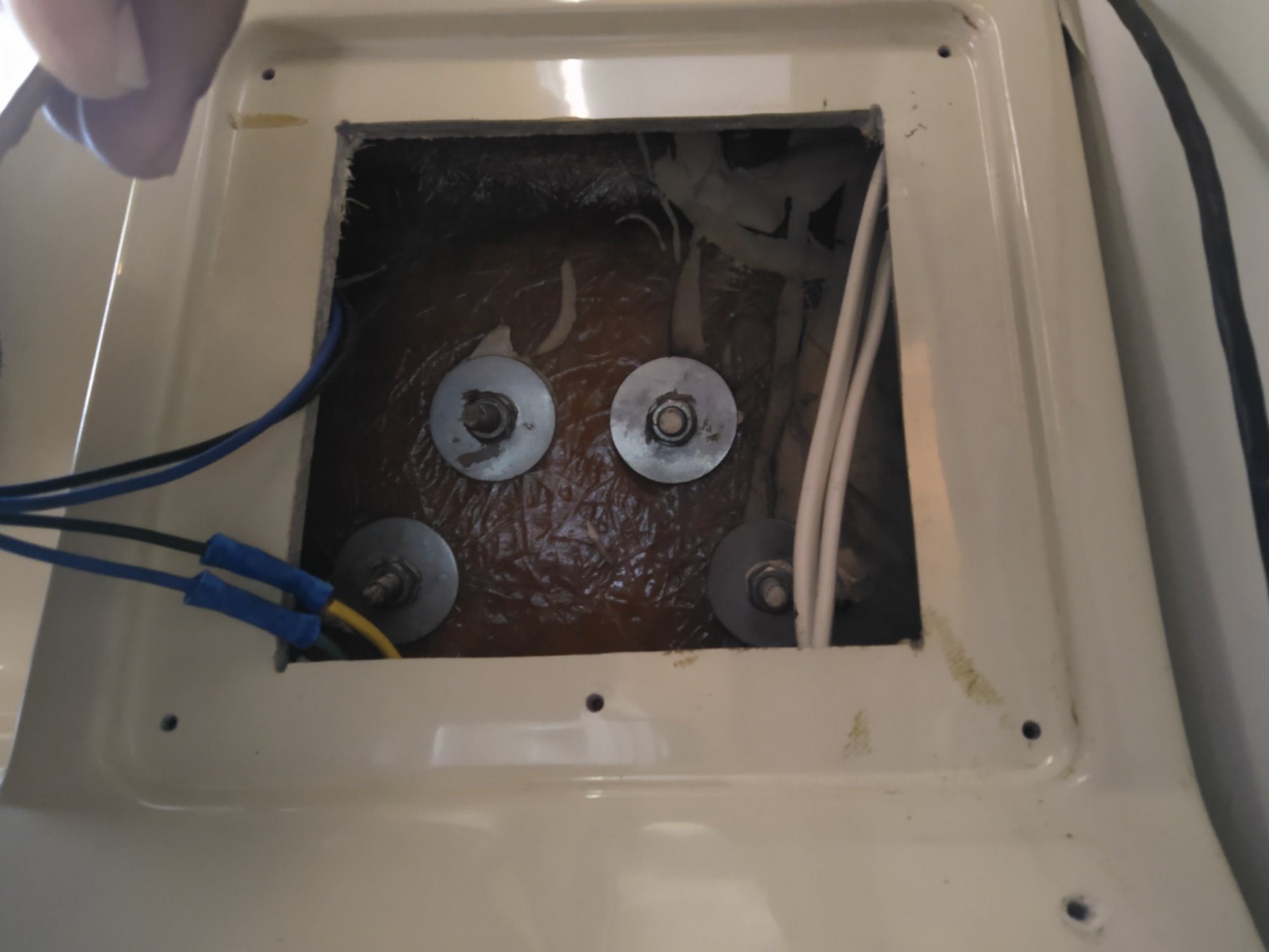

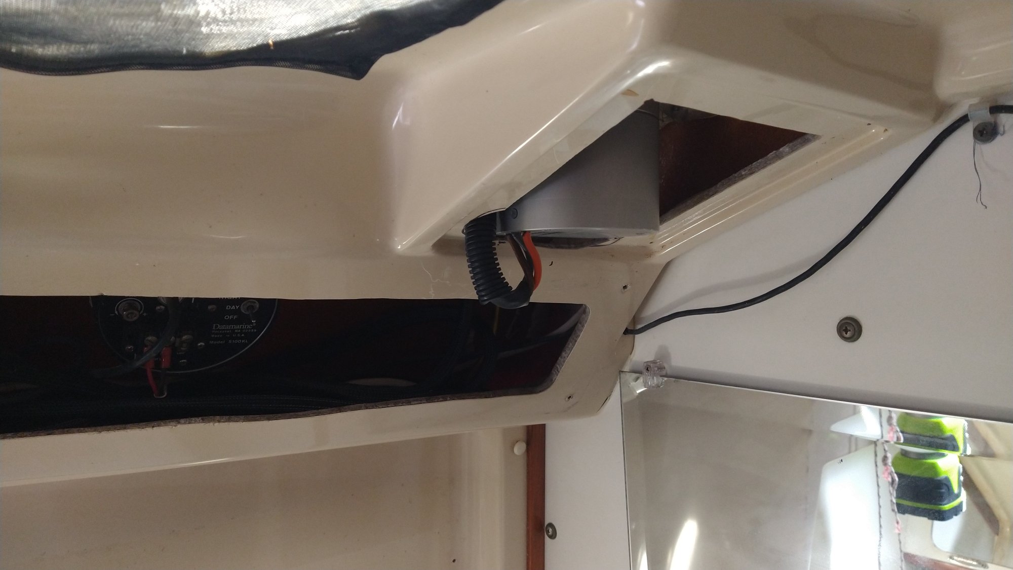

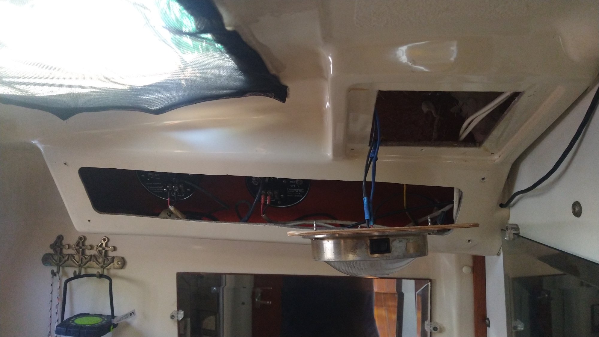

I recently replaced the primary winch (starboard coach top) on my Vision 32. These are through-bolted and you can access the nuts & washers from inside the head. They're behind/above a light fixture and the instruments panel.
With those two panels removed, you'll see the nuts and washers that hold the winch down.
Shouldn't require service of a machine shop - just need to wrestle out the screw(s) and replace them. BTW: You can see that the washers here are rather light and have deformed a bit. That's likely to result in loosening of the winch (loose wenches are in a completely different forum) over time. You'd do well to replace with heavy duty washers or multiples of the normal kind. Also, there was a lot of squeeze-out of some kind of white bonding compound from the factory. That stuff presented an uneven surface for the washer and nut to press against. I used a dremel to cut and grind away excess, leaving me a flat face for better seating of my new washers.
FWIW, I upgraded to a Selden 40e, which required some cutting of the ceiling in the head to accommodate the motor. I will eventually make a wooden wedge to enclose this. I'll ditch that old dome light and replace with some other, small fixture once I've made the new enclosure.
