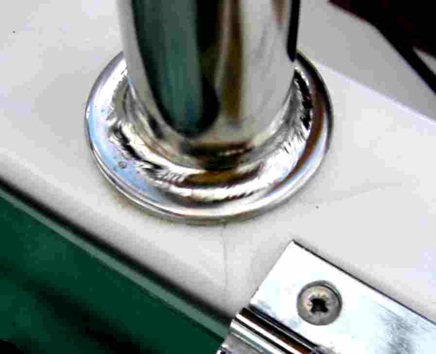

Stuart, I bought in France a 361 in October 2000 and brought it to the USA soon after commissioning. I know that the French warranty should last for 3 years after commissioning if one follows the instructions on the "Contrat de Plaisance" that you must have received from the French dealer you bought the boat from. (Who was it?) Although the contract specifically excludes gel-coat fissures or cracks, it sounds from your description of both cracks that there is a serious manufacturer's defect that should be covered by the warranty. I can't imagine that you can expect such type of cracks in a 2 year old boat. My boat developed stress cracks (see photo) on the instruments binnacle the first year that I reported to the USA Beneteau representative. The cracks were repaired once, at Beneteau's expense but re-appeared in less than a month. After sending electronic photos to Beneteau France, I received a new binnacle from them although they refused to pay for the labor of changing it. To date the cracks have stabilized and I decided to keep the new binnacle until the time take pictures of the cracks, and even better, a movie of the sound the head floor makes and send it to the local dealer and to the dealer that sold you the boat in France explaining them that they developed soon after you bought it but have become worse with time. Although this late you may not get all, they mayI need to replace instruments or the cracks become intolerable. Since you should still be under the 3 year warranty, I would recommend that you do something for you. Personally, I had very good response from the USA warranty representative in 3 different warranty issues that my boat had, including one on the end of the third year. Good luck Jose
