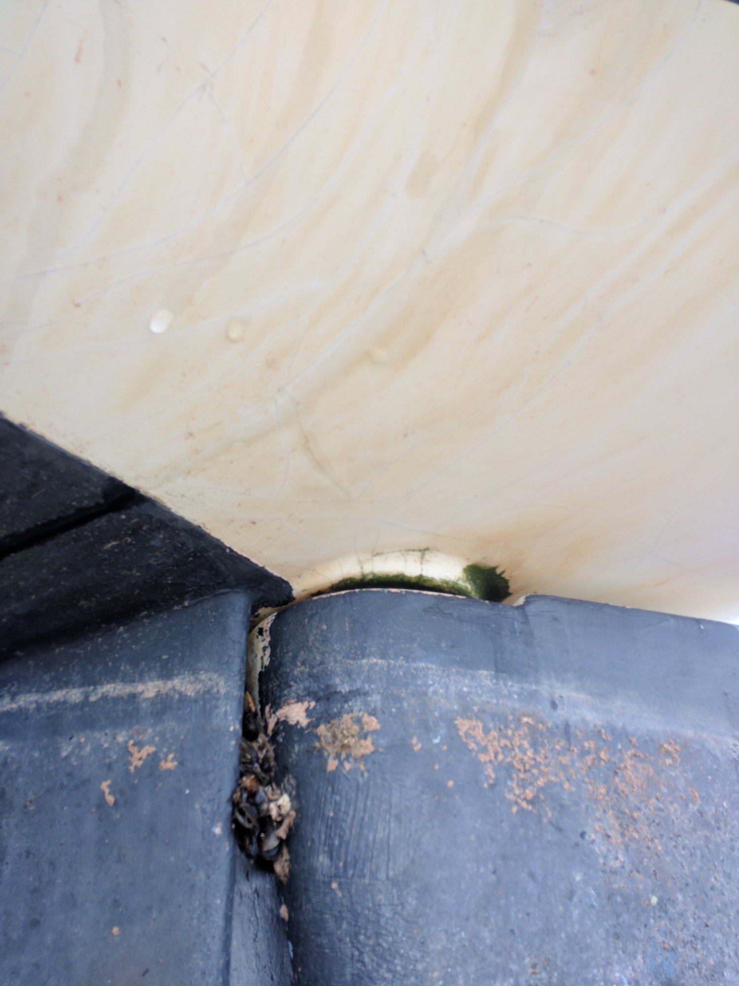

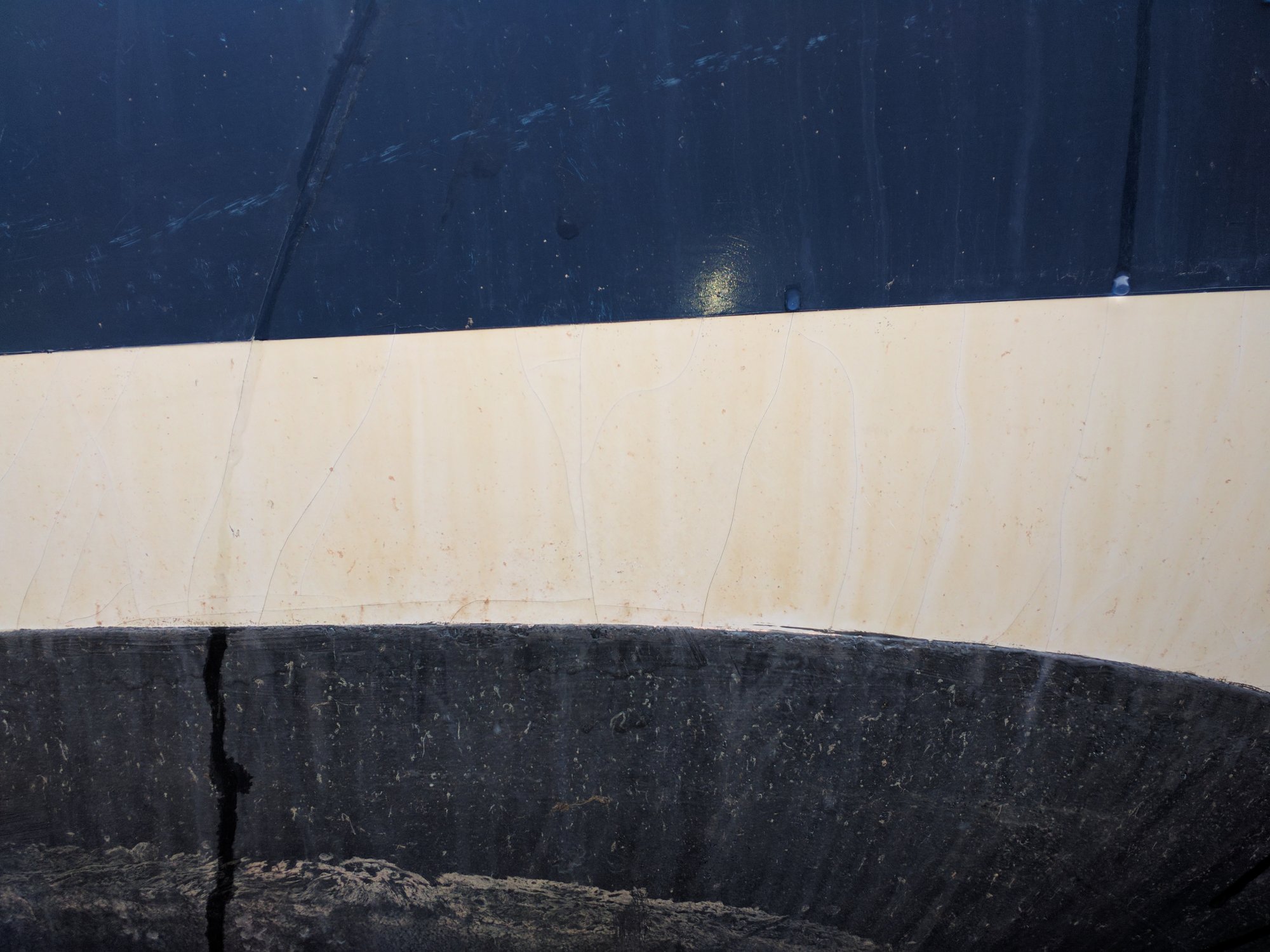

Hi All,
Long time listener, first time poster. I'm currently looking at purchasing a 1985 Beneteau First 375 (asking is 32k CAD) and recently did a walk around with the surveryor. One potentially major issue was the presence of what appear to be stress cracks all along the hull just under the waterline and also around the rudder. Surveyor hadn't really seen that before and couldn't conclude its cause (see attached photos). The vessel has never run aground or struck anything to my knowledge. Wondering is anyone has seen this type of damage before and if they found it to be more cosmetic or an indicator of more serious structural issues.
Thanks for the insights!

Stress cracks (if that is what they are called) happen because the boat has experienced some stress. This can come in many forms, grounding is one of the usual suspects. Added to the list are sailing the boat to her limits, bashing into a dock, being in a violent storm, surviving extreme temperatures.
When deciding to purchase a mature boat, I consider all of the above and then examine the boat to identify if the possibilities create a risk to the boats survival in the waters I plan to explore. Is there greater damage hidden inside the boat from the surface blemishes seen on the outside.
There is no general rule that stress cracks on the outside of a 37 year old boat mean it is going to sink in the next year. On the other hand if inspecting the inside of the hull you find evidence of a leak or fractured supports/frames then the external symptoms were a lead to the internal damage.
The cracks around the rudder tube may be just age, or it may be from high stress put on the rudder by a previous owner. Inspection of the rudder systems is warranted to rule out any issues.

Thanks for the comments thus far. Its true, I can't speak to the past history wrt to impacts or groundings. Closer inspection doesn't show evidence of delam from the underlying fiberglass and looking into the bilge, there is no cracking visible or anything afoul with the stringers. Keel bolts are in fair condition with more rust than I'd like to see - so obviously meticulous bilge cleaning was not on "to-do" roster for some time and they were in contact with water, sea water or otherwise. Many have suggested this is stress occurring from resting in the cradle, and indeed the boat has been used sparingly for the last several years, and the cracking is only as deep as the gelcoat and cosmetic as many like to say. I've got the seller to come down a fair amount in price to reflect these problems, which is a start - obviously the boat is worth zero it sinks to the bottom, but it seems few can say with 100% certainty what the full story is. I'll let the fiberglass guy quote me a scary number for now and think on it a bit more.

Apparently those stress cracks in the gelcoat are a 'known Beneteau' thing.. our boat has them too, it's a '91. Pretty much cosmetic, I think, barring other obvious evidence of impact or collision.
You could spend a lot of money having someone 'fix' it..... or not...;)

I have the stress cracks too its a beneteau thing ,if gelcoat is applied too thick it will crack as long as there is no delam . My buddy owns the same boat we won a 50 mile race last year on it . That is very cheap for that boat in todays market especally in Canada the boat would be more the 40K to 55K range. He replaced his keel bolts first thing , I believe he had to cut to access some ,he also had rudder play, the fiberglass pocket wears not the bearing so replaciing the bearing may not give you results your looking for ,the pocket must be glassed to shrink bearing. His keel as is mine is cast ,we both had rust every year on haul out ,until we added teardrop anodes one each side of keel . That was 4 years ago neither of us has had rust since. Check the rudder for moisture very common. I believe your surveyor is way off the mark on price same boat in US is 35,000 which is 46,000 cdn and Canadian market is hot for sailboats my boat has gone up 20k then what I paid for it . My neighbor on dock paid 60 k for a 331 4 years ago and sold it in 2 days for 91k

Thanks Mechone, this is what'd heard and discovered through my research, but I'm most glad to hear firsthand experience from owners. Spoke to several fiberglass repair and they all said there's no delam and it would be a waste of money for the cosmetic repair.
