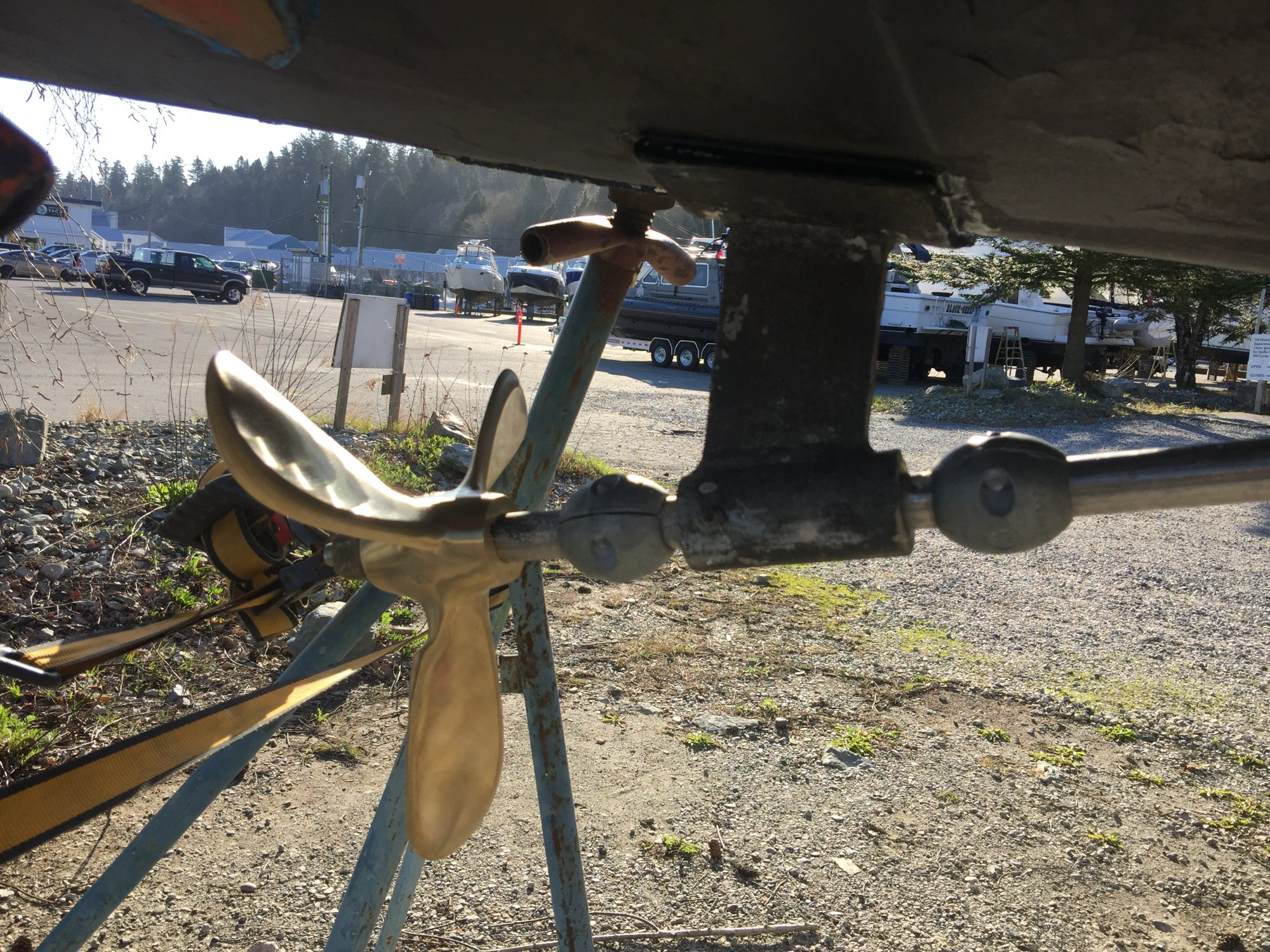

April 1st , I fitted some zincs to my prop shaft and put the boat in the water with a new prop. Previous owners had let their prop perish and was pinked and so replaced at that time.

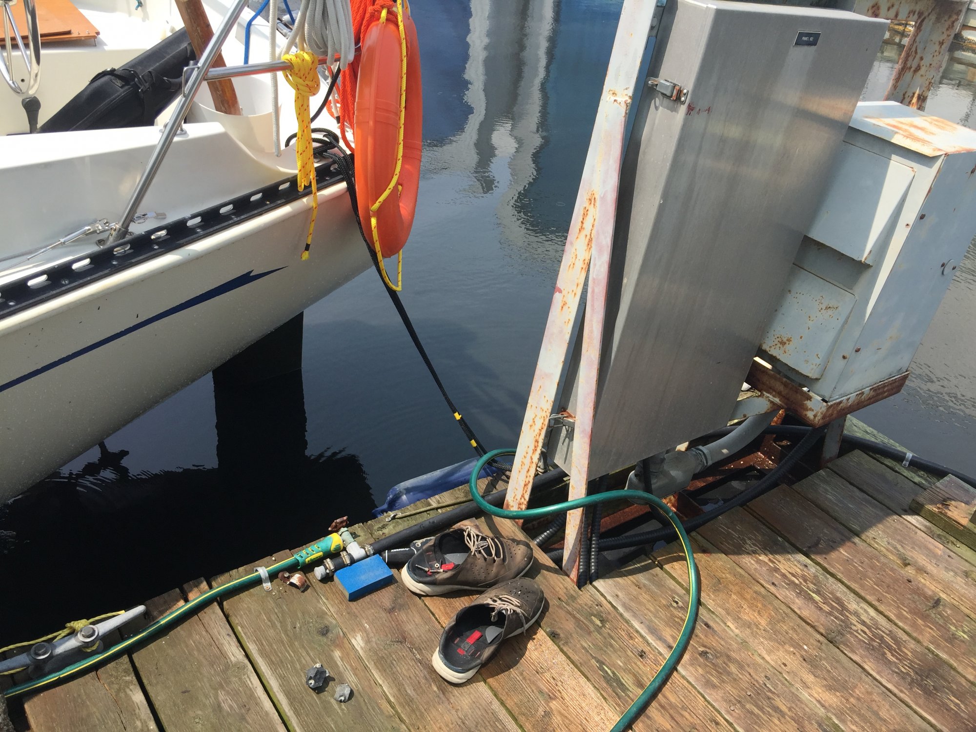

Early May, I fitted a galvanic isolator to protect against stray current especially as I am next to a distibution panel for a boat house .

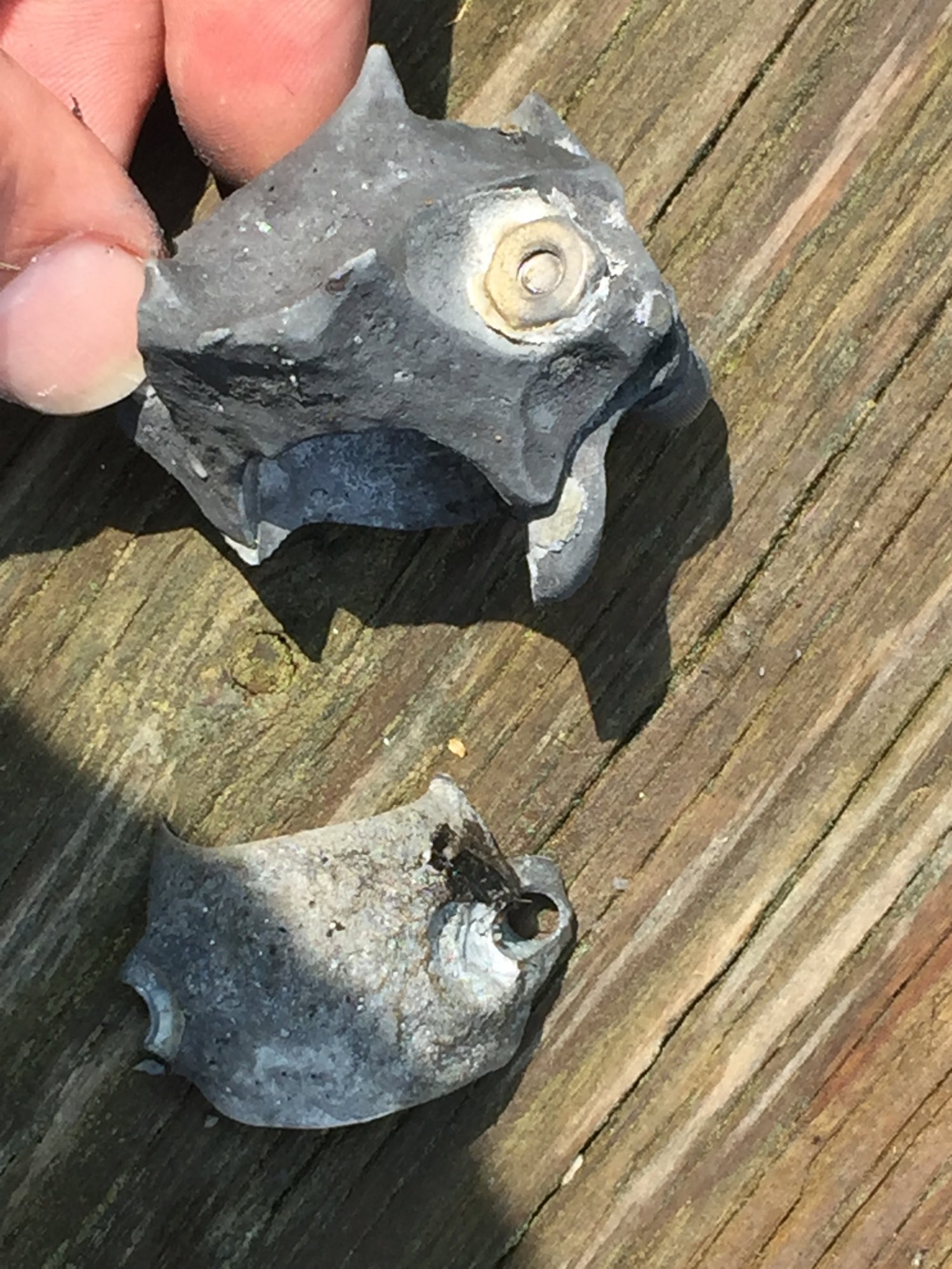

Early June my Zincs have all but fizzed away.

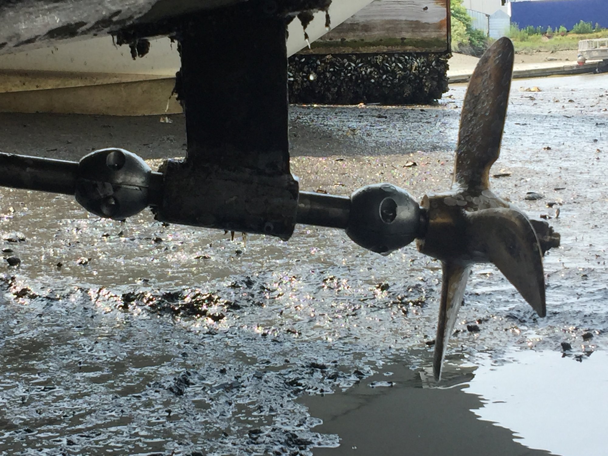

It seems incredibly aggressive corrosion given the short space of time (about 8 weeks) in the water - Maybe about 5 weeks or so between the boat being launched and the galvanic isolator being fitted. All underwater fittings are bonded.The prop was quite covered in barnacles as was the shaft - from what I understand , another indicator of galvanic current. Just wondering if this is more to do with stray current before I hooked up the isolator?

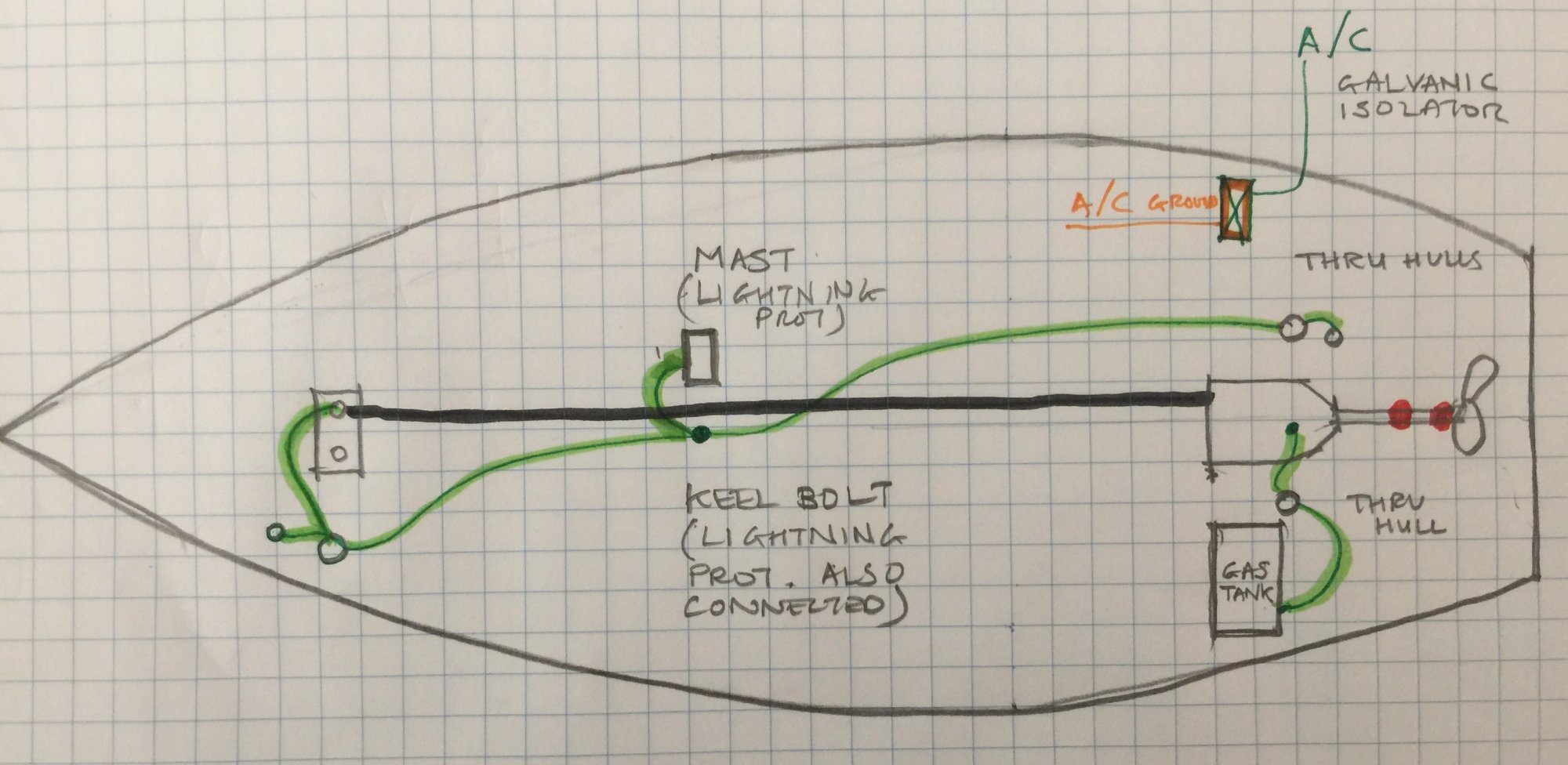

bonding system is currently wired to both keel bolt and engine block
Just an old wive's tale. Every so often I'll find the prop taken over by barnacles but I've never had problems with attacks on the zincs.
