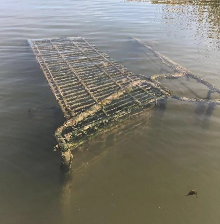

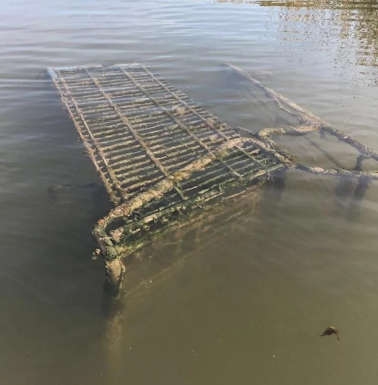

While visiting a marina in Scotland, I saw something like this just under the water at the back of a boat slip.
It looked like it had been there for a while and I wondered what effect it might have on the galvanic action of a boat that was backed into that slip. "I've been in this slip for ten years and never had a problem, but for the last two years, I just can't figure out what's changed!?":rolleyes:
-Will
Galvanic corrosion takes place when two dissimilar metals are in contact with each other while immersed in an electrolyte. Since the shopping cart is not in contact with any metal on any nearby boats, galvanic corrosion due to its presence is not going to be possible.
