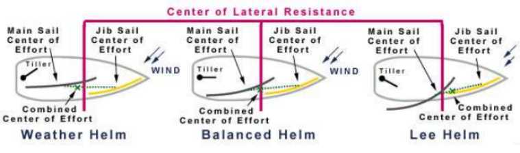

To answer your post 02/20 ( I hope) If there is weather helm on a yacht then the tiller should at least move to windward. The more aft the top of the mast is the more helm you have. If the mast is too far forward then the opposite happens. Every time the rig is overpowered the tiller will want to point the yacht to leeward. When we are sailing in 5-10 knots of wind there is very little weather helm. Get to 10-15 and there is some. 15-20 there is quite a bit. 20-25 knots the reef is in and there is some helm. 25-30 knots and she is wanting to round up. 30 knots and we are on the way home. Its one of the features of most if not all yachts. Let go of the tiller or the wheel and she should round up.
