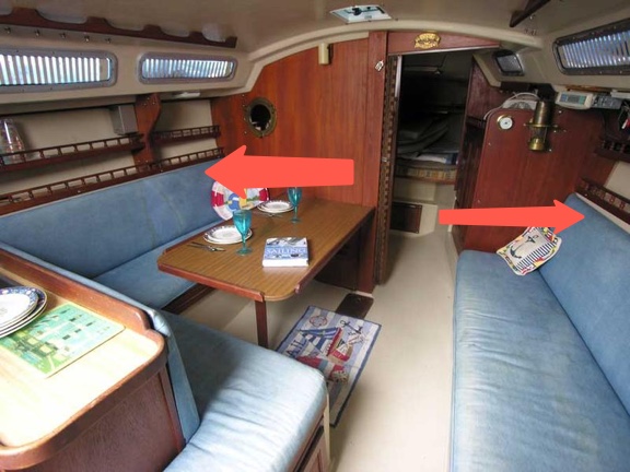

It is between the mahogany piece where the aft shrouds connect (I called it a bulkhead because I think technically it is) and the main bulkhead where the middle shrouds connect, behind the settee cushion between the hull and the cabin liner that the settee cushion rests on, precisely where the arrows point. It is hidden so a more detailed photo wouldn't help. I am convinced that it is stock fiberglassing.
Ahhh... It makes so much more sense now since I've looked at my boat. Yup. My boat has them too - under the entire length of the lowest shelf, behind the settee back. It's part of the liner, and I'd guess it's for stiffening the boat at those locations. No reason to be there if they don't serve a structural purpose. On my boat it appears that the liner is affixed to the hull right above this mystery fiberglass thing.

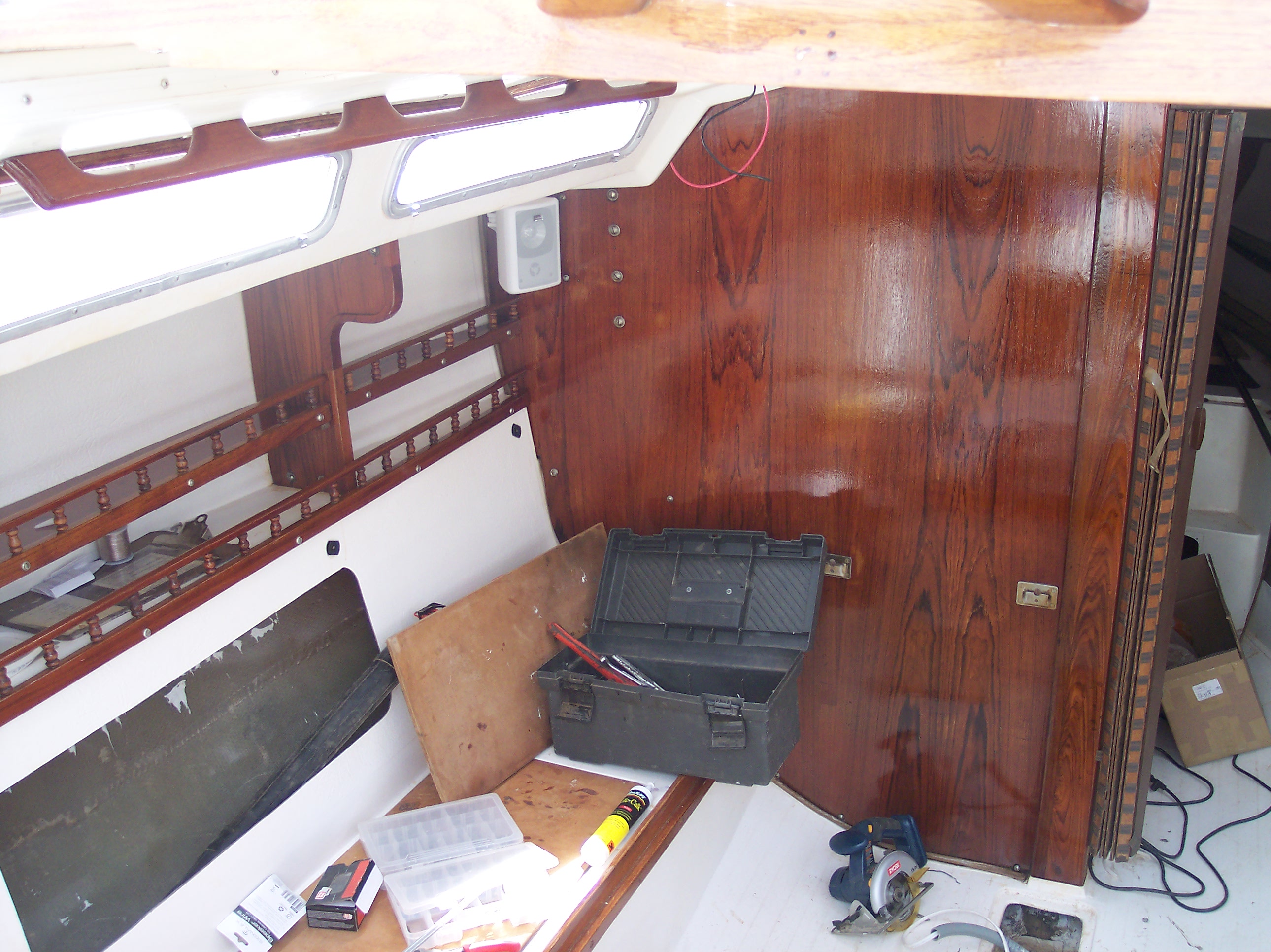

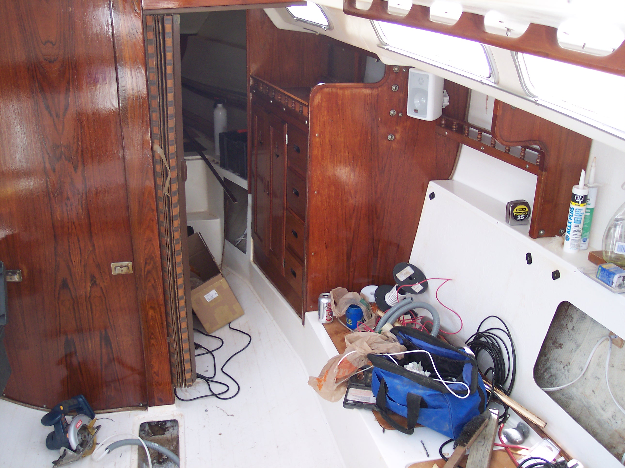

Are these what you're talking about. The fiberglass backing that the cushions rest against? There is nothing behind mine, these holes were either there or were cut by original owner. Boat is a 1977 C-30, so I don't know if that was standard. They are useful for storage.
No. Later boats (mine is a 1980) have those storage areas a bit more refined - i.e. the liner was fashioned in such a way to create actual storage locations and the holes to get inside have trim around the lip. The rear is the hull though. What was being discussed is that if you reach into the area behind the settee and then reach UP, you'll notice that what you find is NOT the underside of the lower shelf. There's fiberglass there creating a box shape. I'm guessing it's to give some structural support to the hull at that point - likely to prevent oilcanning.
