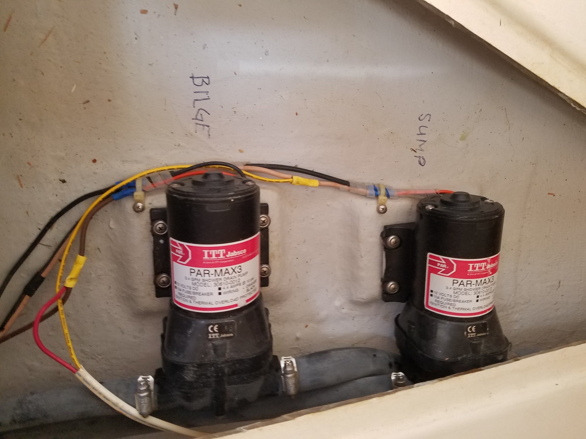

I have two ITT-Jabsco Par-Max3 pumps, one for the bilge and the other for the sump. (The sump is a plastic pan suspended above the bilge into which drain the shower and fridge.).
The really suck! They are self-priming, too. So, they can draw a vacuum on a strainer and eventually suck up the water. They are located close to the output, which is into a sea chest that exhaust at or slightly above the waterline.

More precisely, the bilge pump circuit starts with a pickup "foot" that has a non-return flapper in it. This is screwed to the bottom of the bilge. A smooth-bore hose runs from that to the input of a Jabsco Pumguard strainer. Then, a smooth-bore white hose runs to a union that connects it to a black rubber hose that runs to the pump. Then the pump has a hose to a seachest.
