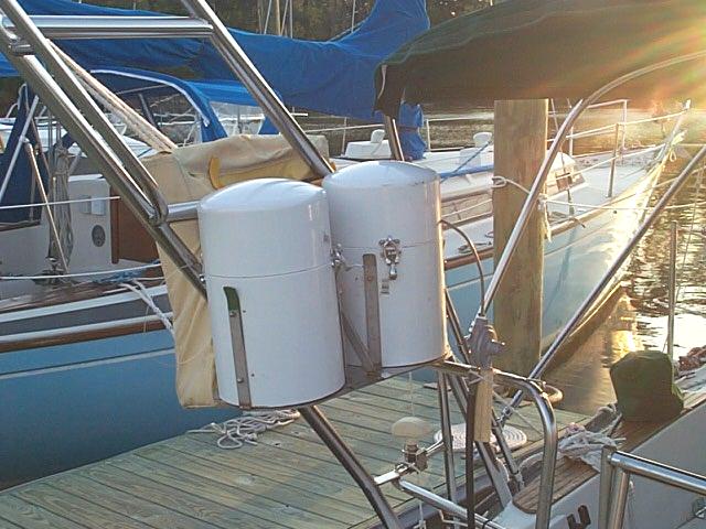

I just finished a conversion to propane from a drop in two burner alcohol...That was like trying to cook on sterno cans..can be done, but what a pain... We found a 2 burner Force 10, with oven at a Nautical fleamarket, for less than 400 bucks...Don't believe it had been lit twice...I went through the trouble of installing all of the appropriate shut offs, as per recomendations...The only item that isn't installed is a sniffer...(and now that I work for WM, that will be done soon..*G* ) I fabricated the lockers out of 8 inch PVC pipe couplings and caps...Not cheap, but cheaper than a locker....Had a local welder make a bracket for me, they are bolted to the backet, and then the bracket was u bolted to the aft rail...The locker has since been moved to a spot on the arch we just finsihed installing...Pictures to follow... email me and I'll be happy to go over any specifics with you....BUT, please do the job right..Propane is a sfe fuel, when handled right...I attened a fire fighter's school for prpane a long time ago, put on by the biggest propane insurance outfit in the world...and the old guy that wa the head instructor had one thing to say, "there is no safe distance" so, play by he rules nad all will be well...Coffe will be hot...Dinner will be tasty, and the bread will be warm... 73 Ed bt

Ed....
I'm intrigued by your photo. Is that an arch I see? I'd love to see more photos so I can get a grip on its orientation. Are we looking aft in the photo? I think that's your primary winch, no? The lockers are nice...did you make them, or are they available for sale somewhere? As I posted earlier in this thread, my 5-gal bottles are at the base of the mast. Like yours, out in the fresh air, but the cannisters are good looking....what size are they? Thanks. Dave

Propane lockers
They are located on an arch that we just had fabricated and Wendy and I installed...It incorperates; Dingy Davits, relocated the stern light to a high position, mounting for radar, wind generator, two 150 watt solar panels, and two work lights... Lockers for the propane bottle sit on a shelf that is u bolted to the inside of the port side of the arch...It is fabricated out of 2 couplings and an end cap for 8 inch PVC...Latches hold the tops on...There are three "stantions" that are welded to the shelf that surround the coupling and I used some stainless #10 machine screws and cap nuts to secure them. Email me for further pictures, etc...
