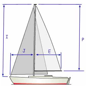

I am trying to find the measurements for a storm jib on the 1982-22' H sloop. Can you help me?
The definition of a storm is conditions with winds over 48 knots. There is a formula for a “storm sail” that is required equipment for offshore racers. It’s limited to a max area if 5% of I^2 . That’s a max of 36 sq feet for your boat. But I don’t think you want one for your boat.
You’re talking about a Hunter 22, which is a Small, trailerable, 22 foot boat. There isn’t any sail that’ll be helpful on a Hunter 22 in an actual storm. Your best hope is bare poles and an anchor, or trailing warps in that much wind. Or Better yet, never go out if there’s a chance of a storm.
Maybe you mean a heavy air jib? For Force 7, “near gale” conditions up to 30 kts? Or for sailing in Small Craft Warnings, typically for winds up to 15 or 21 kts depending on local average wind?
so, let’s start again, please. For use in what conditions? Please define the wind rand sea conditions you’d use it in.
your boat has a fixed keel, right? for a heavy air jib, I’d recommend something with luff about 65-85% of I, an LP of 70-80% of J, with a fairly high clew. With an Area somewhere between approx 60 - 98 sf. The exact specifics depend on how the boat is currently rigged and how much wind you think you can keep sailing In.
I assume you have hanks on your existing jib, so I’d recommend hanks on a heavy air jib for your Hunter 22:.
And 6 - 7 oz dacron, depending on the weave. Maybe something like Contender Supercruise 6.4 or Challenge 6.53 or similar.
