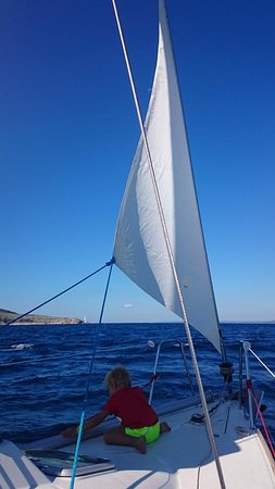

I have never had this sail up, probably a total novice question it’s the storm jib it had a length of cable to make it haul higher on forstay is this correct picture with and without?

pendant on top attached to the head of the sail. keep your center of effort of the sail low for less heeling forces. my $0.02
May 25, 2012
4,338
if it were built to fly high there would be a hank next to the tack

Thanks that’s what I thought too but didn’t know why it was rigged that way

There are two reasons why you might want to have the tack raised off the deck.
1. Generally speaking, keeping the tack above the deck will allow any large waves to pass under the foot of the sail rather than getting caught by the sail. In your case, the tack is pretty high and I doubt you'll be sailing in conditions with 8 foot high waves breaking on your deck.
2. Raising the tack might get you a proper sheet lead to your existing genoa lead car. With a low tack you might have to install a dedicated block or extend the genoa track for your storm sail if your genoa track does not go far enough forward.
+2 for both of Jon Hansen's comment regarding having a hank at the tack and lowering the center of effort of the headsail.
Joe
Jun 1, 2004
8,110
First of all, I'm not entirely convinced that is a real storm jib... most have a very heavy cloth, triple stitching .... It could just be a 80/90 percent working jib that the p.o. wanted to use as a "jib top" or "yankee" by going full hoist (except that would be unusual on a small trailerable production boat.
It could simply be a sail he was given, or got a good deal on, and just wanted to use it without installing new or adjustable fairleads.
That said, I'm not sure why you would put a pendant between the halyard and the headboard for tacking it at deck level. Is the halyard too short for that?
Maybe the previous owner simply wanted to get the sail clear of the lifelines even though the clew is cut high enough, or had a dinghy on the foredeck... who knows.
I would suggest adjusting the sail hoist to match the proper sheet angle to the fairlead... then build another pendant to fit .... then you have the correct hoist for the lead position.... or... install another set of fairleads.
Bisect the angle at the clew made by the foot and leech to get your neutral sheet lead angle.
Use the sail on windy days or when you're single handing and don't feel like messing with a genoa. Play around with it, with or without the pendant, and see what works best for you... maybe your question will answer itself when you try to use the sail.

Is it just me or does it look like Jimmy's mast is raked quite a bit forward???

I agree with Joe that it too light to be considered a "Storm jib." But in recreational sailing there is little to no need for such a sail. This is a jib that is undersized, probably from another smaller boat. My friend has a jib from a Lightning for his #3. It's a very useful sail for him. It practically tacks itself. And he can go out in windy conditions by himself. You might find your progress to windward better than expected with those easy tacks. Or you might spend some time tacking on 5 degree shifts which will sharpen your sense of shifts. And it could be fun.

one of my favorite sails. not a storm jib. about the same size as the OP's. great for driving to weather all day in a full breeze. because of its size it leaves the slot between it and the main open. the main has lots of power with less blanketing when the sails are all the way in for beating.

It looks that way in photo it was just the angle of camera boat is on trailer
10,295
thank you all for the advice given here to include lowering that sail with a lower jib pennant, adding a hank but most important rake that mast with a slight prebend back.
