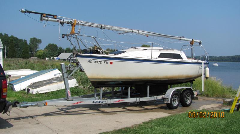

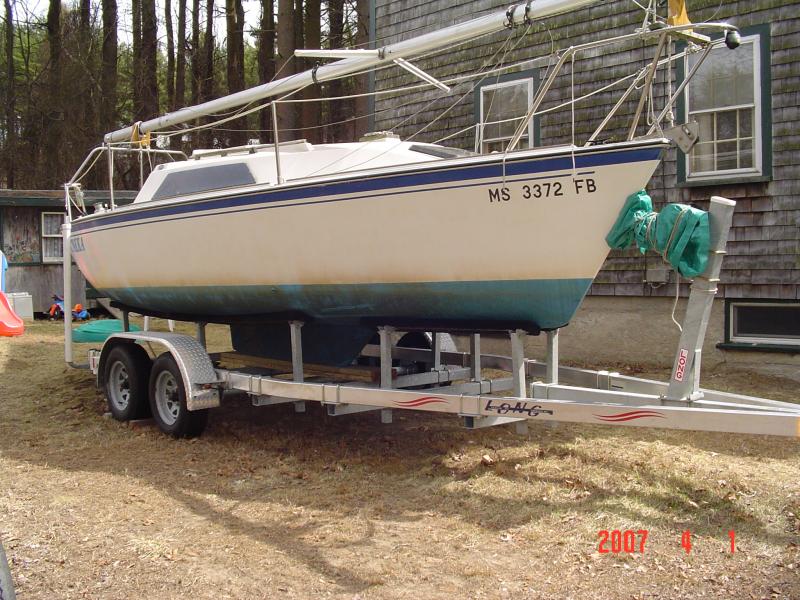

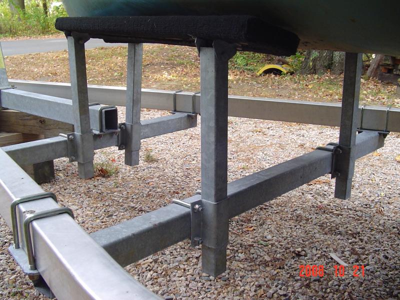

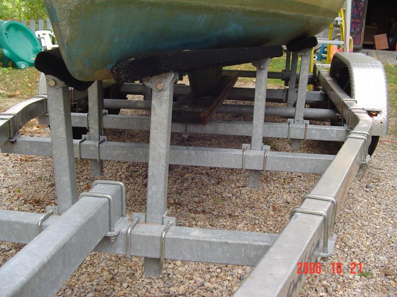

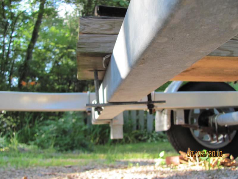

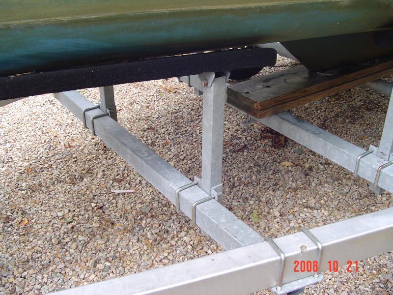

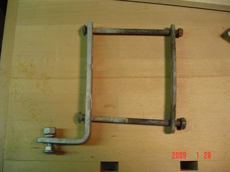

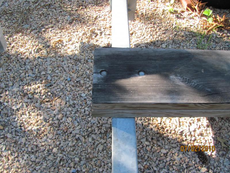

I bought these bunk extension brackets at Walmsley Marine in Warren RI. I'm pretty sure that Long Trailer Company manufactured them because my Long Trailer came with similar shorter length brackets when I bought it at Walmsley's and they had the 24" brackets which I needed, in stock.
Unfortunately Long Trailer Co. went out of business.
These bunk extension adjuster brackets are made 2"X2" square tube galvy steel and they are the best I've seen anywhere. As you can see in the pics.

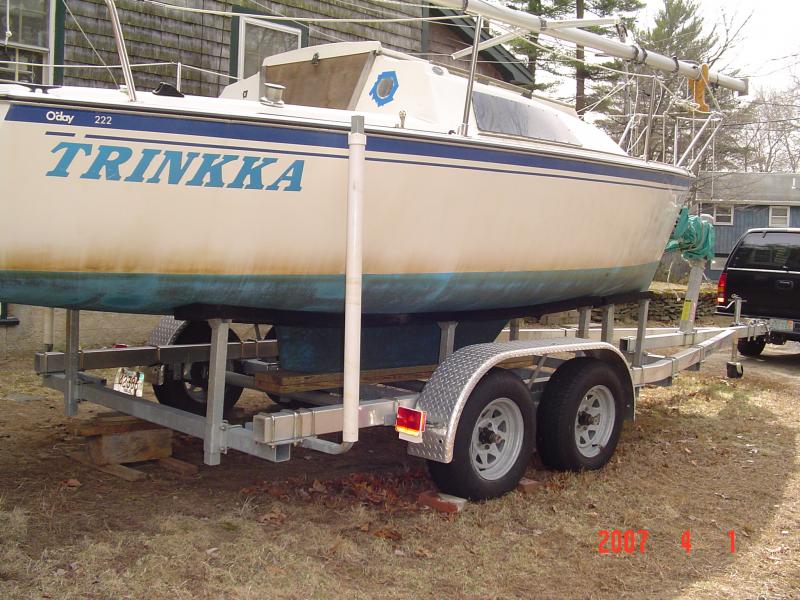

My O'Day 222 weighs in at under 3000 lbs and I was able to get a rough adjustment on the brackets so that I could load my boat on the trailer at the club ramp. The bottom of the keel was 1" to 2" up off the keel board after I pulled the trailer up the ramp.
I placed four of my Brownell's Mfg sailboat stands, two on each side of the stern plus a hydraulic jack under the bow, and lowered my boat so that the full weight of the boat's keel was on the sandwiched pressure treated planks.
Then I used two car jacks to raise the extension brackets on both sides of the trailer just enough to support the boat from side to side, along with a tape measure to get all the brackets even.
I used the boat stands and the jack to lower the boat on to the trailer, and before I go any further I just want everyone to know that I know quite well that boat stands weren't meant to do this but my stands can take the weight of my boat and I even raised the stern of my friend's O'Day 26 with four of my boat stands.
After I got the proper tongue weight for my trailer, I moved my winch stanchion to the proper place on the tongue and then I used the two car jacks again to raise the other extension brackets so that the bunk boards could conform to the curvature of the hull on both sides. It took less than an hour for me to adjust my trailer with the boat sitting on it.
Good Luck!
Joe

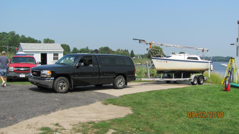

Actually, my trailer was built for a 23' powerboat. The trailer dealer told me that the trailer ought to be large enough to accommodate a boat one foot longer than mine(22') for easy launching. Consequently the trailer is longer and allows me to back down the ramp far and deep enough to float the boat on and off the trailer without swamping the towing vehicle. He was right.
If you look closely at the position of my winch stanchion you can see that it is mounted on the tongue, but inside of the trailer's "A" frame.
I just measured my trailer and it's 23' long.

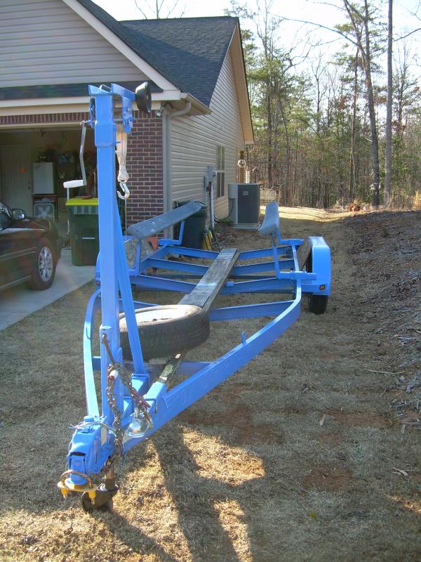

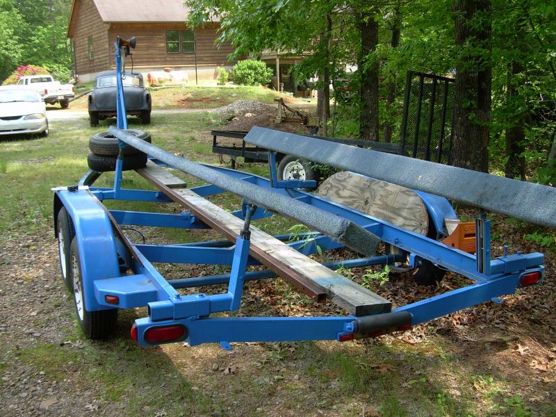

convert power trailer to sail

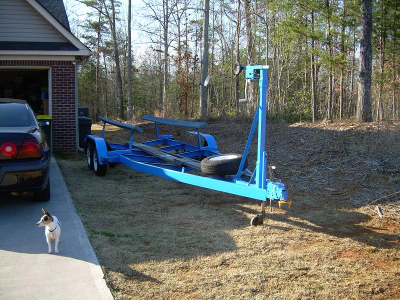

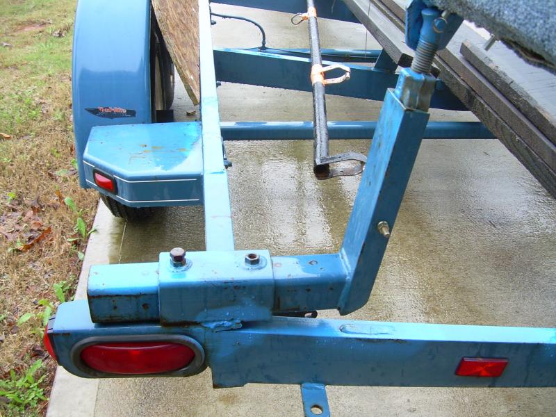

I converted a "TRAIL RITE" trailer ( see at www.trailrite.com ) standard series 22-T4 Tandem 6000# trailer. This was very easy because the vertical braces used for side guides were the main feature. Take these off and reinstall the 180 degress and now you have the uprights for the bunk boards (or the screw jacks; found at scaffolding companies). I have measurements and pictures that I think I posted on the ODAY 26 part of this web site under modifications. If you can not find the email me ay KDSSAIL@WINDSTREAM.NET and I will send you my info. I use this trailer on my 1985 Oday 26..Dave
