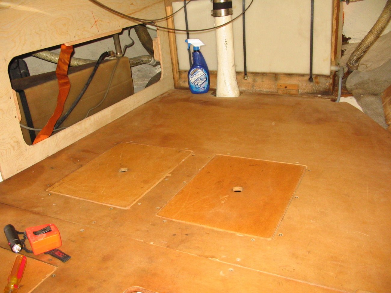

Does anyone store stuff directly on top of the fuel tank in the Hunter 34 starboard locker? PO built a platform over mine, but it's falling apart and limits access/height from the hole I cut in the port berth wall. Any idea of weight limit on tank? Concern about things sliding into hose or valves? Or is that what Hunter intended for the space?

Will get a pic in a month or so when cover comes off, but it is supported by upright outboard and ledge on berth wall inboard.

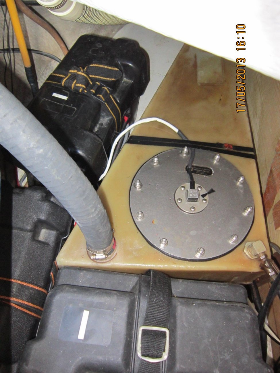

Not really a good idea as space would be limited and access difficult at best even if you did find a way to build a shelf above the tank. That shelf would have to be high enough and positioned to not create issues with fuel line & fuel tank hose (pic 01) located on forward end of tank, as well as fuel return line (pic 02) located at aft end of tank.

Claude, not to hijack my own thread, but in your pictures it looks like you have two batteries running fore and aft instead of athwartship? I thought that was a no no. Any issues?
Mar 26, 2011
3,751
Corsair F-24 MK I Deale, MD
Claude, not to hikack my own thread, but in your pictures it looks like you have two batteries running fore and aft instead of athwartship? I thought that was a no no. Any issues?
Good catch. A friend of mine with a mono had acid spill out sometimes (a traditional design that liked to be sailed on its ear), which tended to corrode the wire ends. I'm sure he had plates exposed, though he changed the installation before that caused any noticeable change (no solar, few loads under sail, so no current while exposed).
Dec 14, 2003
1,438
Indeed I do DA. When I bought the boat in 2000 it had 2 batteries, the one athwartship and adjacent to it a 2nd one fore and aft. I asked previous owner about it and he said no problems in the 7 years he had the boat. I added the 3rd one shortly after buying the boat and decided to put it in line with the 2nd one as it was the easiest place. As you probably noticed, they are well secured and inside battery boxes. Never had any acid spills even inside the boxes in all the years I've owned the boat. So no, no issues !
