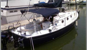

Suggest measuring to be sure.........determine where the pivotal mount location will be on each side, then measure the distance between these mounting points for width, then measure the desired height from the pivotal mounting point while standing inside the boat. As far as length, depends on how much of the cockpit and companionway you want to cover. In the photo below, this Compac 23's Bimini extends over the companionway and the mounts are located relatively far forward.
