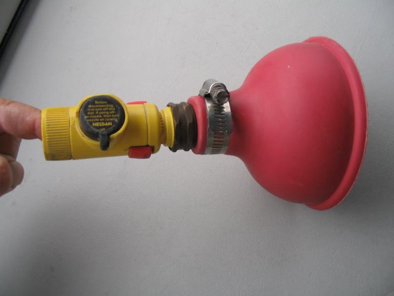

See my custom backflush devise for the tank vent.
