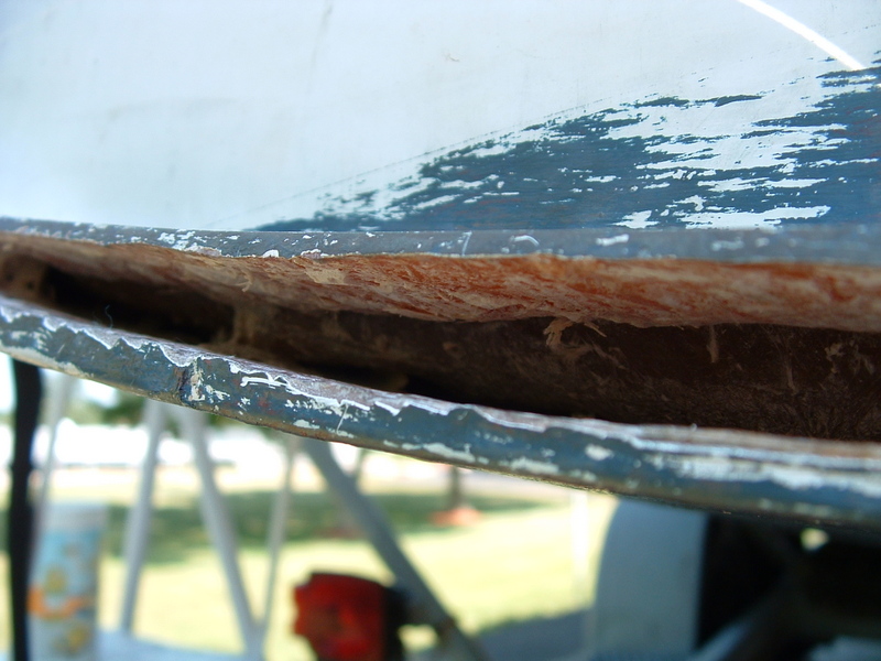

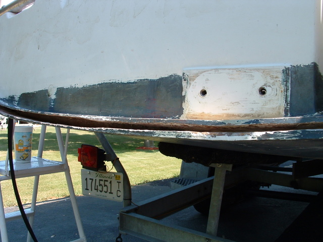

If you only get water in when sailing, then it may be the hull to deck joint in the stern. That's where my water came in and only while sailing, never from just sitting in the water. One would think if it was split as much as I note below that it would leak while sitting in the water, but it never did. I assume the stress while sailing opened the split more and allowed the water in.
The boat will have to be on the trailer to do this: Have someone inside the boat with a flashlight looking through the two holes in the stern berth bulkhead. The fiberglass is about 1/8 thick at the joint, thicker at the rudder. Take an air-compressor nozzle and placing it against the stern about an 1/8 in from the edge, walk it around the stern blowing into the boat. Walk it around the top deck edge and then the bottom hull edge. If it is leaking there, the person inside should see water spraying in.DSCF0064.JPG DSCF0062.JPG
The bonding material gets brittle and separates, I used a small narrow chisel because I was afraid something powered could get away from me and do some damage. I chipped all the material out until it got solid. Another advantage of doing it by hand is I could tell when the material was still good. This ended up to be around 4-5 feet if I recall. Not what I was hoping for when I started. I then used "bondo glass" to fill the area and then gel coat on the top. Still fine after about 10 years.
