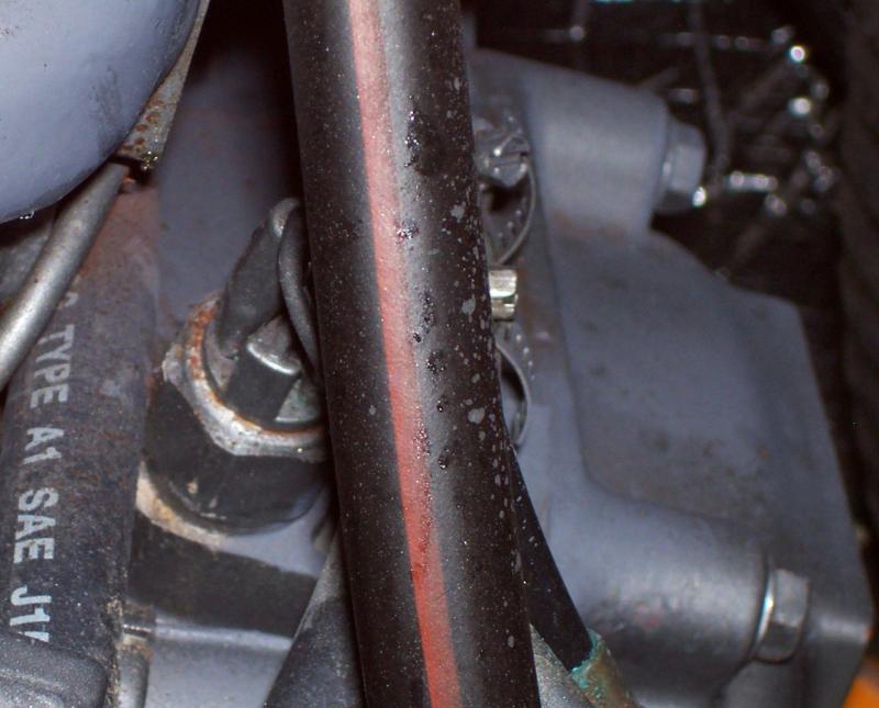

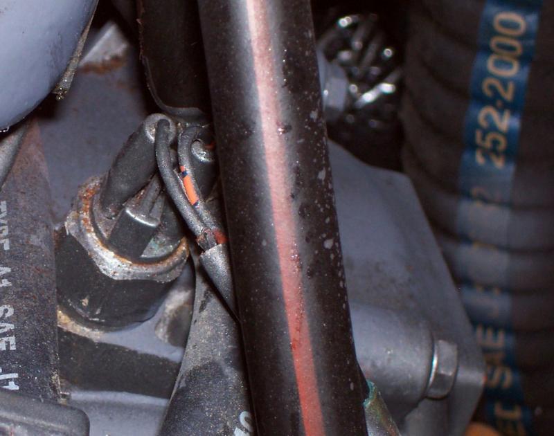

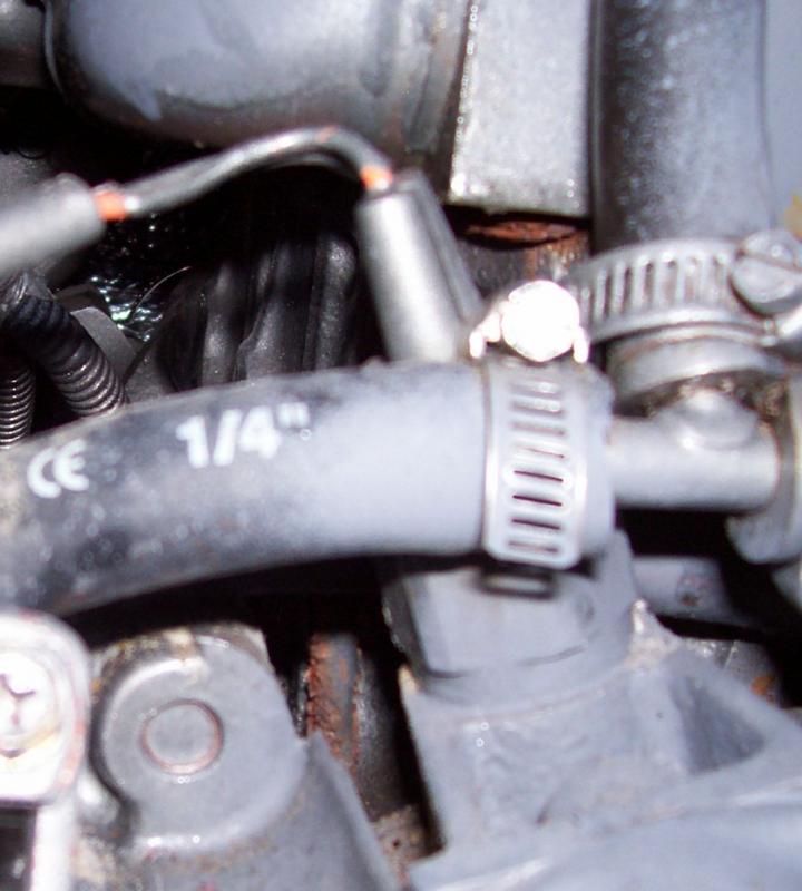

Try checking the sensor located on the top of the transmission bell housing.
It is a large nut with 2 wires on the top. You can remove the wires and clean the contacts with steel wool or emery cloth, clean both the contacts and the inside of the wire clips. Corrosion is usually the cause of erratic readings. Each time the
magnetic pickup sensor on the flywheel passes the sensor it reads it as RPM. Check for loose terminals also.
You can check the voltage on the wires on the back of the gauge - black is ground, red/black is 12v.
At the sender - should be 1.6 +/-0.1 KOhms.
I've include pictures of mine (2000 340 - Yanmar 3GM30F). Mine was the corrosion the voltage was just as above.
If it turns out to be the unit itself, it can be replaced for around $130 - $150
Hope this helps.
