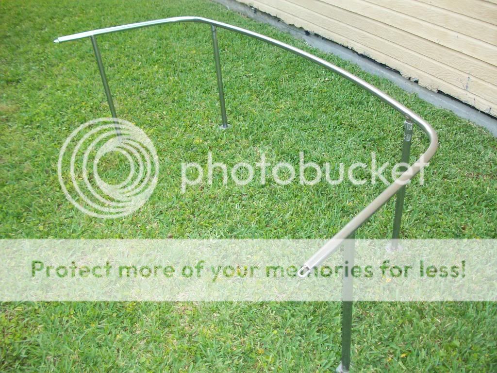

I have a stern rail I took off my 22, it interfered with the main sheet. It's in decent shape, no real rust spots but you can tell its used, would probably polish up nicely. I hate to just dump it so it's sitting in my driveway. I would give it away to anyone that wants it, the problem is finding someone that needs it and has a boat that matches its dimensions. Like I said, it's not a good fit for a 22 IMO, looked great but came just too far forward, it has the rail extended forward with eyelets to attach life lines and these caught on the main sheet, very annoying. If I actually had life lines it would prbably be ok, but even when I add them they will stop a the front of the cockpit.
anyway, i digress...
It stands 2' high, back legs are 4' apart, front are 6' apart, total front to back depth is 30", front to back laegs are abot 24".
Yours (or anyone else) is you want it. No idea how to ship such a thing, wrap it in paper and put a tag on it, I guess.

A good marine metal fabricator/welder could make the bends and necessary changes to that stern rail that would make it more user friendly. The front of the rail could be rounded off and stainless steel bales could be welded to it for the lifeline attachments.

I measured my stern today and their suggested measurements will not work at all. The back of my O23 has a cut out for an outboard. I need something more like the photo of the O22 sternrail above with about 4' between the rear rails.

For closure sake, the stern rail is gone - on it's way to bear62041, may it serve you well. I wrapped it in bubble warp, then wrapped that in cardboard I had cut into strips from a large box, all held together with plenty of tape - you should have seen the look the UPS lady gave me when I walked into the store carrying that thing - I almost knocked all their doo-dads off the counter trying to swing it around to get in the door. She had a heck of a time trying to figure out how to weight it, and then how to measure it. But they shipped it for a very reasonable amount with no problems.

And.....................it arrived in great shape, and will fit my Oday 222 perfectly as soon as I remove the original small side rails, fill their holes, grind the 2 aft round bases on the "new" stern rail to a rectangular shape so they will fit the narrow "deck" across the stern. My life lines are too long, but are shot, so I found a pair of almost new ones for sale on the forum. Now to find the time, and decent weather in the midwest to get everything installed. I'll submit pics when it is done. I thank you so much Ken !!!!

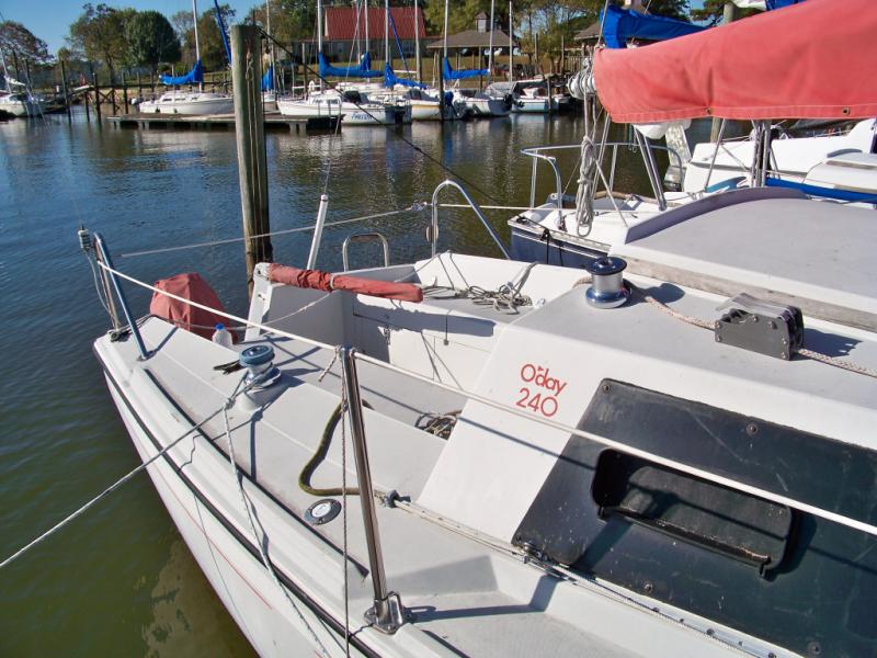

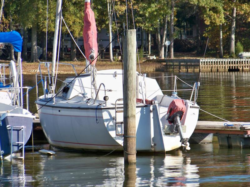

Is it cut out like this 240? If so maybe this picture will help. It may not. I can't see the pic very well while attaching it to this post. So please forgive if it does not show the stern rail very well.
Keith

It's on the port side rather than the starboard, but it's the same cutout.
I see you have two pieces at the corner and a lifeline strung between them. That's not really what I want. My whole motivation here is to get a nav light in the rear high enough that the outboard won't obscure it when raised on its bracket.
