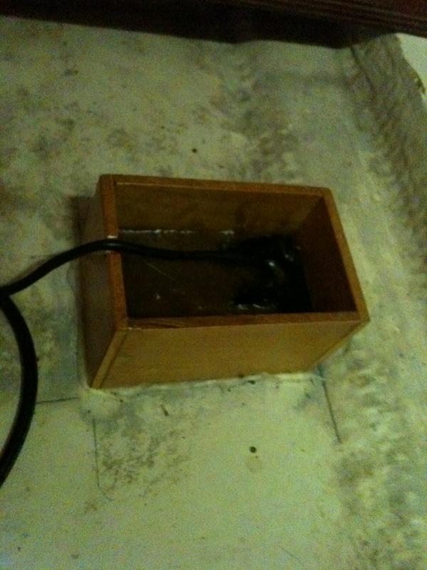

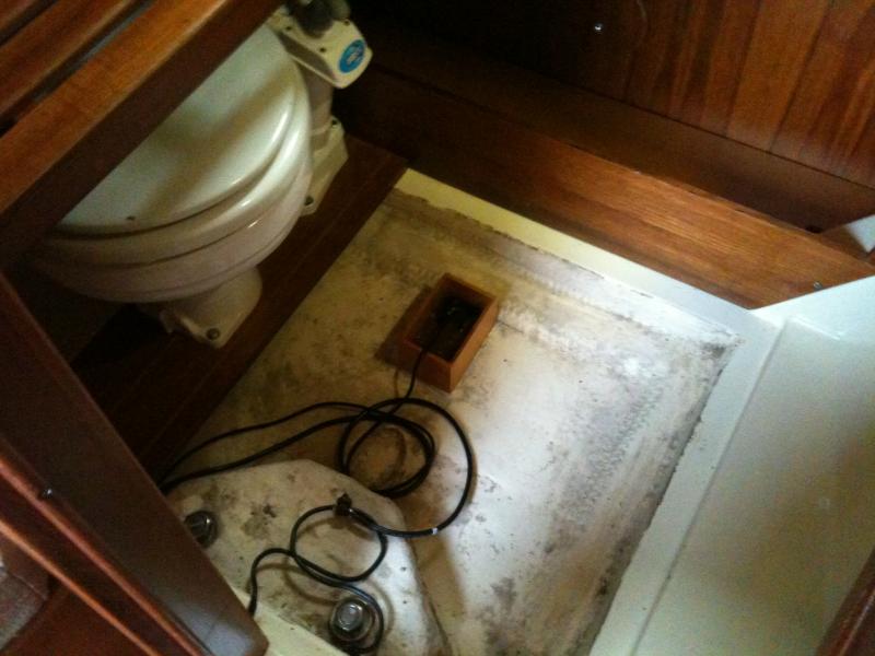

Mount the depth sounder transducer inside
I'm with melinuxo ... why not mount the depth transducer inside he hull? Toilet bowl wax works fine. To make the installation a bit cleaner I built a small, bottomless box out of thin plywood. I then mounted it to the inside of the hull with RTV and filled it with toilet bowl wax. Works great!
