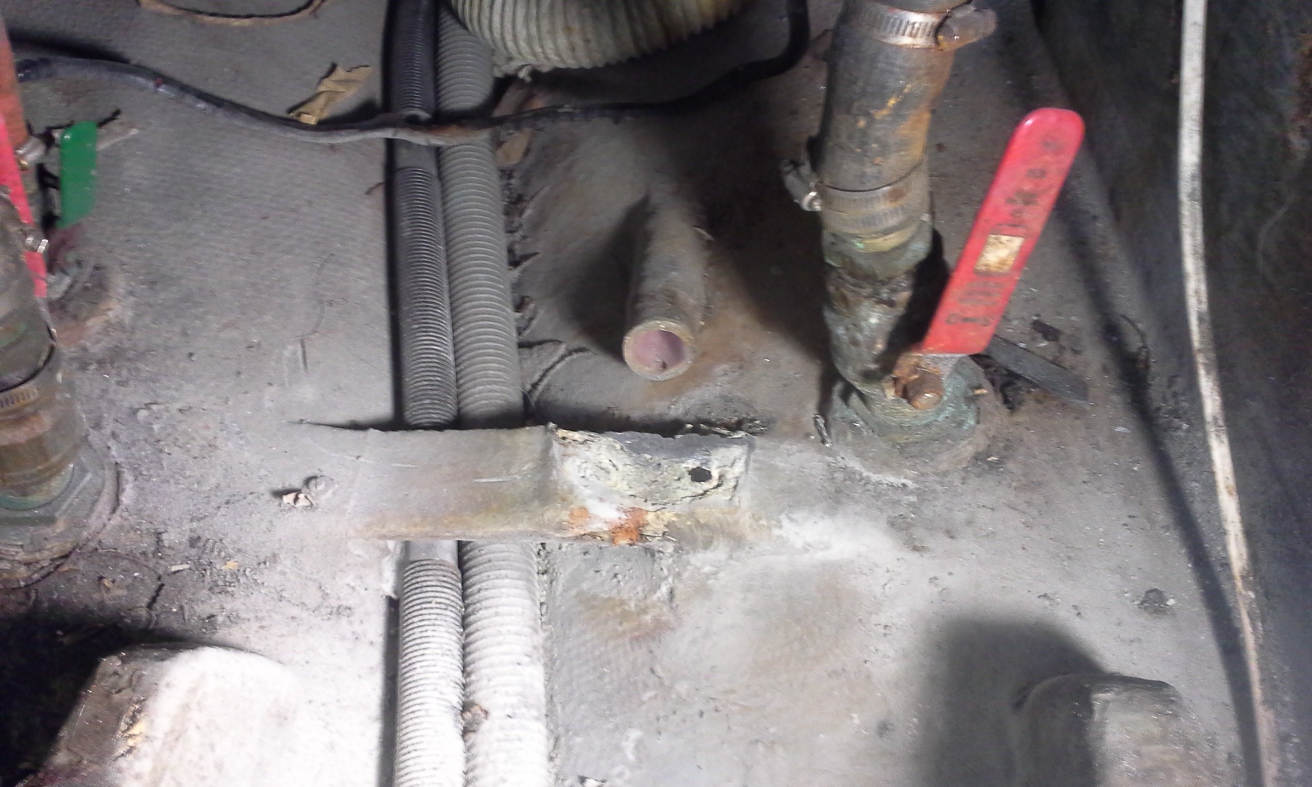

I measured the stern tube on my Ontario 32 with calipers and it was 2.00 inches. At least the part that wasn't covered by the stuffingbox hose... Once I took the hose off, I found that somebody had ground it down to 1.8-1.9 inches. I ordered a 2" stuffingbox, but it's pretty loose. The next size down is 1.75 inches, and I think it's easier (and safer) to build up than cut down.
I don't want to cut it off and put in a 2" pipe since that would really cause a weak spot. If it was a non-critical area, I'd just wrap a few rounds of electrical (PVC) tape on the pipe and call it good.

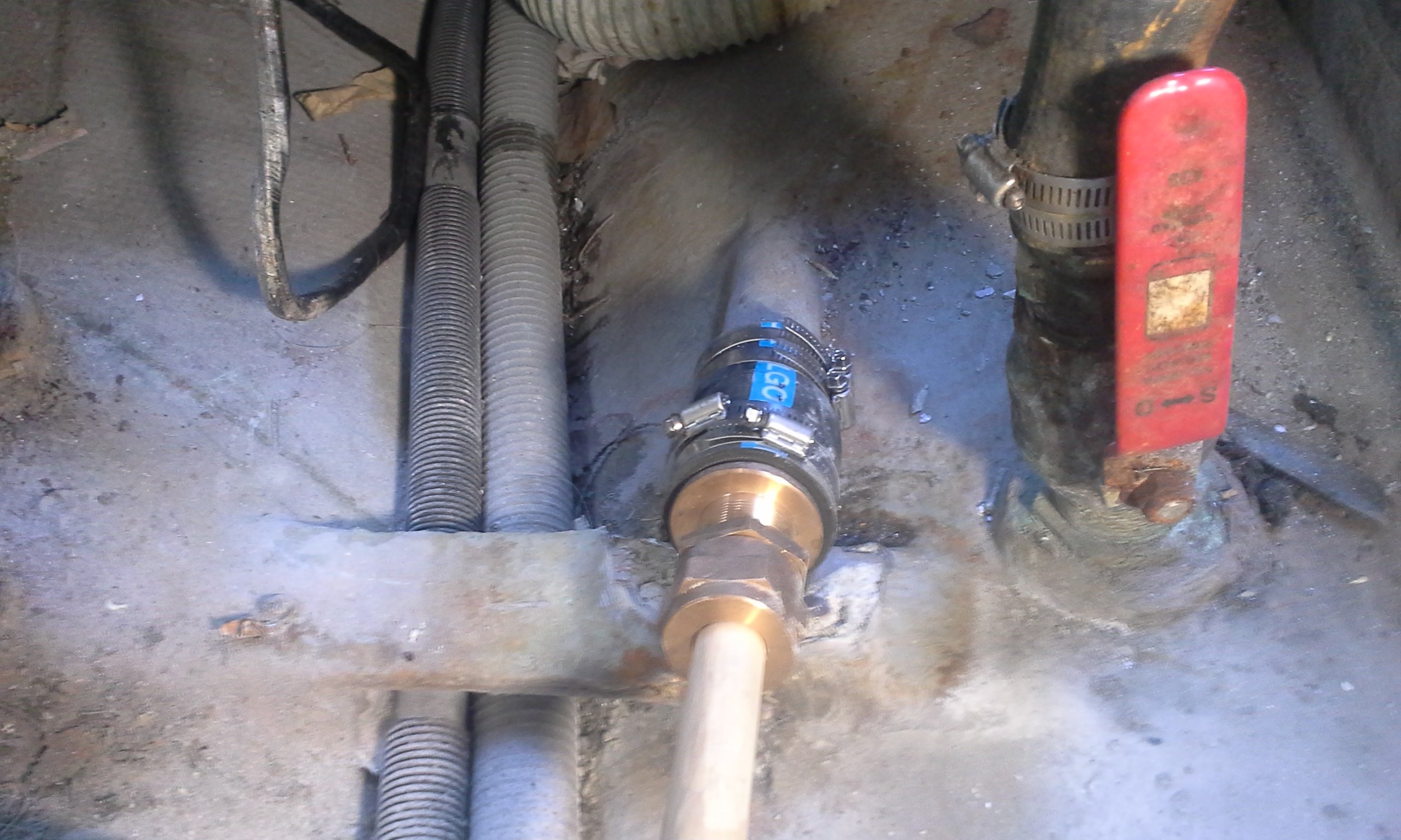

OK, here's some more details showing for instance why I'm not going with a dripless seal. First, I doubt it's "hi-tech stuff" - polyester was "hi-tech" back in 1976. But as you can see, originally the stuffingbox was "fixed" (not floating) and I had to grind away a bunch of material to even get the Buck Algonquin in. How they managed to get the old one in and properly aligned is a mystery: although it does look smaller.
As for epoxy vx polyester: yes, if the shaft log was epoxy I would probably use epoxy for this. But remember: I'm just building up material - I don't need strength per se, nor am I using it as "glue" (as in a stitch-n-glue boat, where epoxy is required)
I took a bunch more measurements (the curse of having accurate calipers!) and most of the shaft is closer to 1.9 than 1.8. I think a bit of material to build up the end will be all I need to get a good seal with the hose.

After adding a thin layer of fibreglass, the tube was about 1.9" all round, so I went ahead and lined up the stuffingbox. We'll see if she's leakproof when she goes back in, but it looks pretty optimistic...
